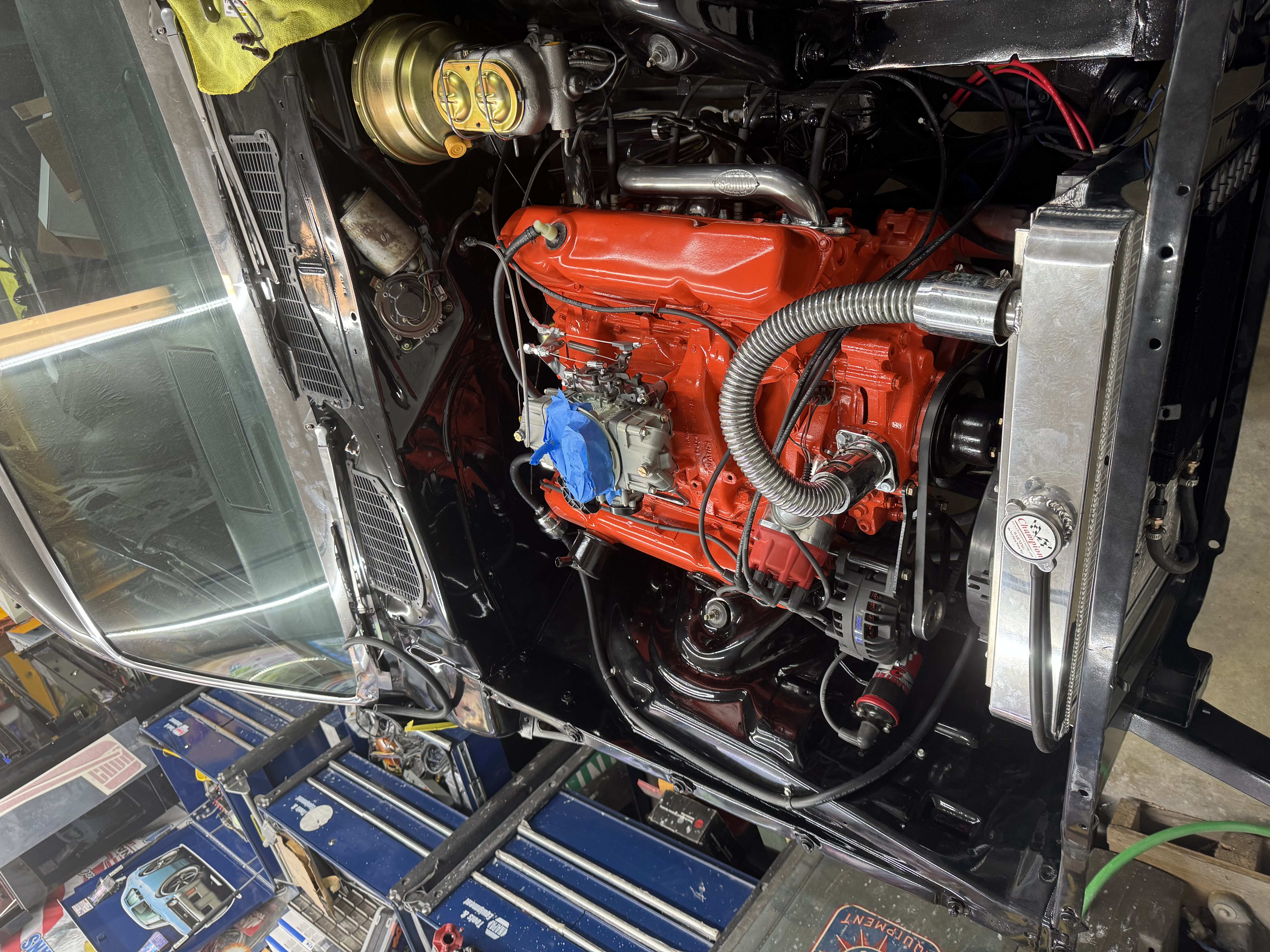

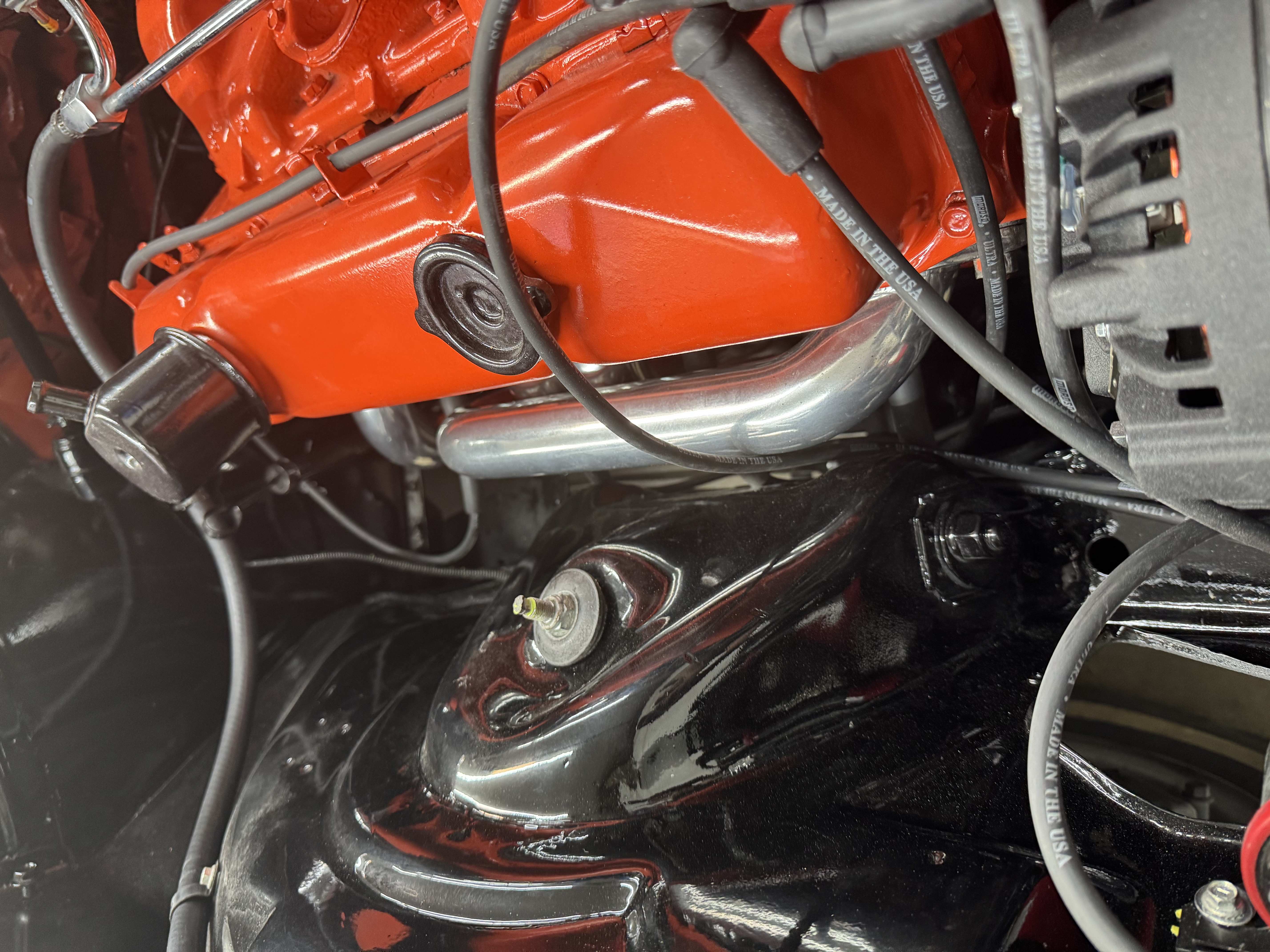

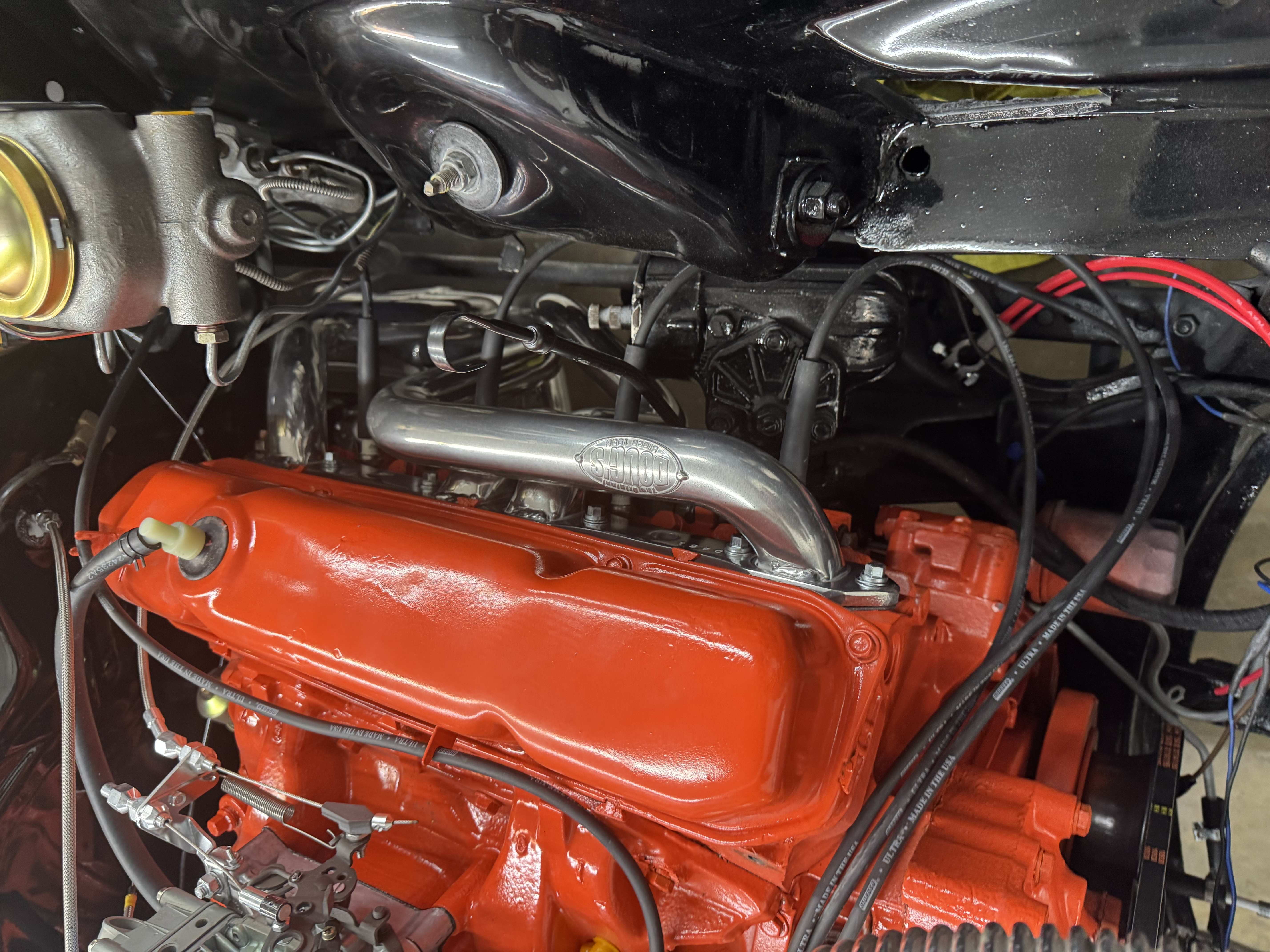

You may want to reconsider how you're routing that fuel line...
Good chance the hood or something is going to pinch that rubber fuel line and cause a leak that's going to spray onto the really hot header pipe.
That's if the pump can actually push the fuel the distance you're asking it to. Looks to me like one massive air lock.
Seriously, you need to correct that set up before something bad happens...
