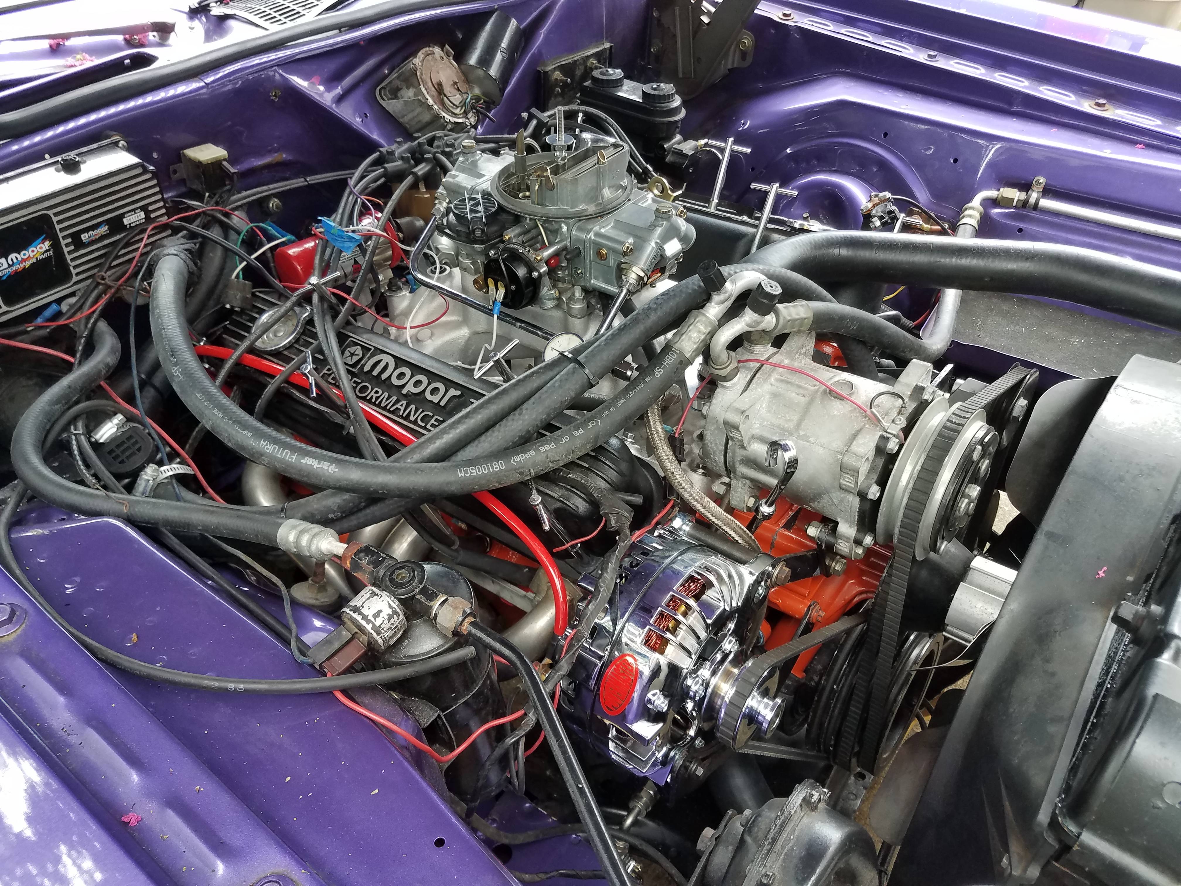

rogue
May 21, 2013
228
56
It was an original AC car. As far as a non-AC car i think you'd want to call classic auto air to see about how it fits and it there are any mods required. It's pretty cold, down to the advertised temp which i can't recall but i measured it when i put the system in. The real limit is the blower fan in the original heater box which isn't the greatest. Overall i'm satisfied. The wiring in the pic is a mess but the engine was recently installed and the wiring wasn't cleaned up yet.
