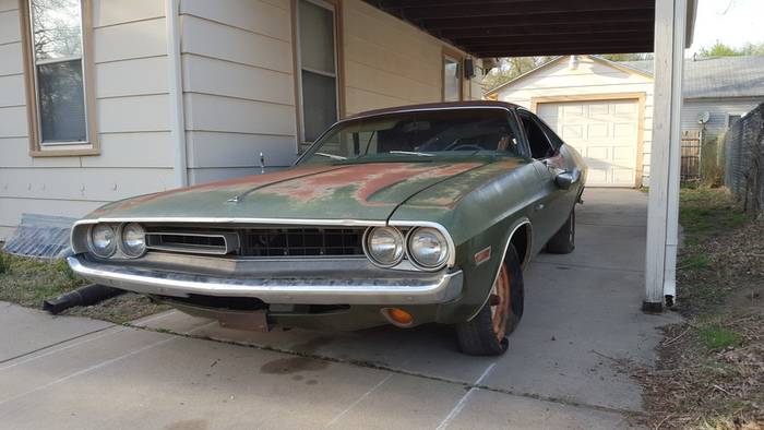

When I arrived, it was basically what I expected. A bunch of older trucks and mid-eighties generic cars. And then I saw it. I mean - it's not any super high-end trim package or anything - but - it was a Challenger nonetheless. And I was lucky enough to buy it for very little.
It will be a long road, and it may have taken me 20 years to get one, but by God I am building my damn dream car. --- and so it begins.
1971 Challenger
318
Automatic - Column Shift
Green on Green on Green
Drum Brakes
40,000 Original miles
All numbers matching
Just about 100% complete car
Never wrecked that I can tell
Rust in floor, a little in quarters and fenders, but no rust (besides surface rust) everywhere else - rockers, subframe, torque boxes, towers, windshield track, etc. all seem to be pretty good.

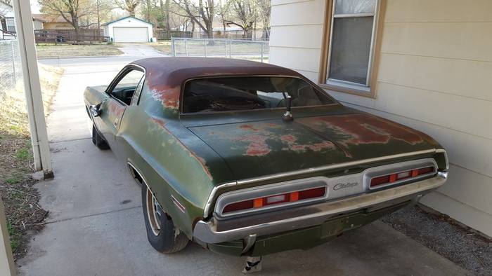

The day I got it:
(After 20+ years of animals got it)

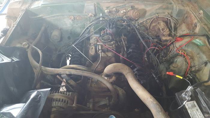

Back.
Engine.
Free friend that came with the car (probably the cause of most of my wiring being gone).

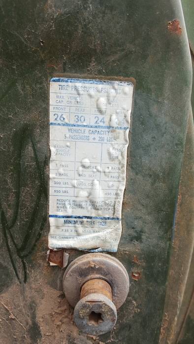

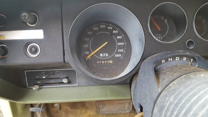

Mileage - kinda makes me wonder why it was parked in the first place.
Pulled off the air cleaner and was a little taken back by how clean most of the metal inside of the filter was:

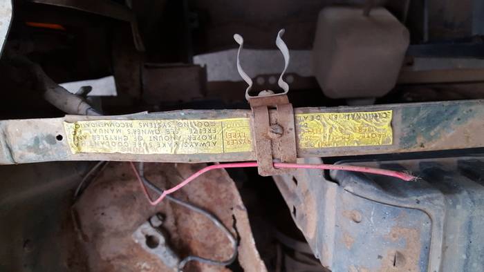

Then I started noticing some factory labels - which was pretty neat that they survived all these years.
h0wb0y
Aug 31, 2016
20
11

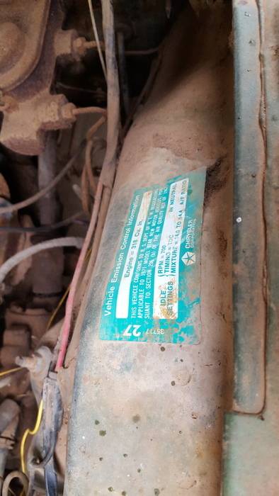

And this one:
And this one:
So I looked - and, not that it means much for a 318 auto on the column car - but it was numbers matching.
I pulled a wrench out and the engine was not seized - so I was pretty happy at that point. I was just going to go get a new battery, plop it in, and cross the starter relay to see if it fired - but, I have been down that happy-high road before that usually just ends in immediate disappointment and many more trips to the parts store --- so I went ahead and picked up new battery cables, starter relay, starter (for a 93 Dodge Dakota), coil, points, condenser, cap, rotor, plug wires, plugs, oil filter, fuel filter, air filter, some fuel line, starter fluid, Seafoam, carb cleaner, degreaser, PB Blaster, so on and so forth. I was determined to get this thing fired up off of one trip to the store.
Well, going piece by piece, I was able to get it fired up! BUT - it would die immediately. I checked and checked everything I could think of. Fuel pump was pumping fuel when line was disconnected from carb. Carb jets were squirting fuel. I had compression on all cylinders. I had TDC - and the rotor was pointing right at it. The firing order was correct and I knew I was not 180 degrees off. I had power to the coil and over the coil. I had spark in the cap. I had spark at the plugs. Spark plug gaps were good. Points gap was good. My wiring was all new - and only what I needed to start and run the motor for a quick time (I was not even about to go buy a harness, voltage regulator, ballast resister, etc. just to get this thing to run). Still - it would just fire up immediately - and then immediately die.
Everyone I talked to kept telling me that I had one of those things wrong - because, if I had all of those things rights, it would fire and run - period --- which I knew --- and that's why I had it that way! I must have checked everything about 30 times. When people were telling me that I was wrong - I started inviting them over to see if they could get it started and running. Nobody could. I even re-rebuilt the carburetor in front of someone that swore up and down that the issue was the carb. Nope. Everyone just would stand around with a red face and say - well - you definitely have everything right --- not really sure why it won't run (and then run away). I mean - these guys are usually the BEST type of people to have in this situation - several farmers, two mechanic shop owners, several professional mechanic friends, and several car guy friends (and myself) could not figure this thing out.
After basically getting nowhere for a good month, I left it sit a month while I moved and some other things. I was not really avoiding it - but I was.
About a week ago, a random memory popped into my head as I was falling asleep. When working on an old 41 Chevy Panel motor that had been sitting in the field a long time, I found that mud dabber nests inside of the cylinders (on top of the piston and below the heads) were stopping the engine from turning - and it acted like it was completely seized up. I chuckled to myself as I dozed off.
The next morning, I was kinda thinking about that old Chevy Panel and it hit me like a ton of bricks. The one thing I had NEVER thought to check was the exhaust. I went outside, pulled the manifolds loose, connected the battery and bridged the starter relay. BOOM. That motor fired right up and ran like a top for about 5 seconds (before I killed it for fear of wrecking my exhaust valves from cooling down to fast with no manifolds on). Mud dabber nests in the exhaust manifolds the whole time!
Important lesson re-learned: All an engine needs is proper air, spark, and fuel to fire. Correct. HOWEVER, if it can inhale, it must be able to exhale - because otherwise it can't inhale again!
I made sure to let all those guys that tried to help know that it was the exhaust the whole time so they could share in my embarrassment. I am sure glad I was the one that ended up figuring it out though!

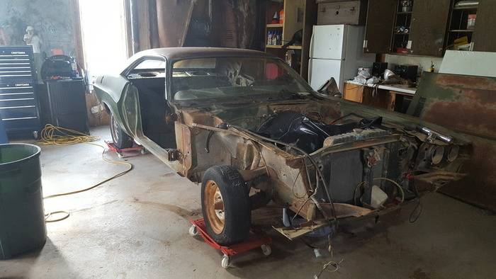

Now I have both fenders, doors, hood, and most of the front end off. Got the windshield trim off with an old body mess index measurement tool without damaging any of it - and the windshield out. Not sure why that was laying around - but it was! (I guess fender and windshield are still in at the time of this picture)

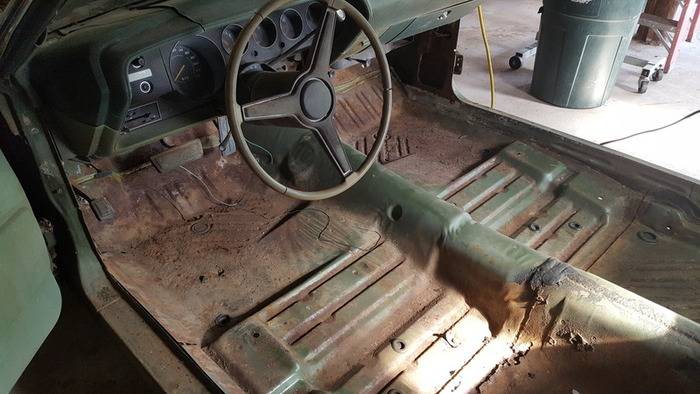

Most of the interior is out:
h0wb0y
Aug 31, 2016
20
11

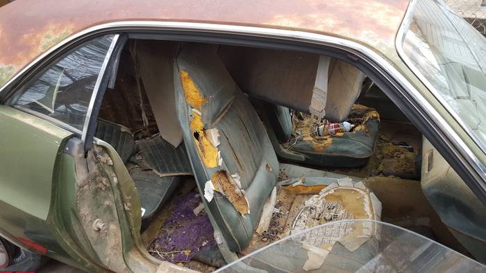

Here's the back seat area:
I now have the dash out. I was working on getting the column out tonight, but I am not sure if it matters which way I tap from to get the roll pin in the steering shaft coupler out of the gearbox. (Asked in another thread - but will hopefully figure it out tomorrow)
