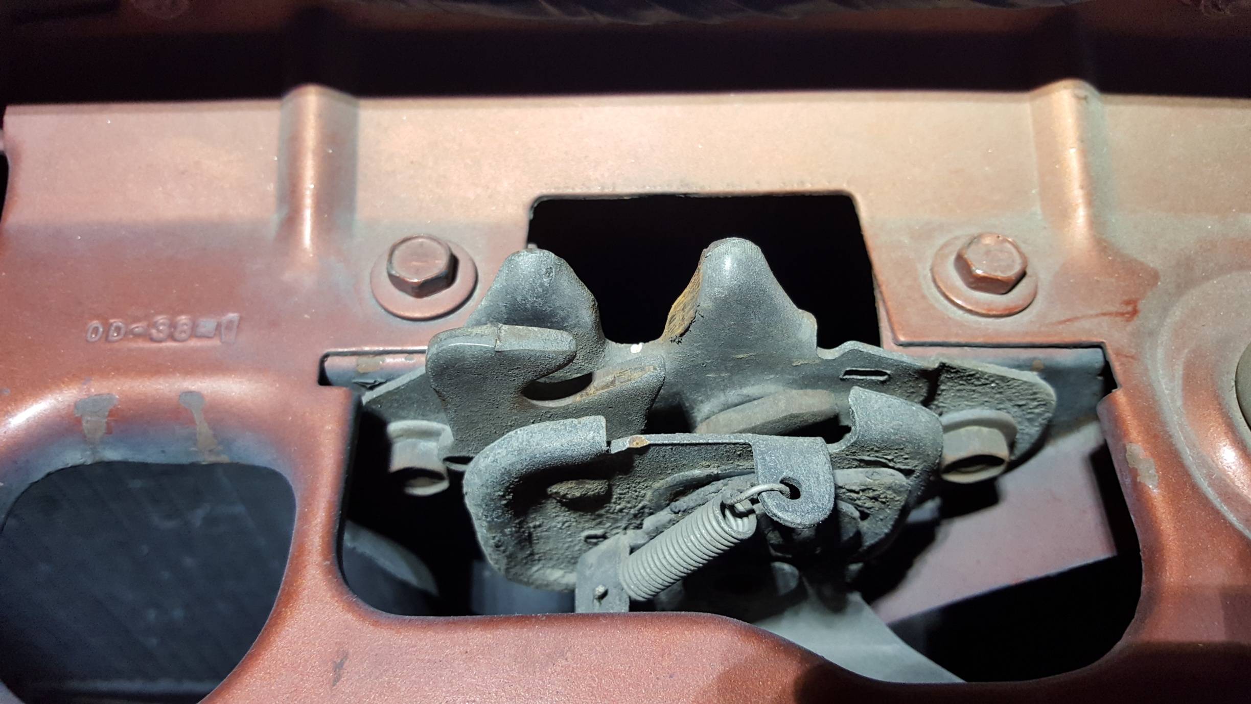

My car was a roller that was thrown together when i bought it so trying to track down some stuff, does anyone know what size nuts and thread pitch are used to hold the hood latch bracket that bolts to the front of the top radiator support?

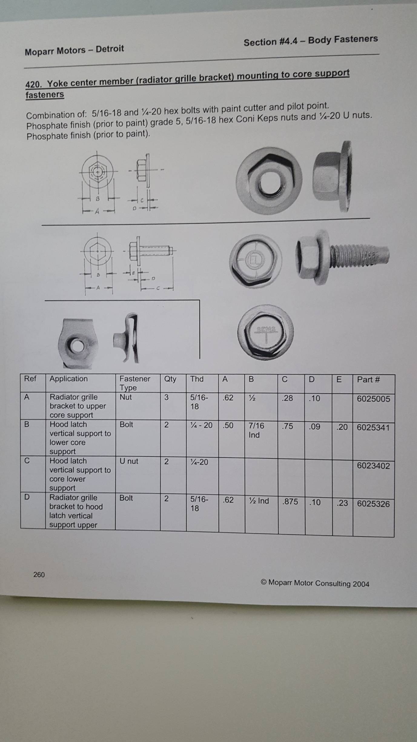

The top fasteners are 1/4-20 x .75 long screws, threaded into U-nuts. The bottom fasteners are 5/16-18 x .875 long screws. See pictures below.
