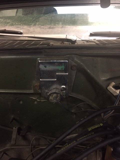

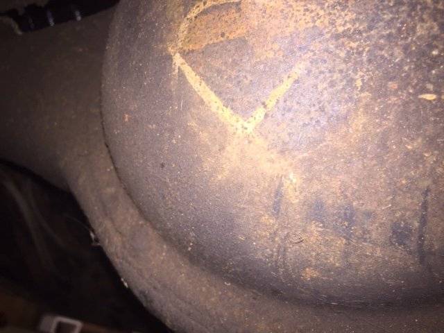

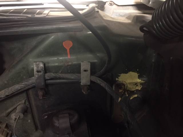

Wondering if the paint markings on the firewall and rearend
in attached photos are factory? Not being familiar with Mopar, is that voltage regulator original?? Not sure why it would have been changed on such a low mileage car. Also, being an untrained "shadetree mechanic" , not sure which way to turn with bad skip in engine. The car has been off the road since 1988, not sure how often it had been started since. When I got it home, replaced plugs, new wires ,cap, rotor, points, condenser, bypassed gas tank to run fresh fuel. Checked compression (145-150 every cylinder), timing at idle at TDC. New carb kit, though carb was not gummed up or a mess. Car will start an idle fine, but very definite bad skip under acceleration or higher RPM. What should I do next? Thx .
