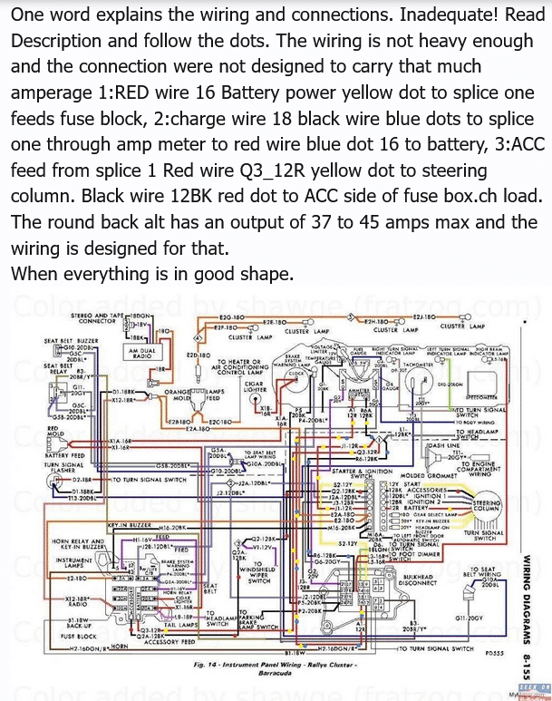

parking lights and dash lights [rally dash] come on with ignition on. do not remember this. replaced oem dash with rally dash.

Off hand it seems as if the you have some wires crossed. Your probably thinking " No $h*t!. Pay no attention to the text above the diagram.

Just a quick look I'm thinking check the steering column connector. See if there in the correct place. I'm just shot gunning it. I have no Idea what you did. The Ign 1 wire and the acc become hot when the sw is in the run position. The orange wire is the instrument lights. It might be feeding back through there.
