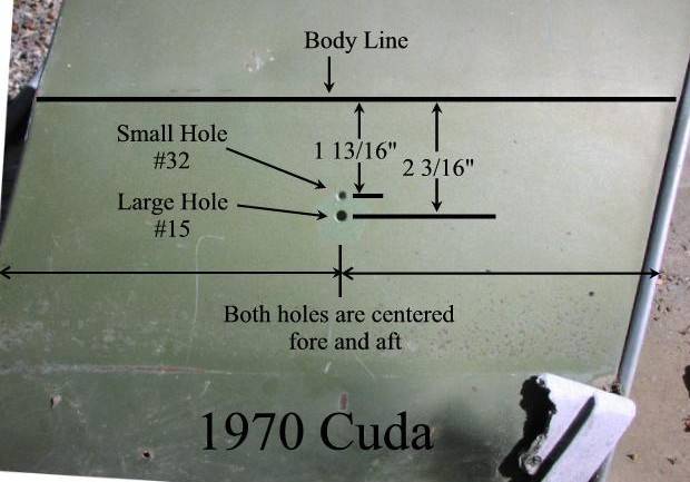

Looking for the measurements for the Pentastar location on the front fender on a "71 Cuda".

Is this what your after?
