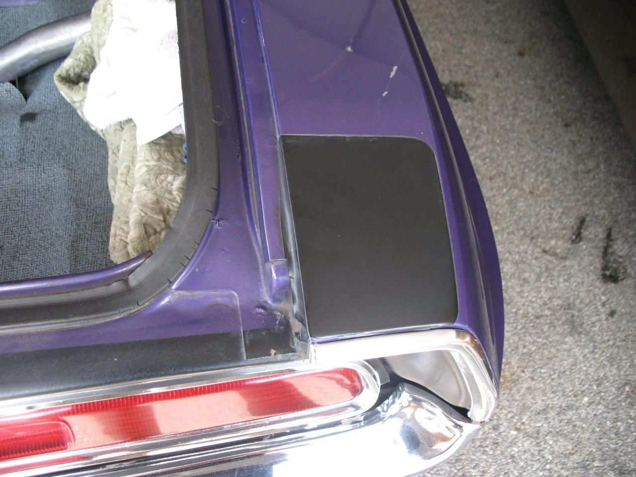

are there any instructions to the placement of the body decals for a TA Challenger im close to that point and was wondering is there any placement instructions for the car especially the side 340 six pack on the fender and the trunk spoiler challenger TA

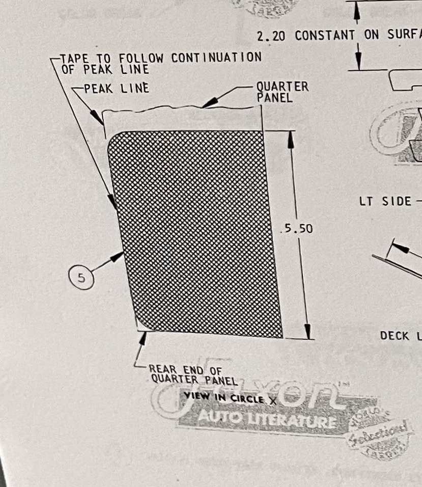

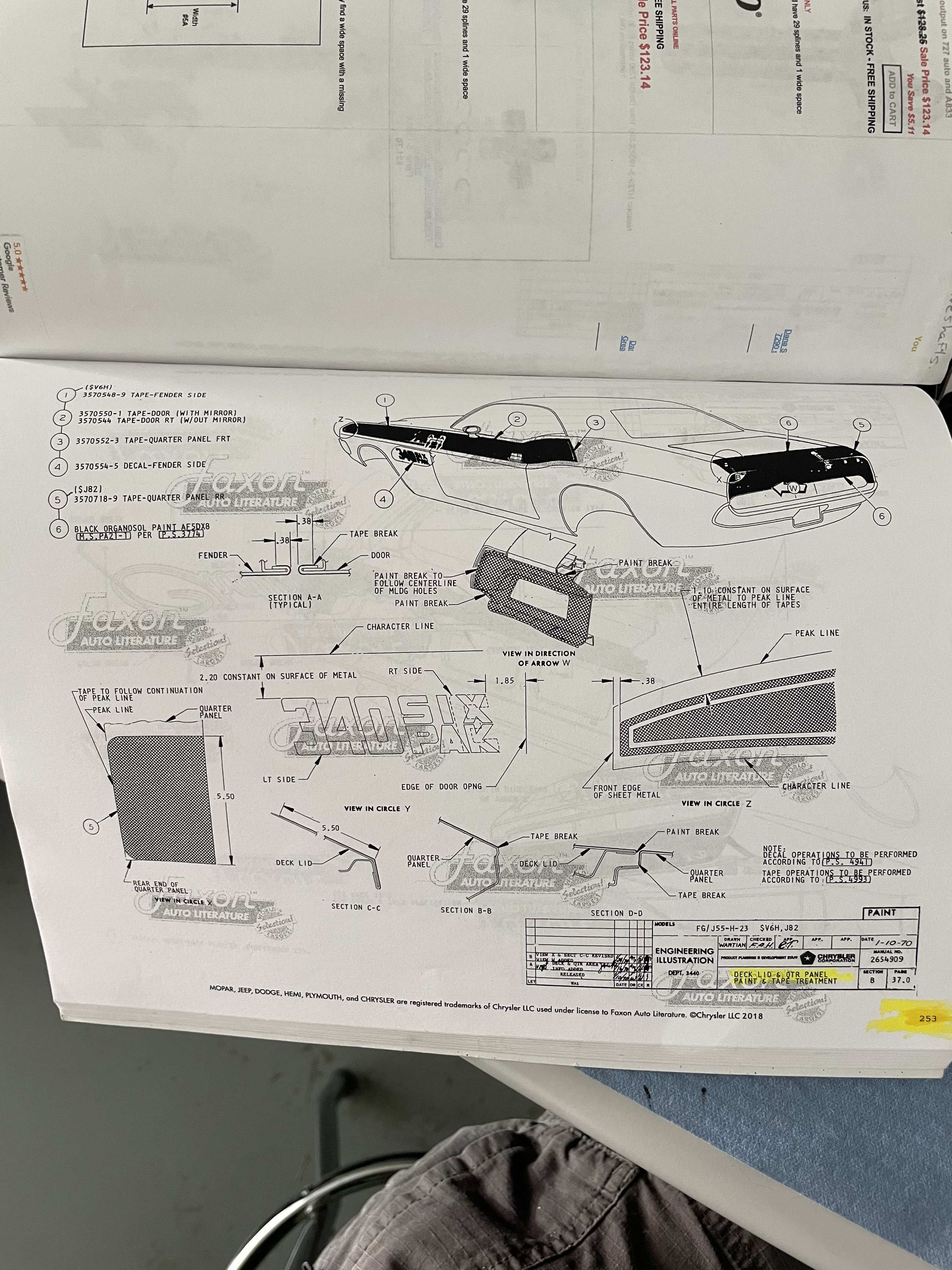

This may help.

thanks I think it will any pictures of the spoiler decal and side fender and under the spoiler endsbjust for a good visual

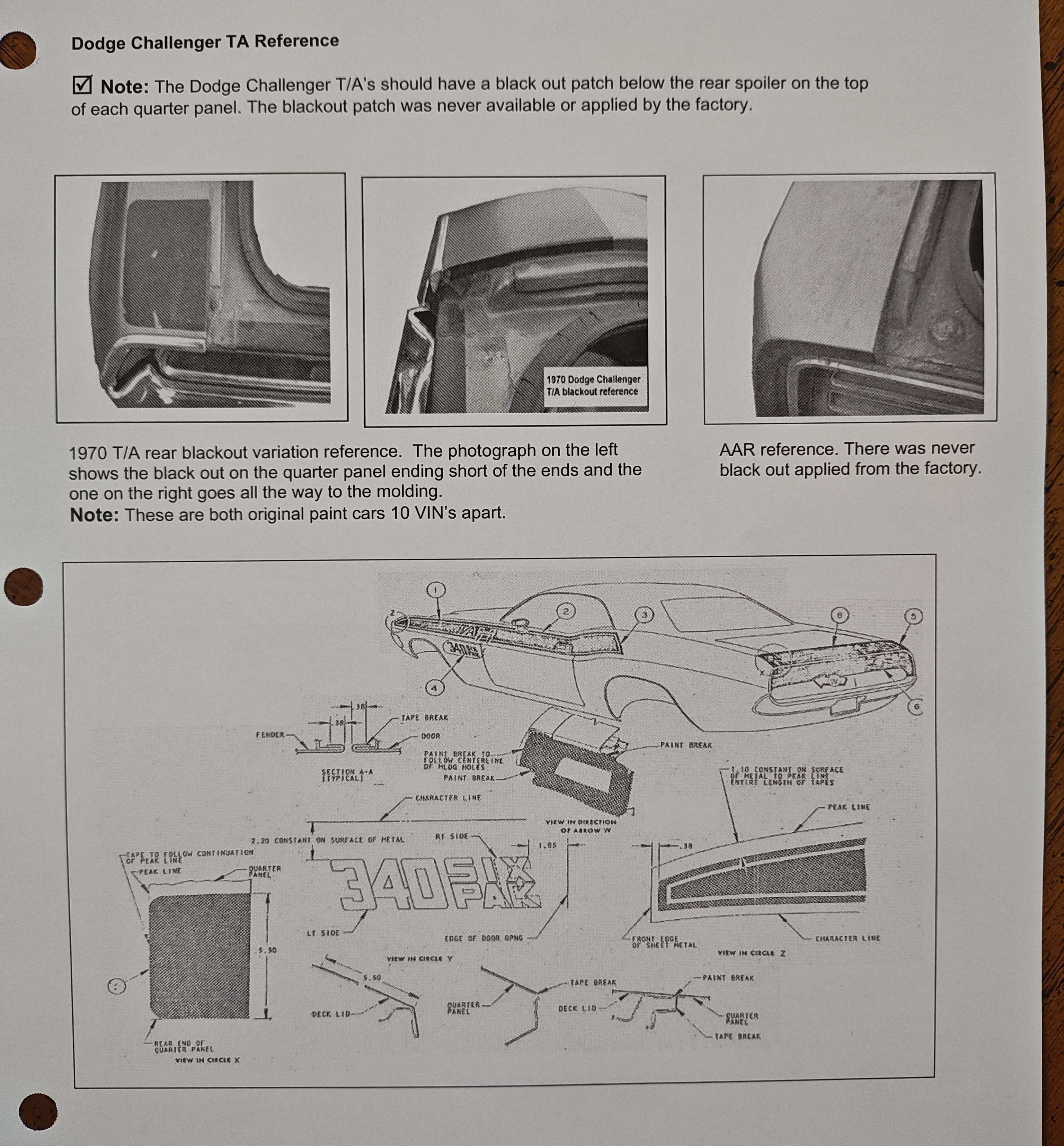

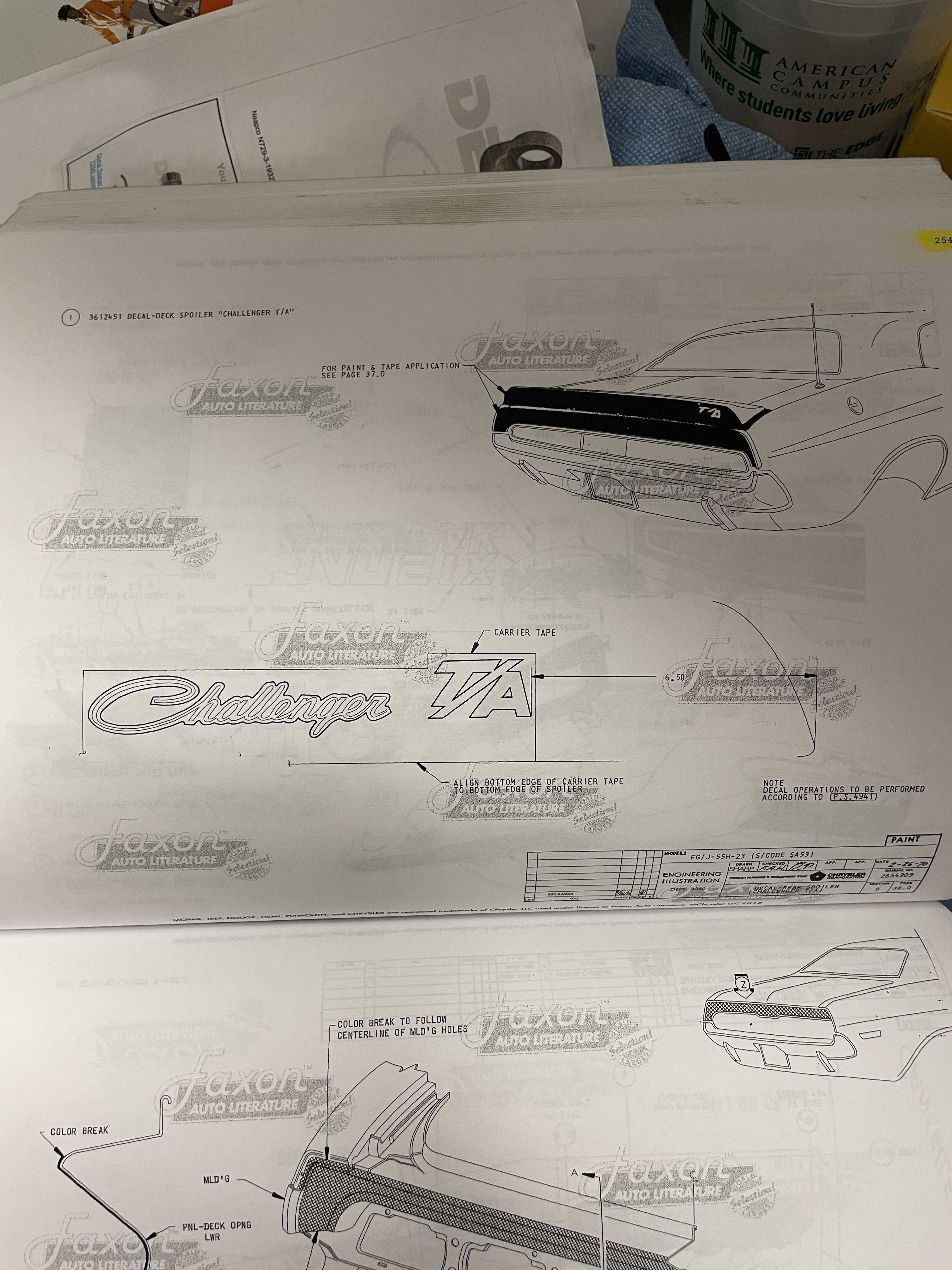

OK thanks im just not sure if the decal under the spoiler goes right to the edge of the quarter panel

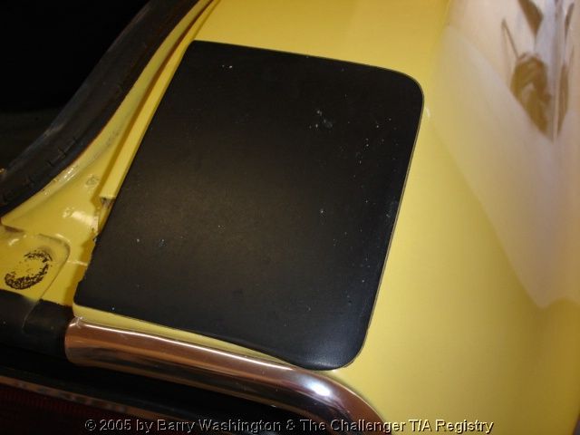

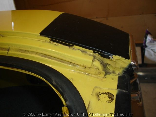

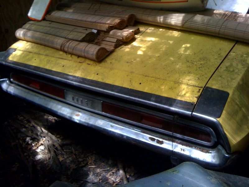

Line it up with the edge of the quarter panel and the edge of the quarter molding. The excess rolls in towards the trunk.
floyd
Mar 18, 2012
374
244
Here are some survivor pics for reference

More confirmation on quarter decals under the spoiler and the side stripes.
KennyCuda
Aug 3, 2020
404
54
Flyod and moparcarguy thanks so much for those pictures exactly what I needed were are doing the stripes on Saturday
