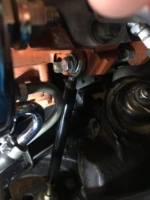

I usually build a strap from the ear on the block to the crossbolt for the mount using 1/8 .125 thick 1" wide material , that stops mount failure

Agree with Chryco. I use the factory mounts with turnbuckle type strap from Schumacher. Works fine. Use a line of thread locker.
