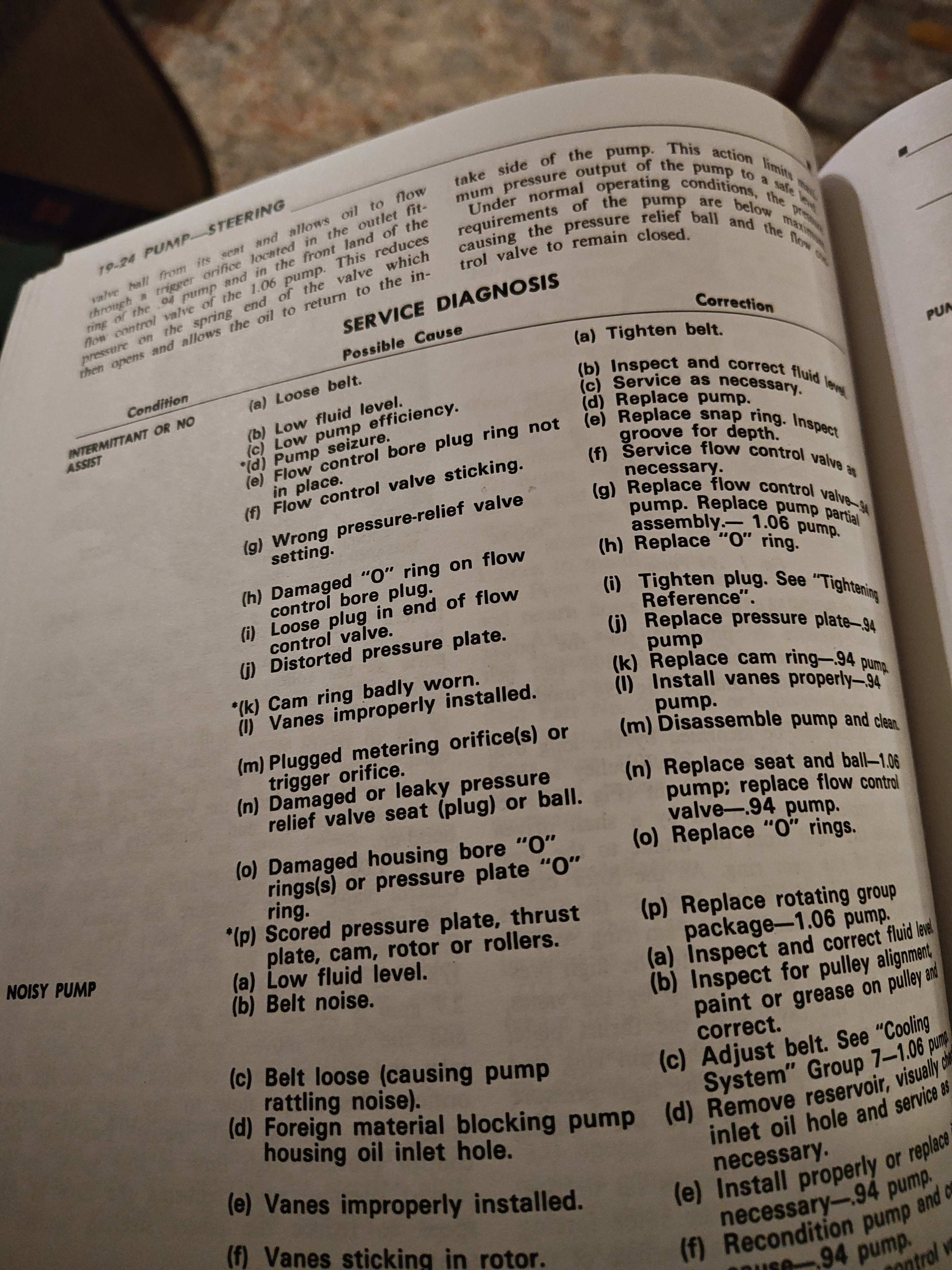

Here's the trouble shooting guide for 71 for no power assist.

Thanks again. after turning wheel back and forth numerous times, she freed up!!!! No more knuckle busting
