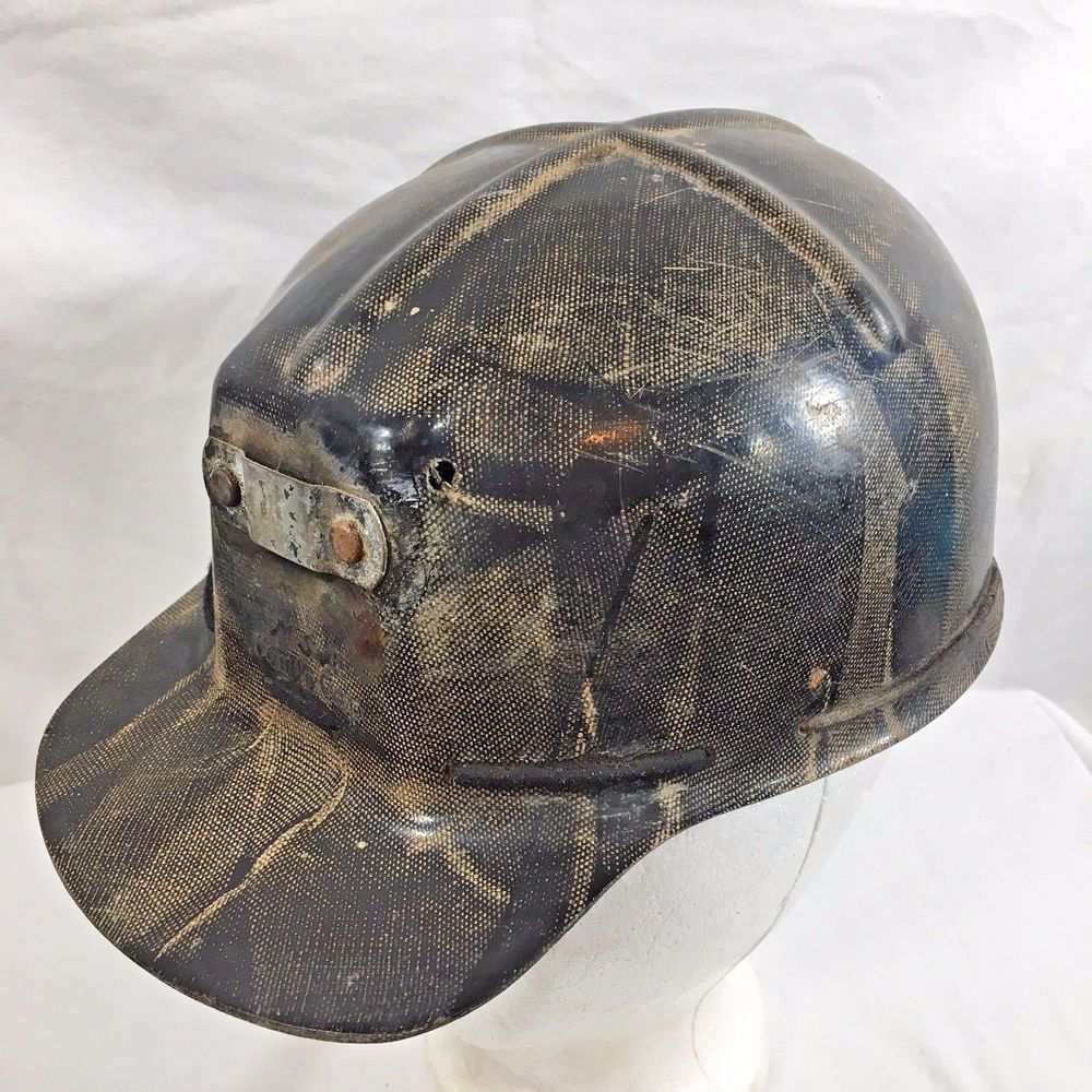

Funny thing about locks. There only purpose is to keep honest people honest and slow down someone for about 10-20 seconds. When I was working pipe line and was working with the mechanic. I was changing an idler pulley on a newer Dodge RAM. Today's high 12° Just so you know. Before I got done The Boss ask are you done yet? He was razzing me. Right after that I hear SON OF A *****!. He locked his keys in the truck. The thing was it was electric locks but we got it.
At a previous safety meeting he was on the guys about locking the keys in the trucks. The problem the mechanic and I would have to go to the place where they were staying and unlock the trucks just so they could get to the site. We got pretty good at it. He would just sit in the truck and say you'll be back before I even get out go do it. He was about 6' 6" 300lb Just a big WV coal miner, great guy.
So you ask how big is he! Nobody was not going to tell him his miners hard hat not complainant for a construction job. Hard hats are only good for 5 years to be complainant
Not even the owner of the company..
