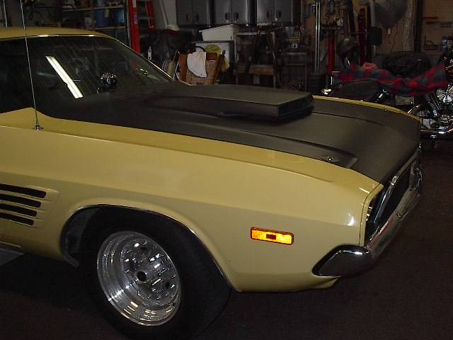

I used a plasma cutter to notch the front bumper bracket holes (3 each side on the 73) to move the front bumper in of my 73 challenger and eliminate the front bumper filler. On the rear bumper, I cut the rear bumper brackets with the plasma cutter and welded them back in such a way as to move the bumper closer to the body. I also eliminated the rear bumper filler. It was a lot of work but it looks a lot better. If you change the brackets to the earlier year car you may have to change the bumpers as well because the bumper mount holes may be different. On the front bumper I removed the rubber bumpers guards and put bumper bolts in the holes. You can see in the picture that the front and rear bumpers sit close to the body front and rear. I'm working now on eliminating the rear bumper guards.

looks good modfly, i wish i would have taken the time to do it........

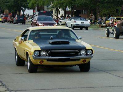

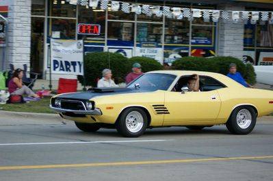

I used '70/71 brackets on the front. it allowed me to remove the 20lb brace in the front bumper. I reused the bumper, just put an exttra blot in the unused hole.

Mr340: Car looks very nice. Purists will be disappointed, but not me. I like the black around the head lights! Questions: What is black behind the bumper at the fenders, paint? What did you do with the strobe stripes, from the driving photo I can't tell?

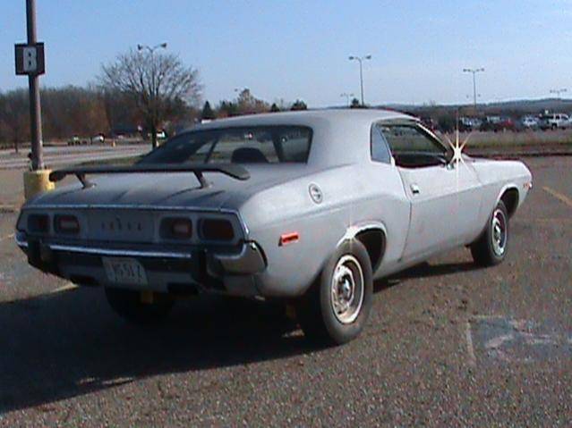

I recently took the legbreakers off of my 73. The front looks good. I just polished up the abrasions where they were and plugged the holes with new identical chrome bumper bolts.
The rear is still frustrating me. Apparently the bumper on the 73-74 is different than 70-72. I bought some nice small chrome bumperettes and they do not swap out. The mounting holes are not even close. Shoulda checked before I bought them, but it really didnt occur to me that they would be different. So now I have to either replace the whole rear bumper - which is a shame, bc mine is in excellent shape - or put the legbreakers back on the rear. If I leave them off, the rear valance panel looks goofy due to the large empty holes for the bottom of the bumper extensions.
I am thinking I am gonna just take off the rubber pads and fabricate something nice to mount on the original chrome mounts. And I could not care less about the "purists". Sorry. Its my car.

Awnsers:The black behind the bumper @ the fender is paint. originally there was a black plastic filler there. the car had been repainted and when I remove the filler the paint there did not match the rest of the fender other wise I would have left it body color.
the strob was this way when i got the car aalthough I have the decal I have never put it on.

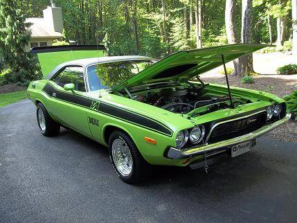

Pagilman: I have a light weight hood, no inner bracing. it weighs about 27 lb. The steel R/t hood that was on it weighed 78 lbs.

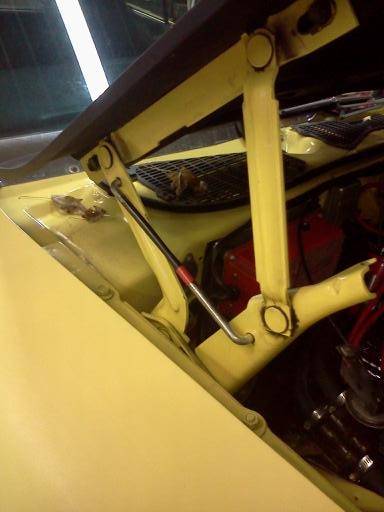

I found anothe way to hold the hood open. If your hinges have the holes in them, you will need to bend a piece of 3/8" rod, I theink 8 3/4" btw cneters...I'll take some pics tonite. I found this idea on cuda-challenger forum.

here's the pieces to hold the hood up. you two, one for each hinge.

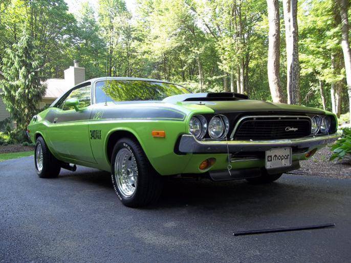

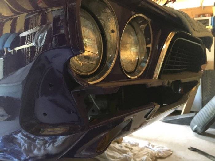

Updating this thread for those '73 Challengers that want the front bumper pulled in: So from what I've gathered here from reading several years of threads.... my '73 front bumper will bolt on to any '70-'72 front brackets ... which will then line up correctly with the holes inside the 73 frame wheel well just fine ... but I will need some chrome bolts to fill in the remaining holes in the 73 front bumper.. correct..? Did I get that right..? (Otherwise, I could drill new holes in your 73 brackets as a previous thread said... but I'd rather just buy the $163 brackets .. since I don't see the square block hole a previous poster mentioned ... looks like AMD from Tamraz on Ebay has them). Doing that... I no longer need the 20lb front bumper brace... or the front panel fender bumper filler trim parts.. (see pic attached)... In short, if I want my 73 front bumper closer to the body.. just buy 70-72 brackets...? That's it.. easy..nothing else to do..? Just hoping for some confirmation on that (oddly enough I'm fine with the 73 rear bumper being the way it is.. looks like rocket boosters!)
