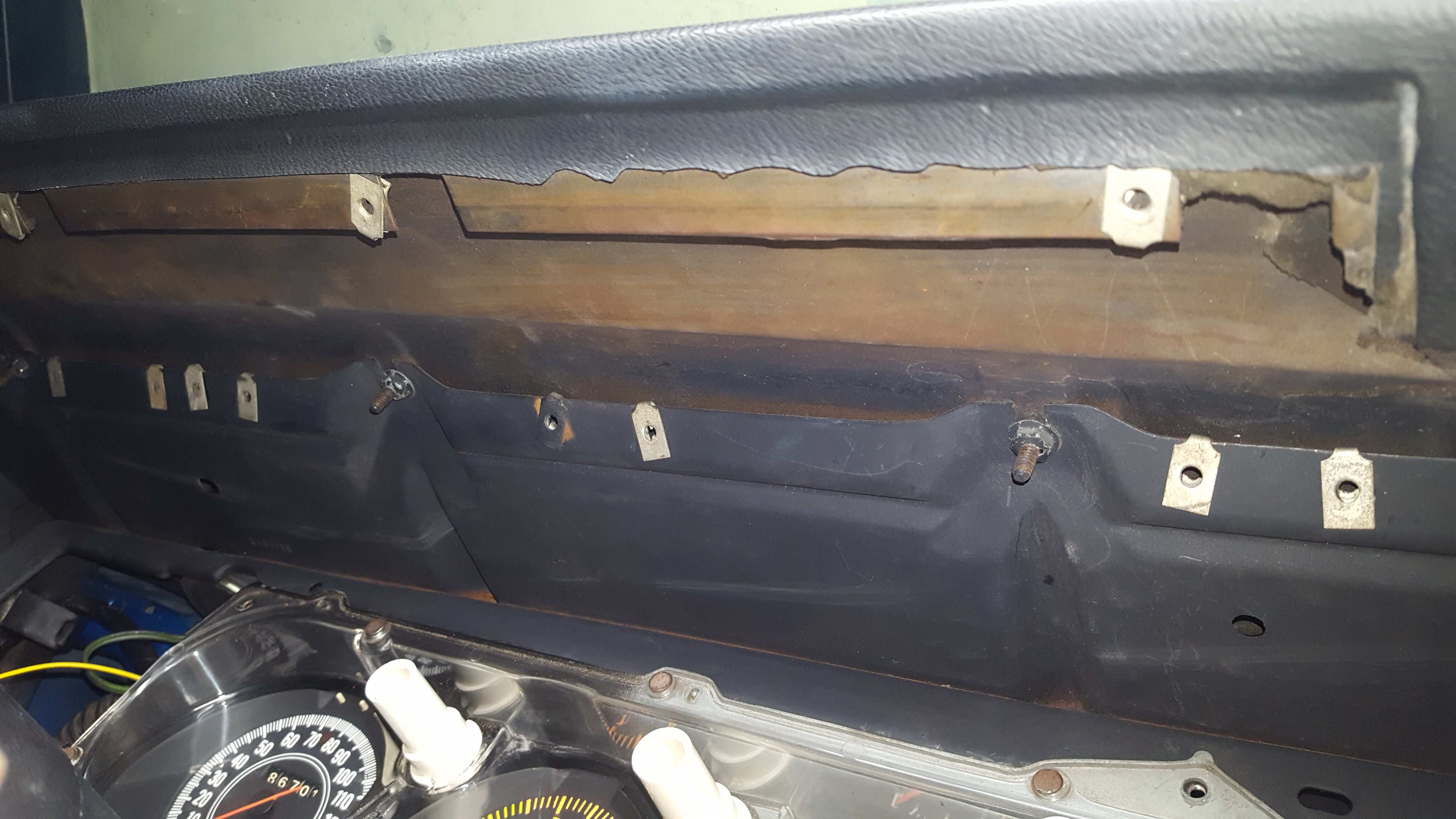

Hi, this may be a stupid question, But I need help installing the Ralleye dash light bar, I can’t seem to figure out how it attaches to the front of the dash pad, I don’t see any screw holes in the pad or if I’m even doing it correctly, any help would be appreciated

New dash pad? Sometimes they don't trim away the foam where the screws holes are located.

Yep, New dash pad, thanks for that, I would never had thought of that

This help.
