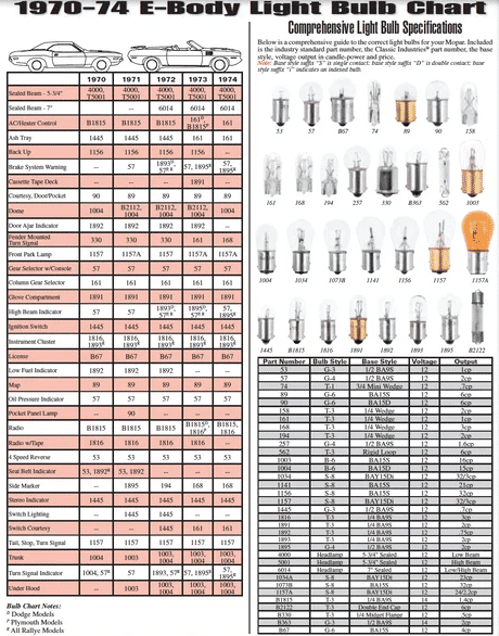

Mar 30, 2024 #2 Challenger RTA Well-Known Member Joined Oct 28, 2018 Messages 3,350 Reaction score 1,777 Location PA Flood city This should help.
Mar 30, 2024 #3 K KennyCuda Well-Known Member Joined Aug 3, 2020 Messages 388 Reaction score 47 Thanks for the instrument cluster it says 1816 and 1893R is the R mean its a red bulb. I dont see a bulbs for the light bar
