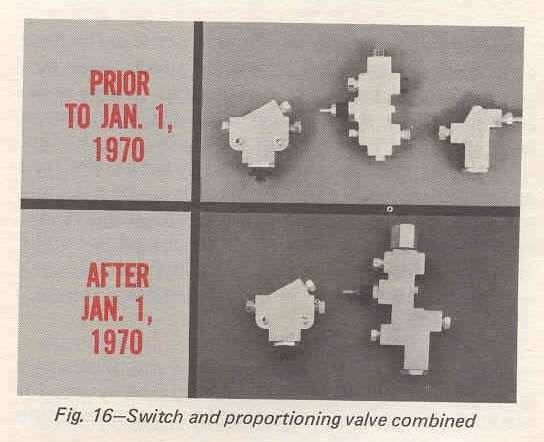

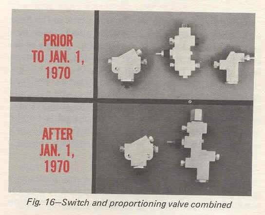

I parted a 70 318 Challenger with manual drums some years ago. If I recall correctly it had the same Weatherhead unit with warning switch, just as what you have pictured. There's not much to it, take a look at this article from musclecarresearch.com
Article-
1967 - 1975 Mopar Brake Tube Tee Autopsy | Muscle Car Research LLC
Parts-
Mopar Parts | Muscle Car Research LLC
The ones with the brake switch and proportioning valve are for cars with power discs, these had the running changes to them in the 1970 model year as pictured in this attachment. The later one was made by Kelsey-Hayes (KH).
So it would seem when they added the discs to your car they also added the proportioning valve at the rear to adjust front / rear braking bias. From what I understand, commonly done & nothing really wrong with it.
There were no manual e-body disc setups from the factory in 70 so I'm curious what master cylinder you had rebuilt - was it the original manual drum brake one?
