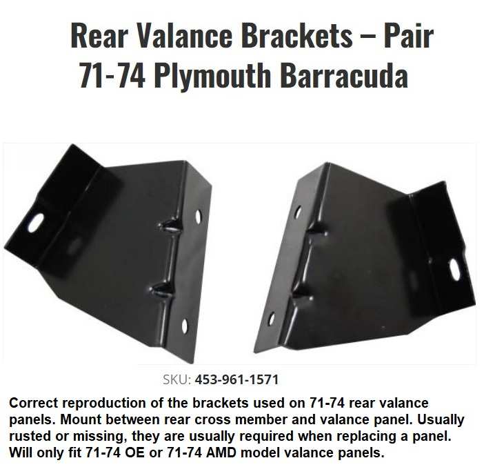

The 1970 Barracuda diagram may help but download your 1972 service manual to be sure.
