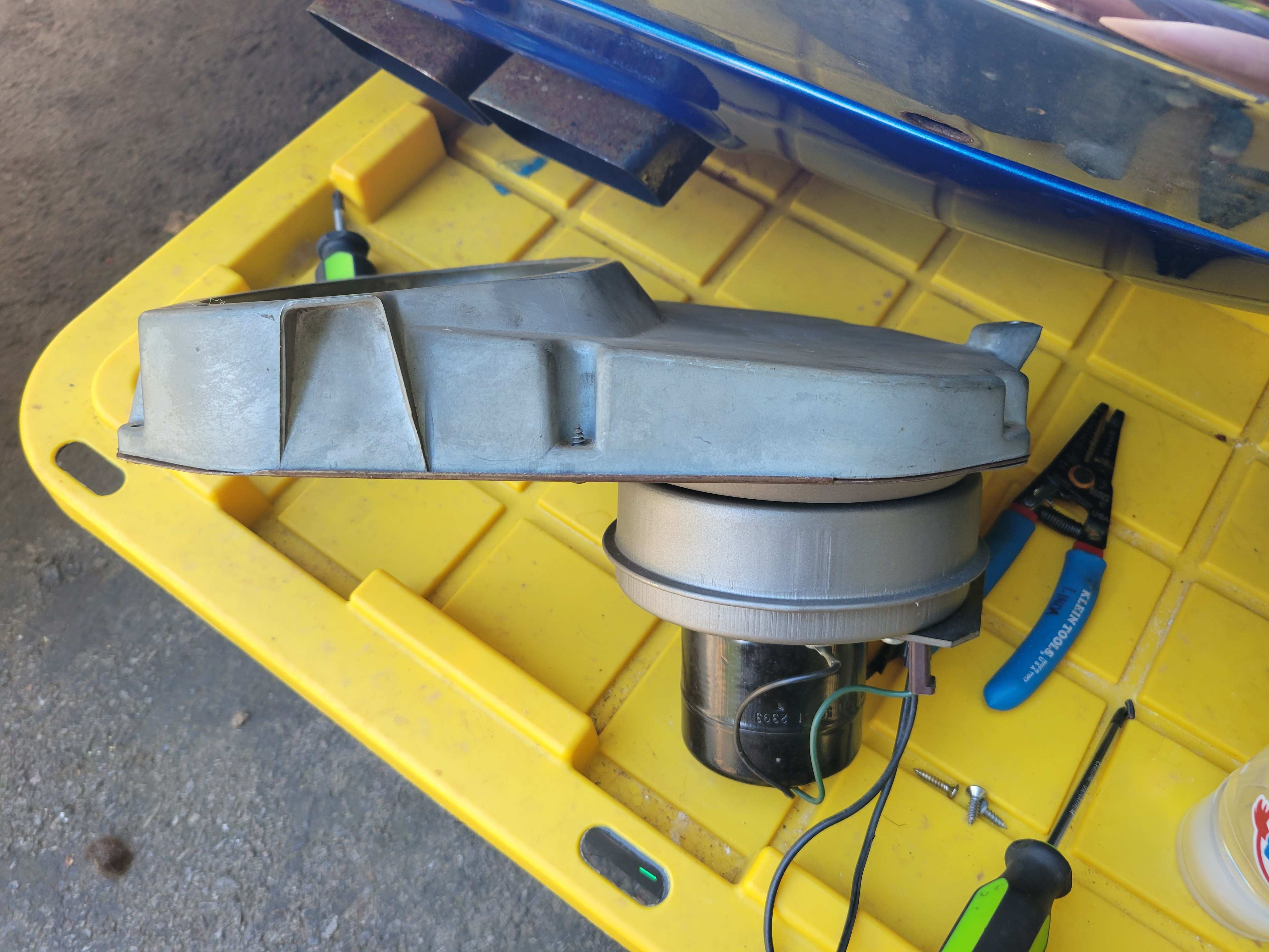

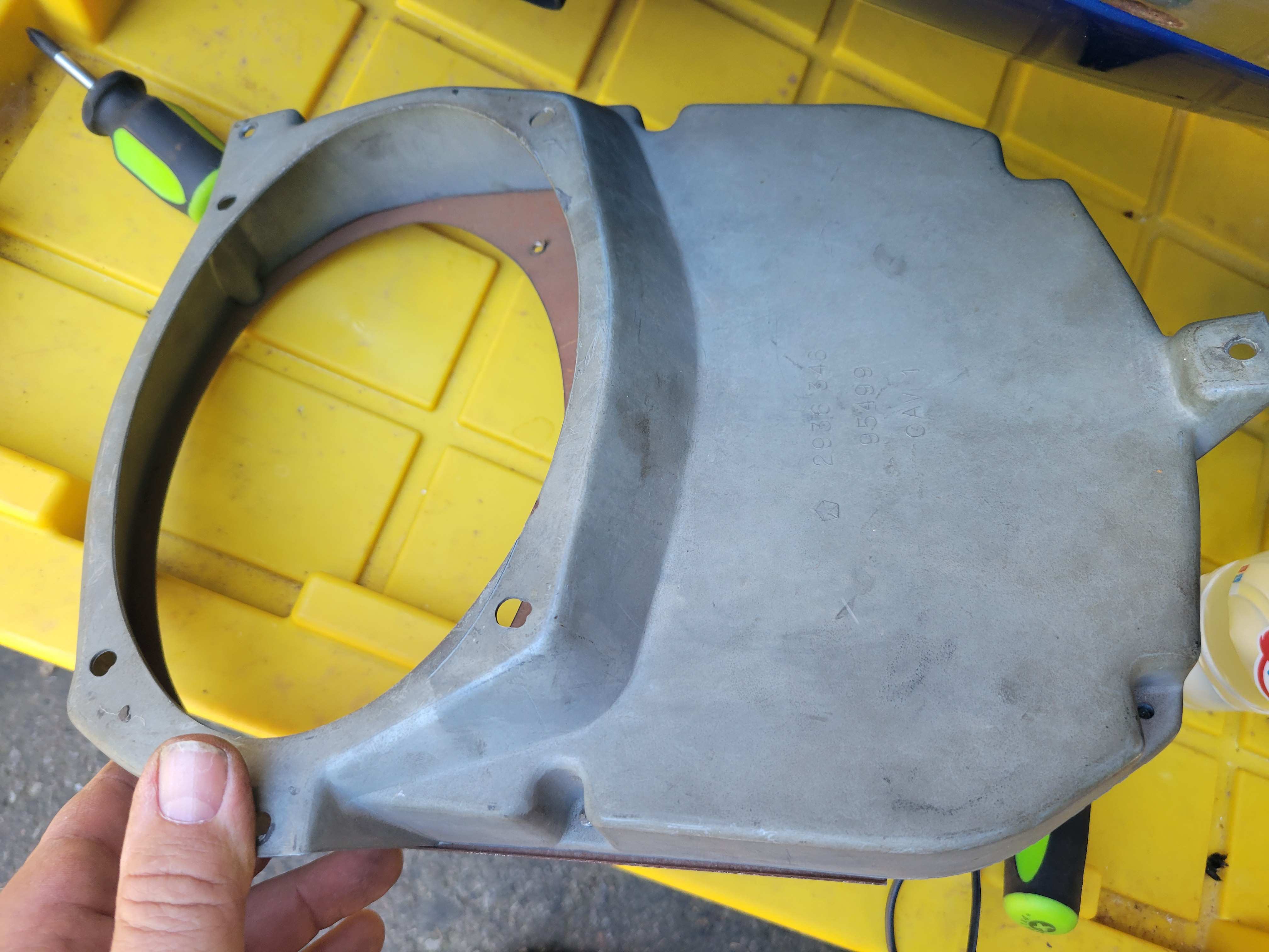

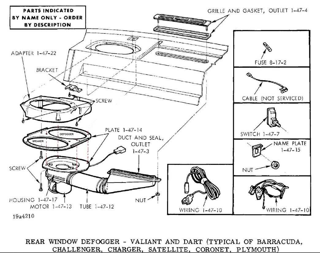

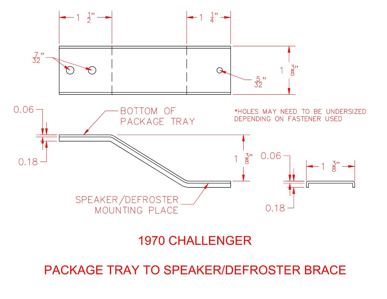

Anyone have a diagram of the rear window defroster with a speaker on it? I'm currently at a loss on putting it in. I hate to do things twice so admitting my short comings and asking gor help.

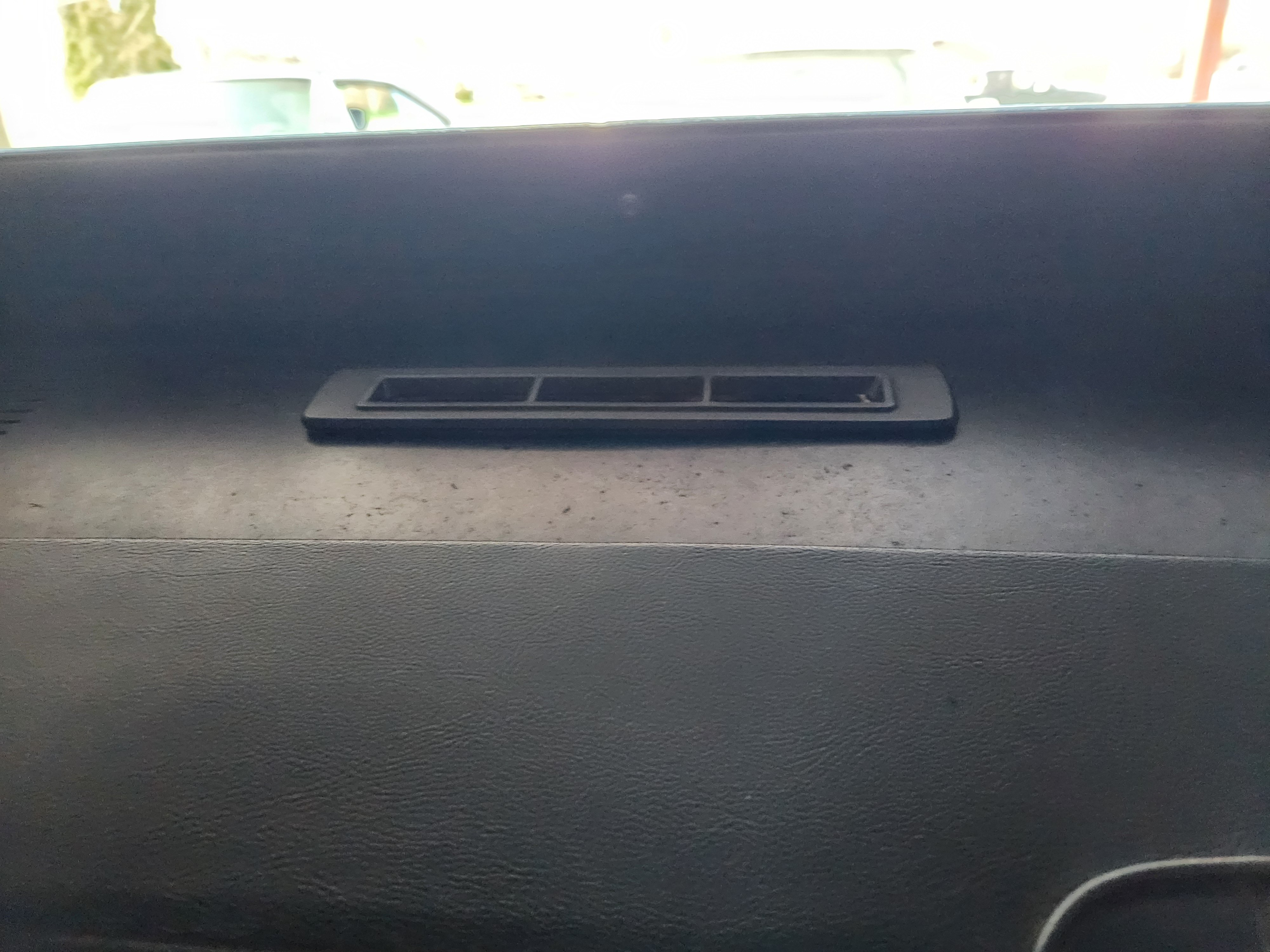

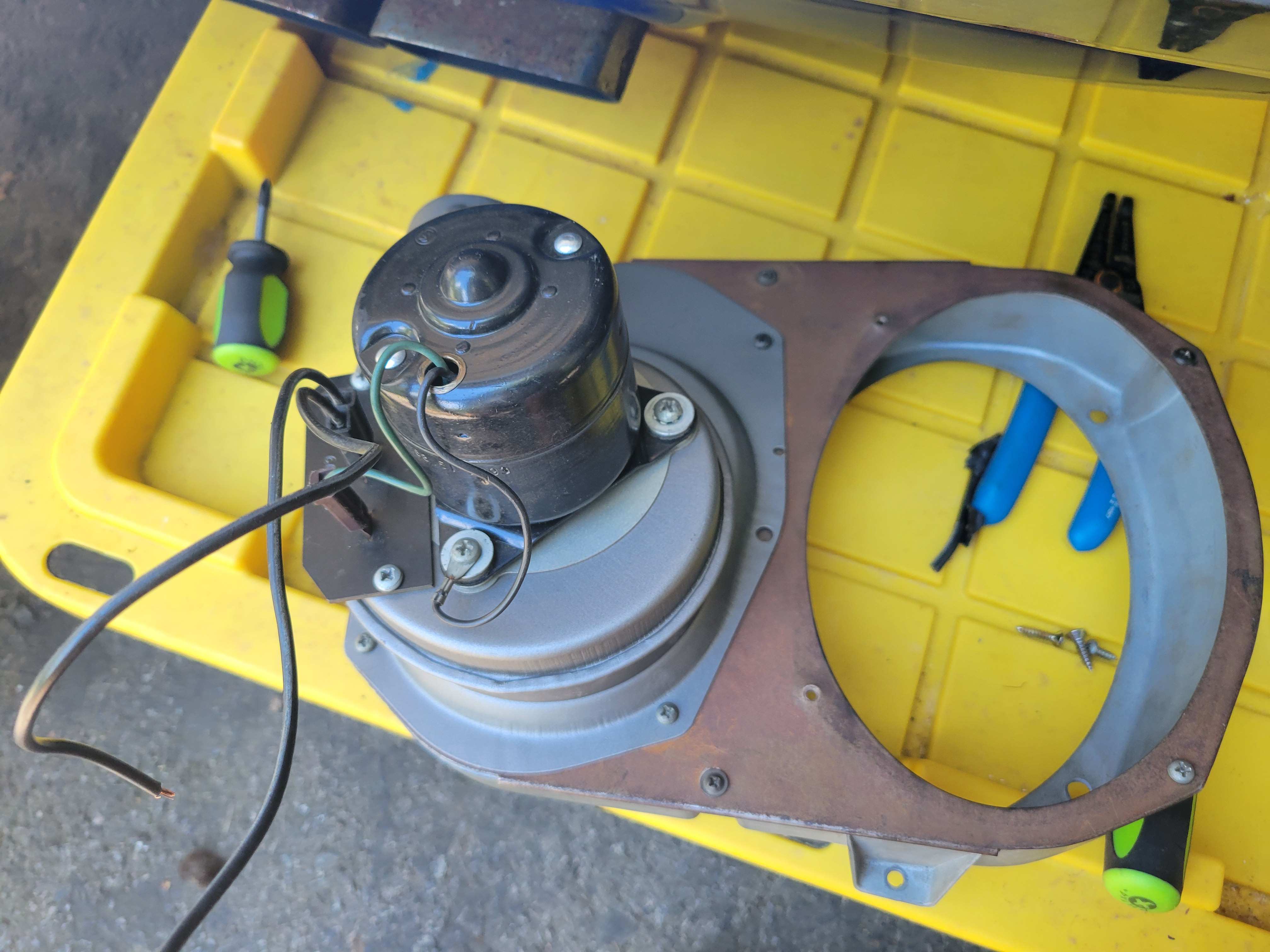

Juan,View attachment 125866View attachment 125867

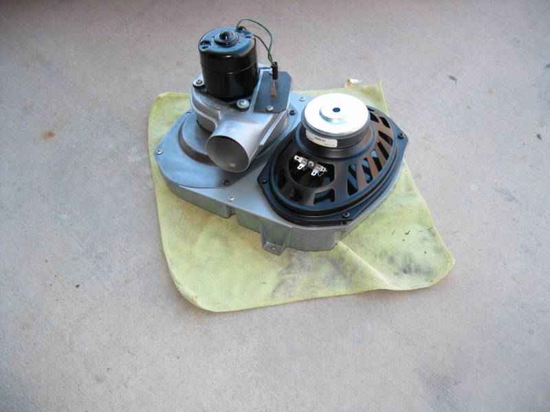

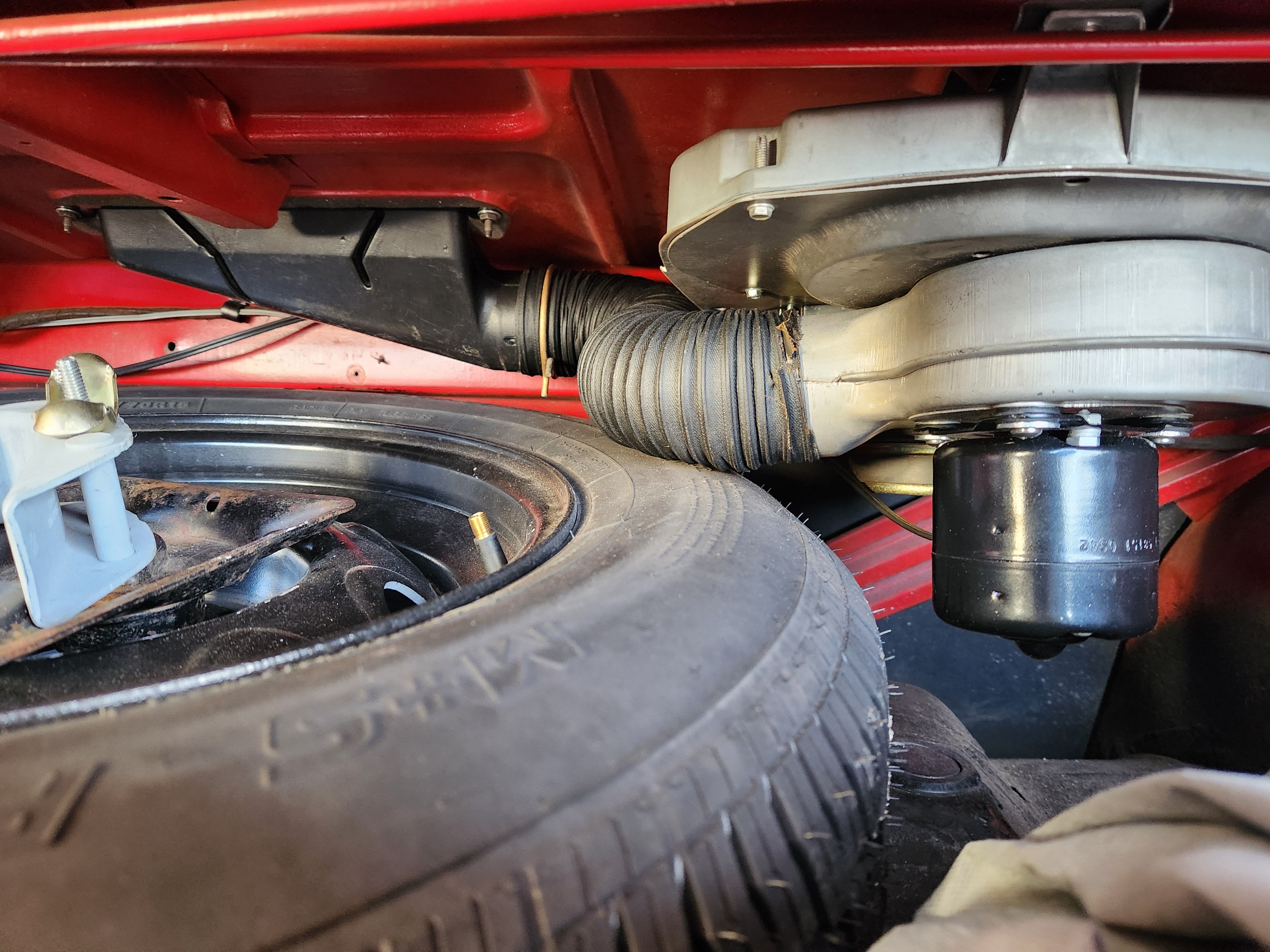

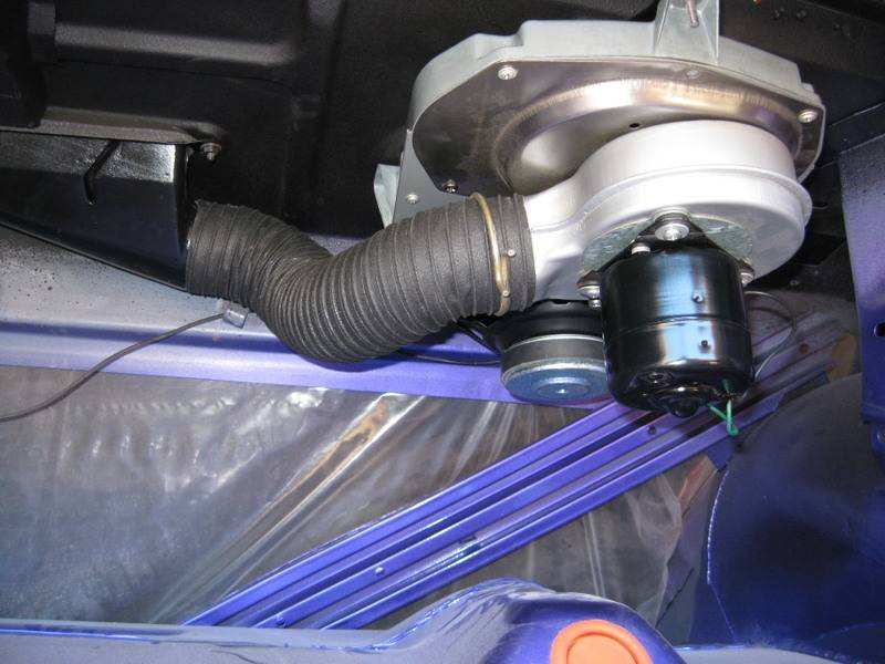

The installed pic came from someone on this site. The other pic was my setup before installation.

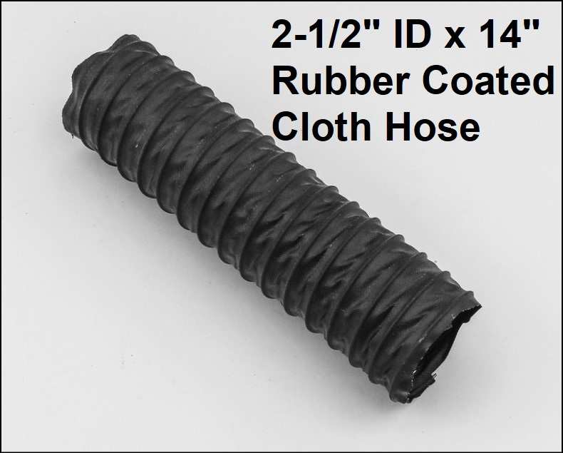

Thank you. I had previously purchased this and thanks to you all I'll be able to add a little pop factor at the shows. Y'all don't know how much I've appreciated the info you have given me.The drawing that supports the defogger fan motor installation with dual-speakers. The hose specs are below if you need a replacement. Detroit Muscle Technologies has the correct replacement hose.
