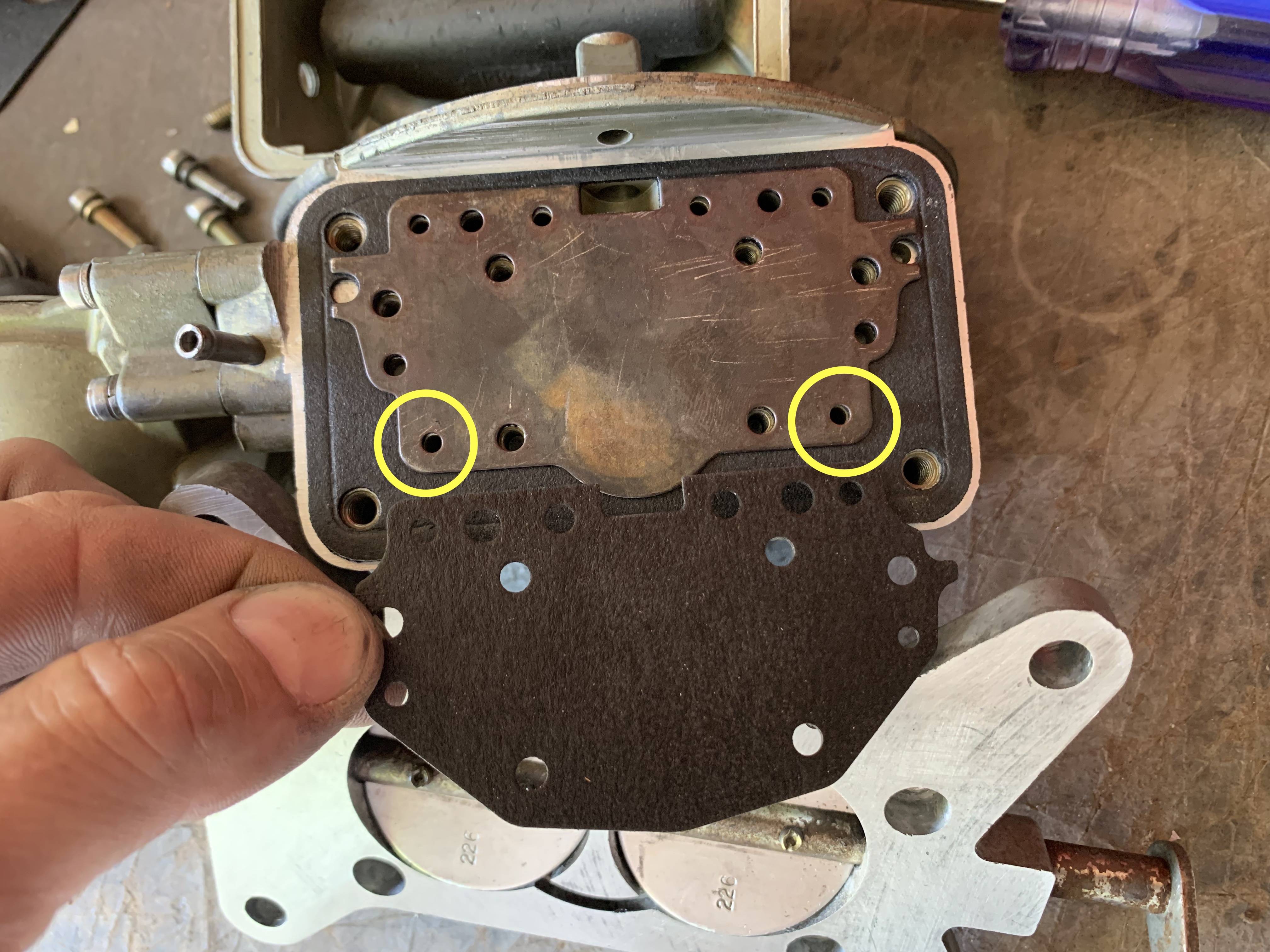

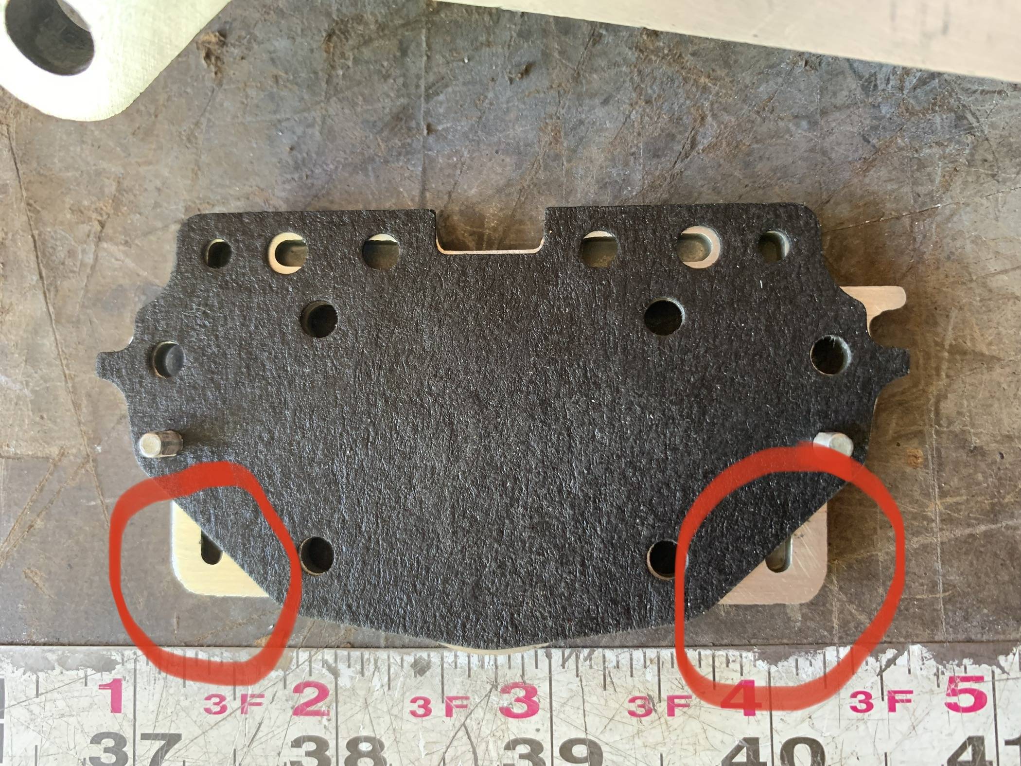

Okay, I THINK I figured it out. Failed another pressure test, so I looked carefully at where the gas was coming out, and it was coming purely from the transition slots. Took the carb apart and looked over the transition circuit, and found that two corners weren't being covered by the gasket. I'm going to try to find a different gasket and see if that solves the problem.

Definitely the wrong gasket. The correct one is exactly the same shape as the steel plate.

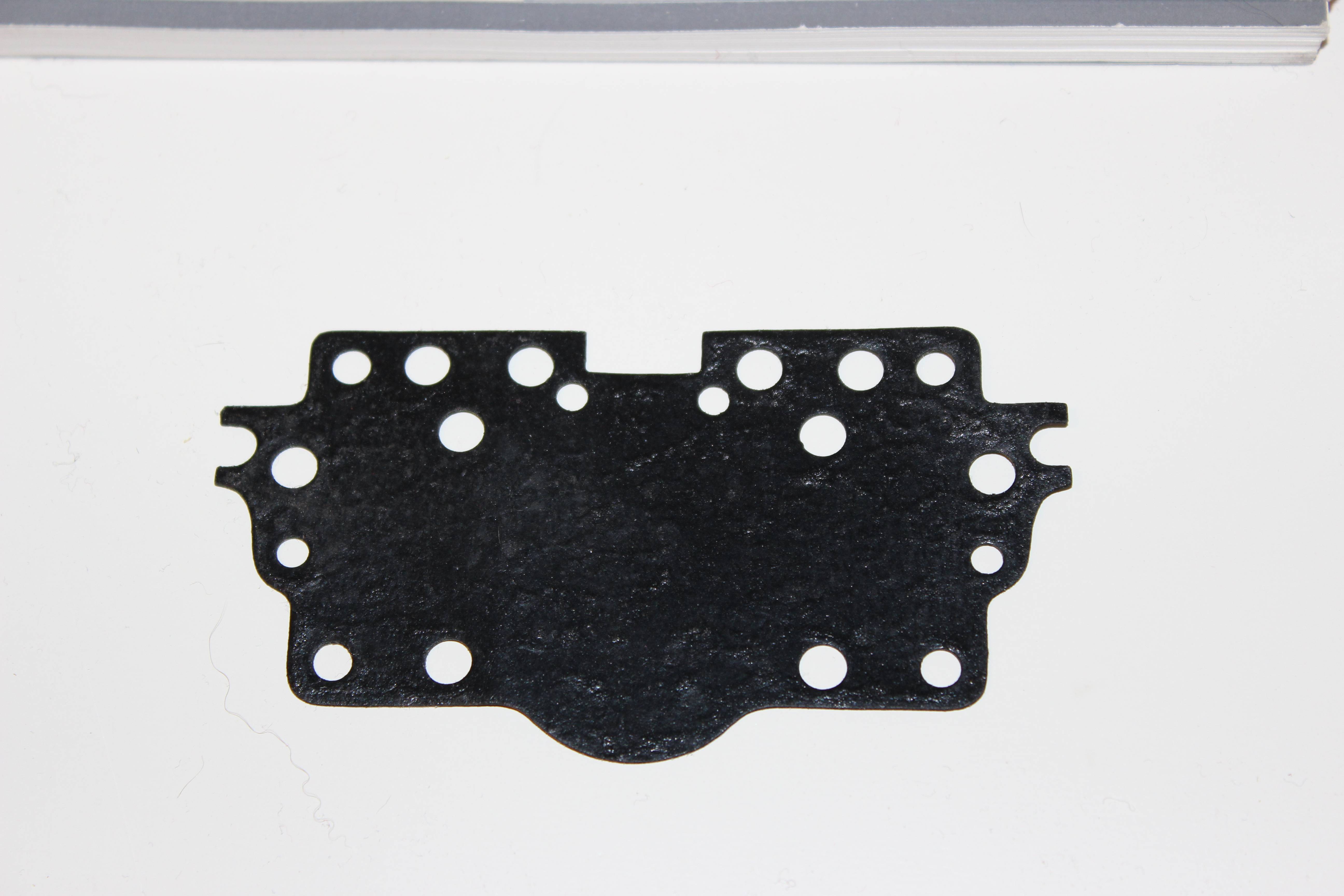

Yep!! Found the right gasket. For anyone who might have the same issue in the future, the secondary gasket for the Holley 4160 worked. Part number 108-27-2. Bench test passed with no leaks, engine lit off on the first click. Thanks everyone for your help!!
