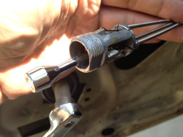

1) Which hole in the inner door skin does the joystick mount through? I thought I'd find a "D" shaped hole but no such clue seems to exist.
2) Does the joystick mount rigidly to the inner door skin, or does it just pass through and mount rigidly to the interior door panel?
3) I have the chrome bezel, but am I missing perhaps some kind of a keyed washer backing plate, and if so where can I get one?

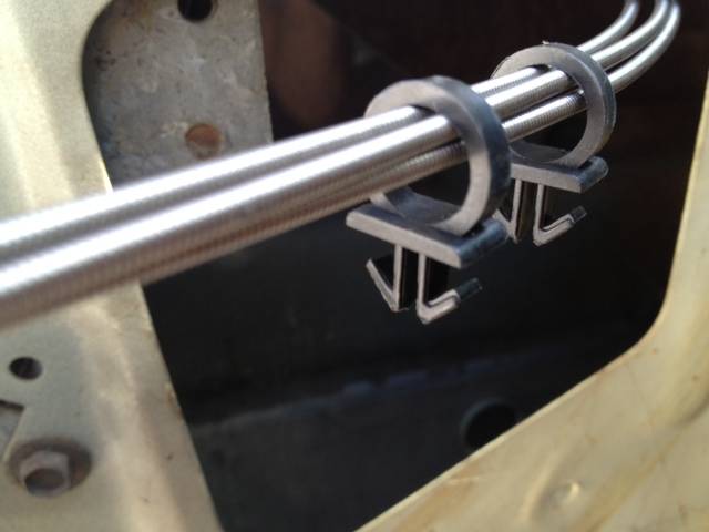

4) Where do the two cable routing clips snap into; I can tell that the cable needs to loop in front of the glass, but I dont see any obvious locations to snap these two clips into?

The parts you need are available from most restoration supply companies. The adjustment knob mounts to the door panel. You need the mounting plate that goes on the backside of the doorpanel and the chrome bezel that screws on from the outside of the panel. If your mounting screws are loose, you can also get new mounting nuts. They press fit into the mounting holes and are knurled so they won't spin when tightening the mount screws.

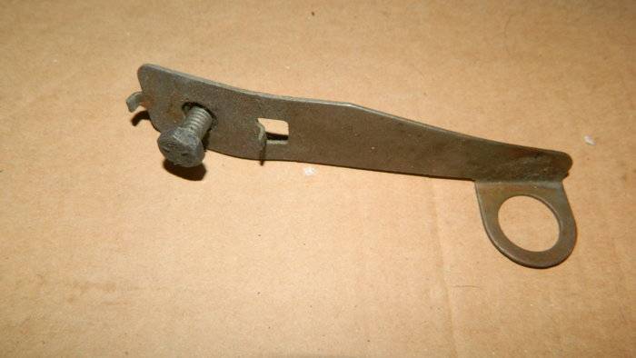

The remote goes through the larger hole...right above the big opening. There is a thin rectangular plate that pushes onto the remote before it goes through the door panel. I've got some extras. Send me your address and I'll throw one in the mail.
The 70 and maybe 71 Challenger uses an extra bracket that is bolted inside the door by the hinges. This bracket has a large hole in it that the cables go through. I'm not sure if you HAVE to have that bracket or if you can push those plastic retainers into one of the holes by the door hinges.

This is the bracket used on early 70 challengers. $50 plus the ride. P.m me if interested.
RJH
Dec 22, 2017
67
11
Helps if I load the photo.
We have a forum for selling things. What you should do is post this up in parts for sale with a link to this thread. You’d have a better chance of selling it.

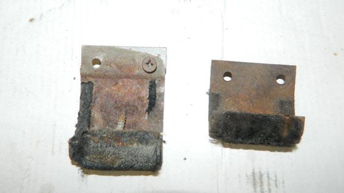

Roadrunner . If you look at your second picture you can see that you have not installed your outside glass guides that prevent the glass from putting excessive pressure on your door whiskers . This is what they look like , the larger of the two is the one you don't see in your picture
