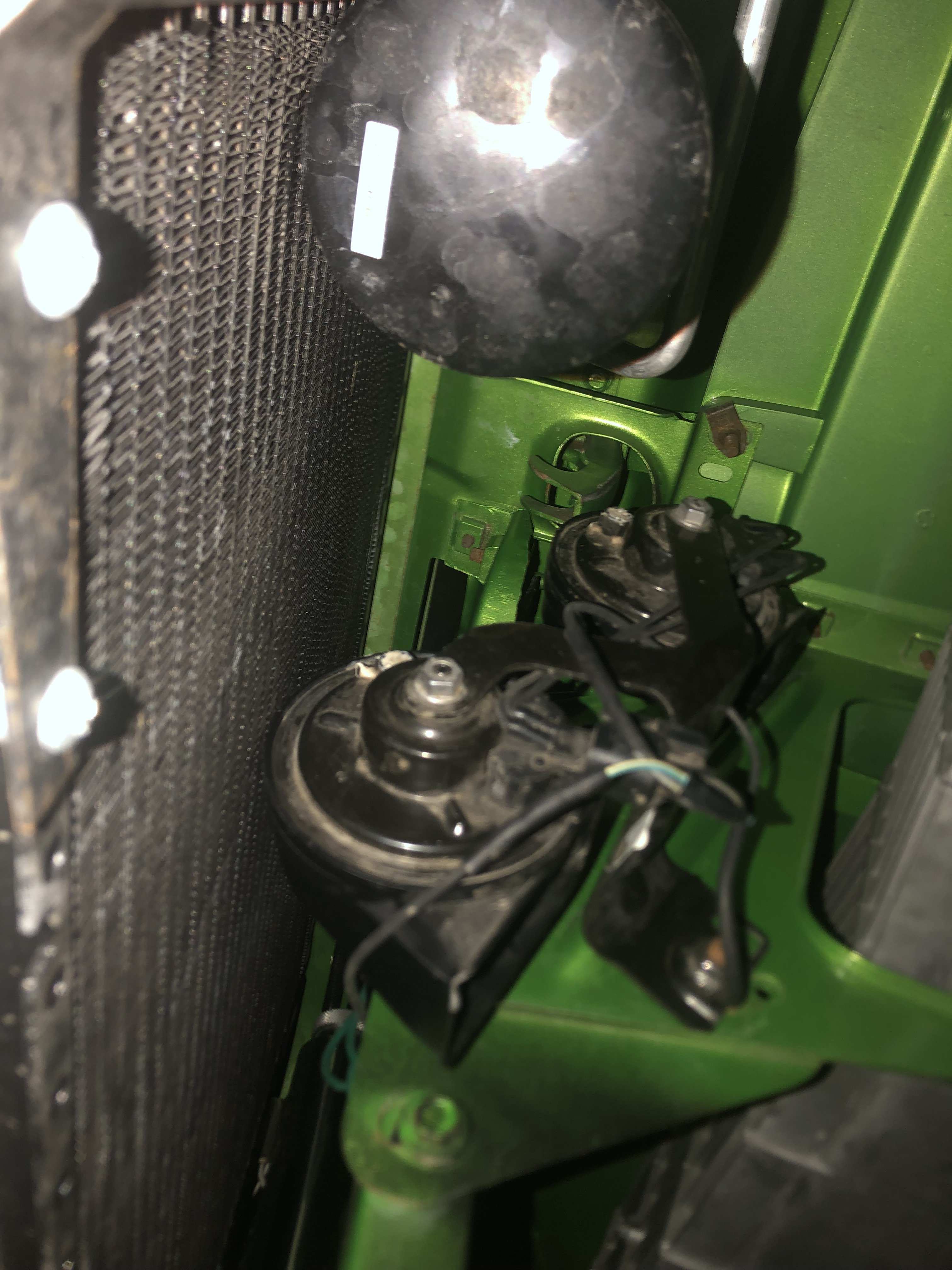

Its on a stacker out back in the garage. Maybe from the bottom There's a crap ass duster underneath it that hates a cold start for whatever reason "6cyl." I have no intention of doing anything but yanking out. I'll see what I can do. They come on one bracket and were a breeze to install.

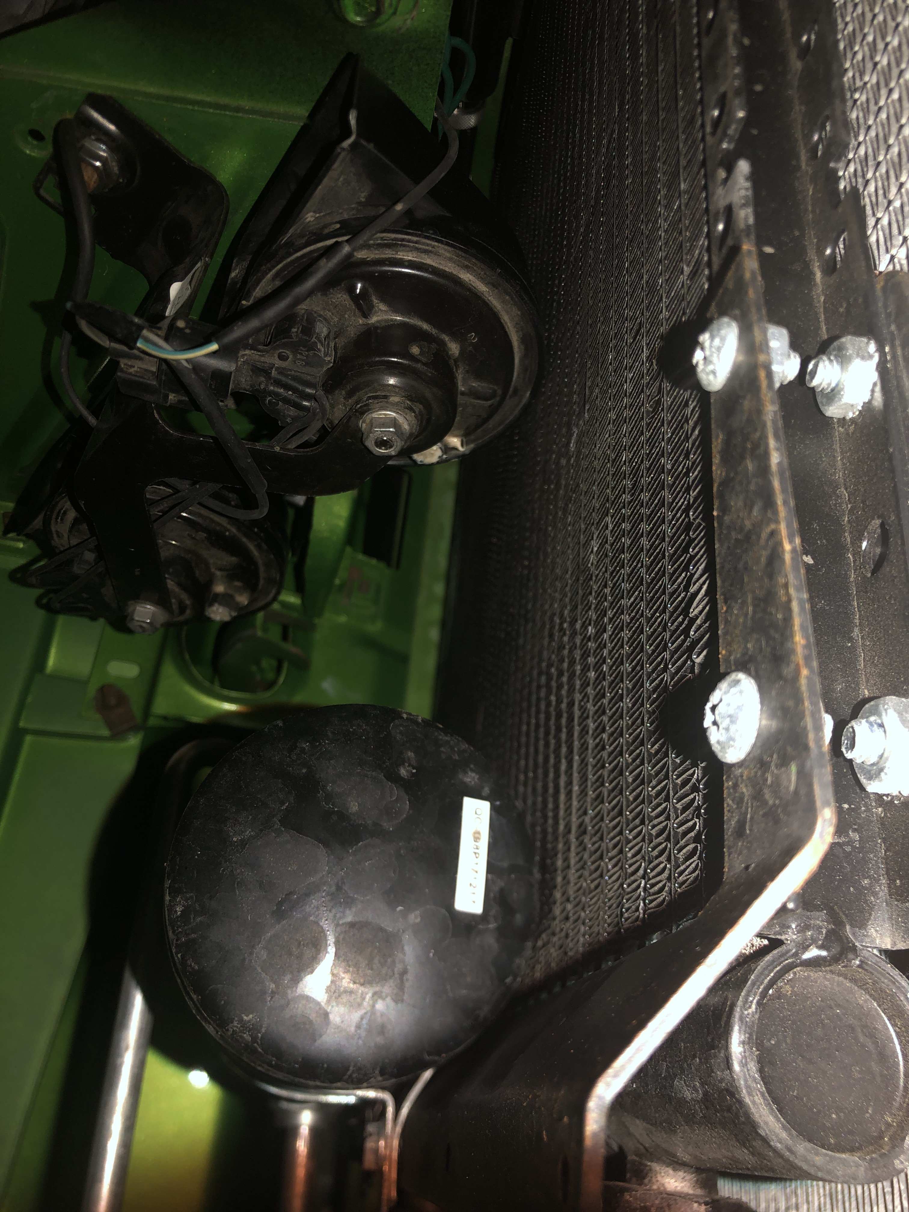

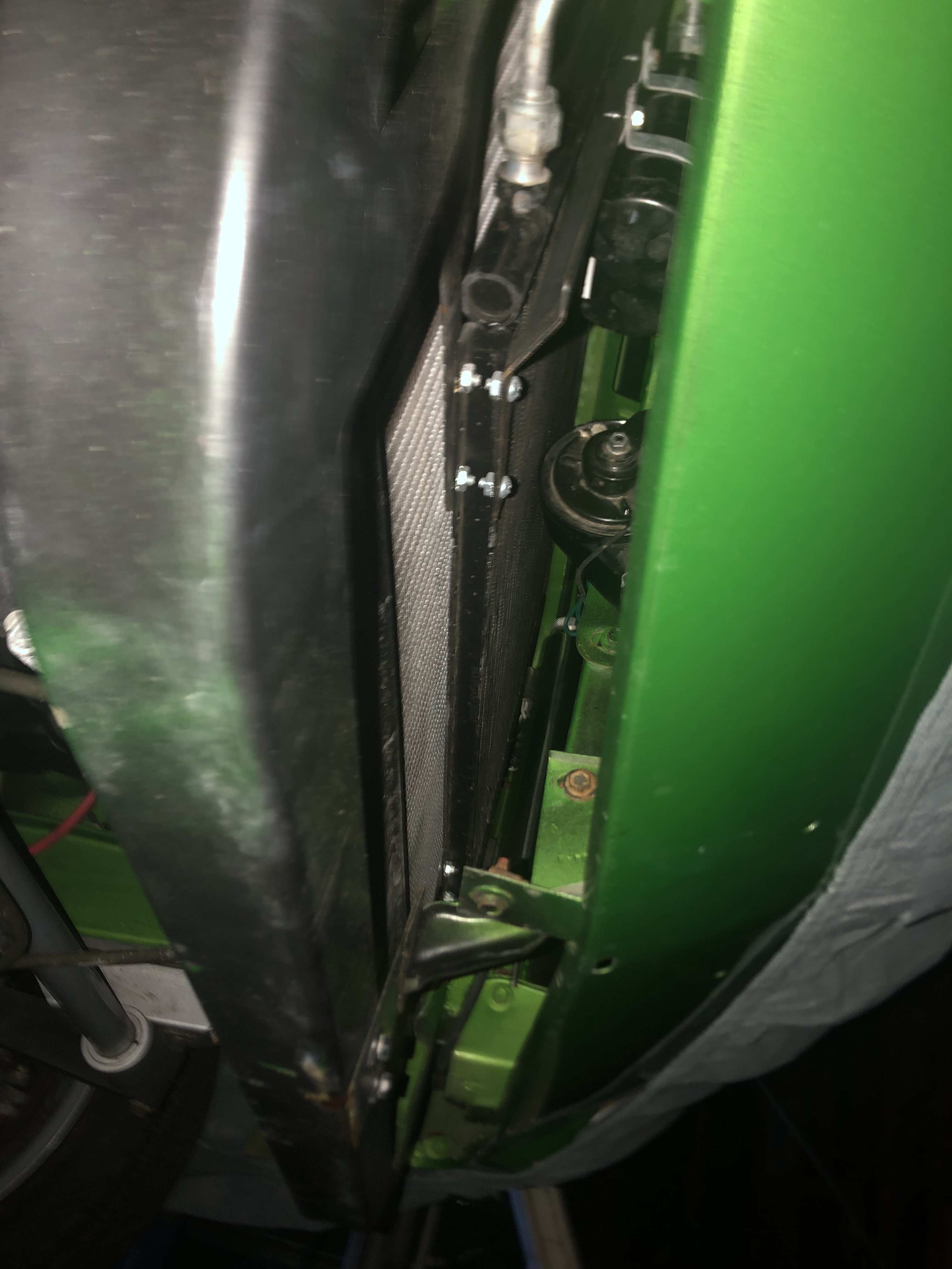

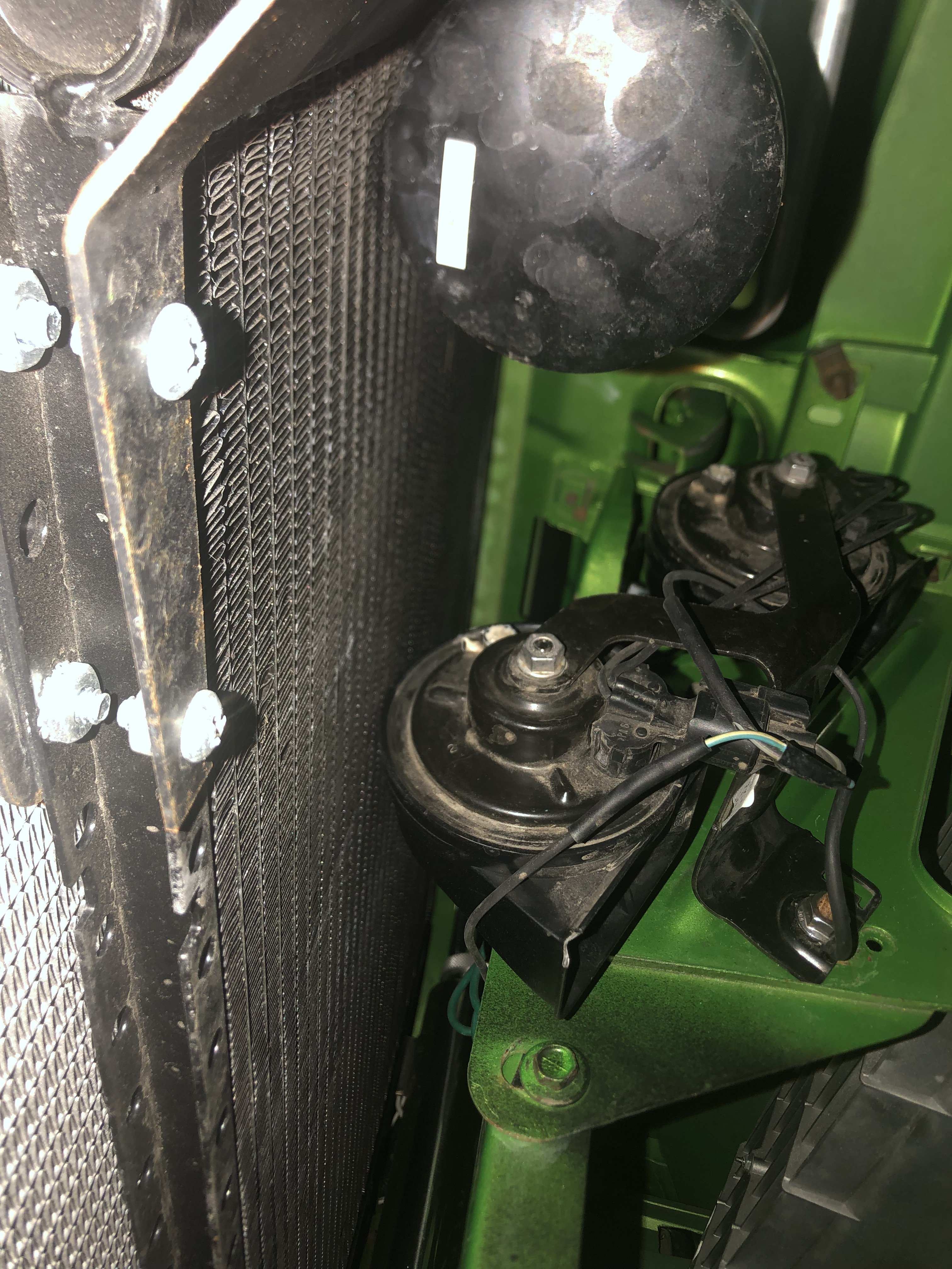

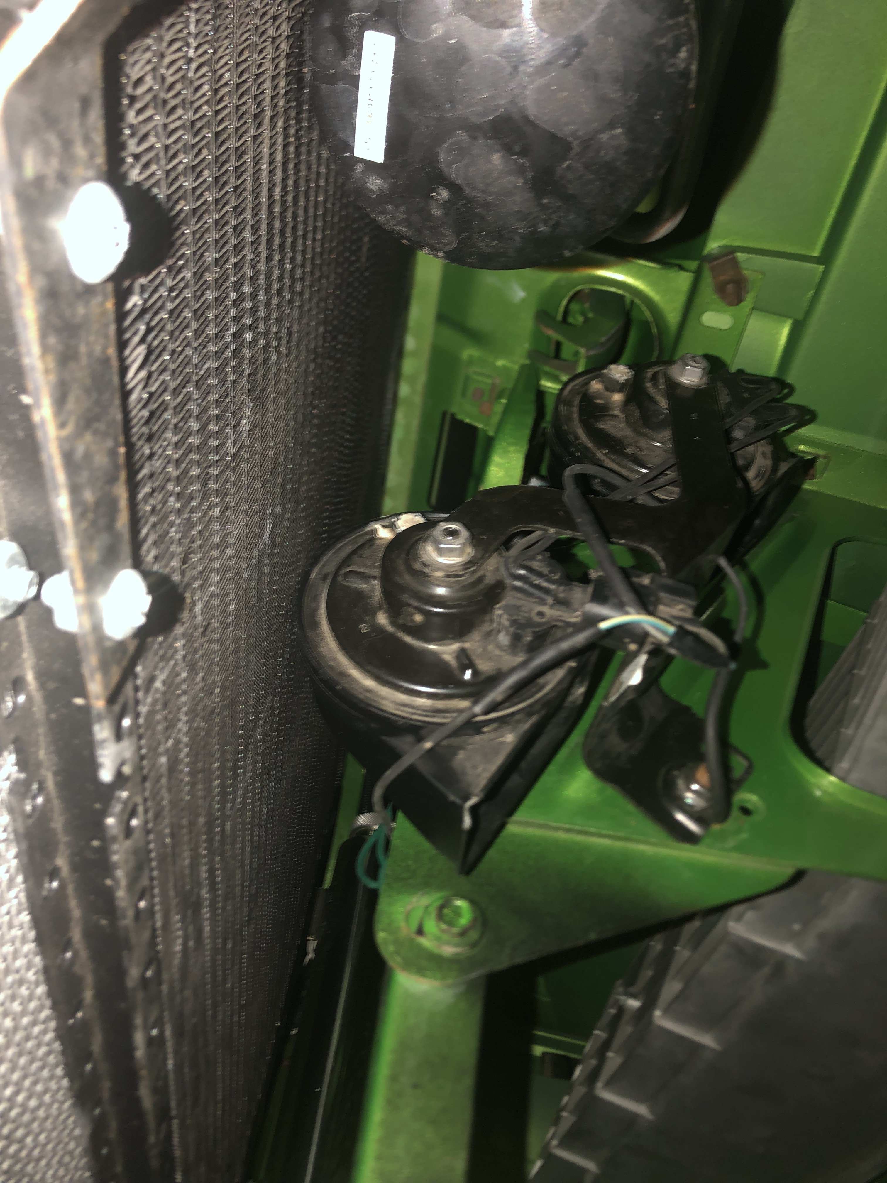

Sorry for the delay this is the best I could do with it up on stacker. Excuse the wiring I was try to get everything ready for the power tour trip to Vegas so it was rushed.

Yes it comes as an assy I would look on ebay as those are off of like 2015 up any ford product. I got mine for $47 from lkq group. Came complete with 2 horns and the bracket as well as the pigtail. I work in the collision industry so I get to see a bunch of modern things like these horns that to the purest it would be sac religious. I've always been a function guy over oe so this was any easy adaption. I'm all but sure any ford built after 2012 or so would have a similar if not exact set up. I just checked ebay $25.00 for the exact horns i have. The fF150's are probably everywhere at a pick a part they are the same.
