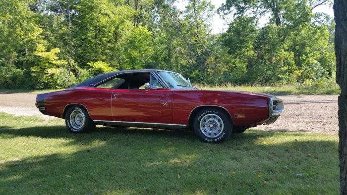

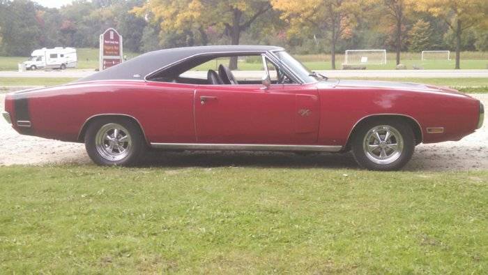

I have had 15" X 7" on the front & 15" X 8" on the rear of my Charger for over 20 years. No one has ever commented about the 1" gap at the trim ring. I run 295's on the rear only because I didn't want the jacked up look but still wanted a wider tire in the rear. I switch it up back & forth between the Rallye wheels & Cragar's with the same size tires
