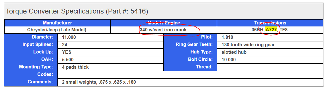

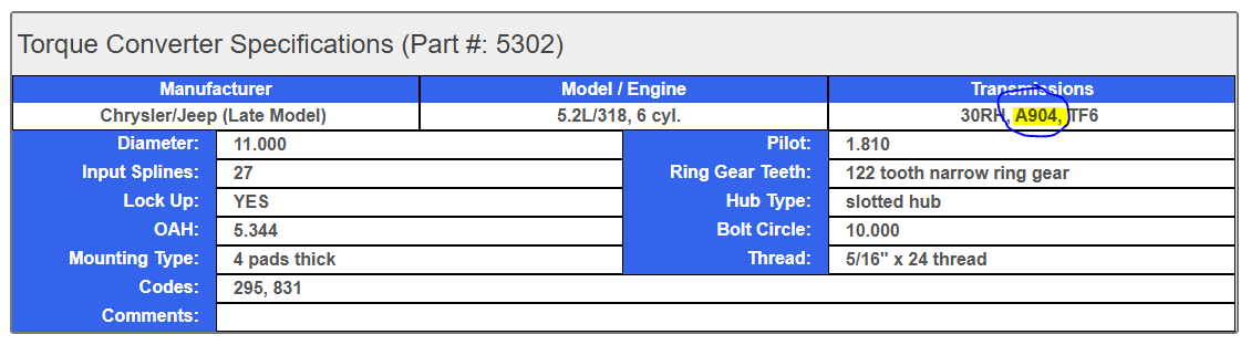

I need to get a new torque converter for a 904 transmission. It is bolting to a 72 340 motor with a cast crank and B&M flex plate. Looking at the specs for a 904 vs. a 727 it shows the ring gear tooth count is different and one is narrow and one is wide.
904 - 122 tooth narrow
727 - 130 tooth wide
I had heard that you can take a starter from any engine ebody and use it. But that tooth count would make me think differently.
Looking for input from those smarter than me.

A 904 converter will only work in a 904 trans, so don't worry about the 727 converter tooth count. Starter fits all.
The b+m flex plate should have dual converter bolt pattern, for a 904 or both sizes of 727 converter.
Make sure you get the flex plate that zeros out the 72 cast crank imbalance, so you can use a zero balance converter. (Your included info is for a lockup 904. Make sure you have a lockup, with that part#)

The flex plate balances the crank so I am getting a neutral balance converter. The engine was balanced using the flex plate.
Thanks for the info. I am using a 904 because that is what I have. Originally had a 318.
