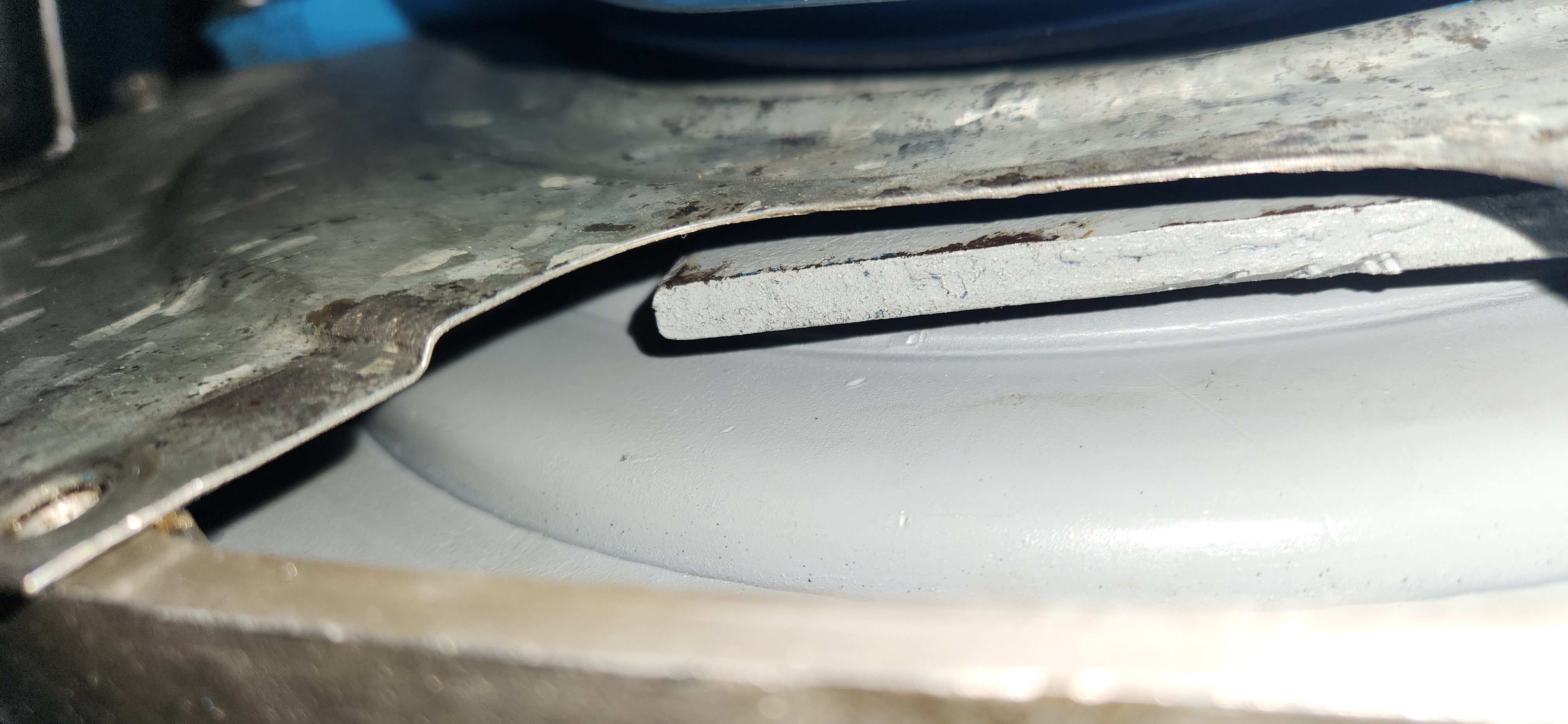

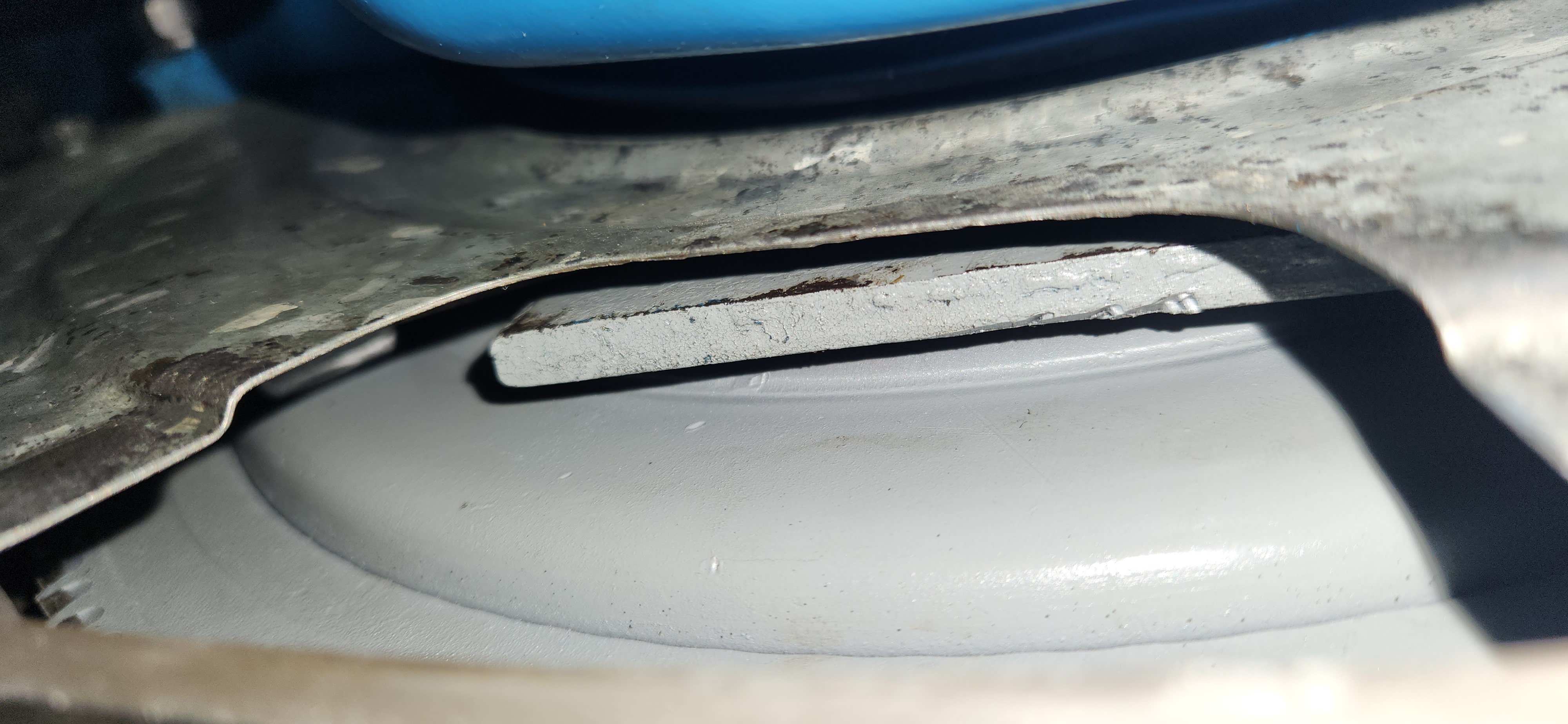

340’s that came with forged rotating assemblies were internally balanced and torque should be neutral balanced as well. Later 340’s and then 360’s were externally balanced. From the pics of the 340 unit it looks like some weight might be needed for neutral balance, depends on what year the 340 was that the unit is from. Later 340’s used cast as did 360’s which is why different balance specs.
I believe you indicated your engine is internally balanced at this point, this does point at the tc balance. Good luck

After reinstalling the rebuilt 340 and 727 combo back in my 72 Barracuda, I have a pretty terrible vibration. I thought I had it nailed when I replaced the aftermarket engine damper (that was weighted for a 360) that the engine builder installed with the factory rebuilt damper that I had sent with the engine. Unfortunately, wasn't much, if any better. I contacted the transmission rebuilder about the torque converter he supplied, and the guy that builds TC's for him retired and closed shop. So... I have a TC with no specs, no way of looking it up, installed in the car. I have a couple of pics of the balance weight. The engine builder (he only does MOPAR's) said he's never seen a counter weight that big, and has asked others, and they agree. Does the weight in the attached pics look like too big for a 340? Engine is the factory, late-72, cast crank. The transmission is a replacement and running the numbers, appears to be out of a mid 80's truck.
Yes is the wrong weight

Here's what I'd do if it was my car. Since the piston weight is close to factory, I'd pull the transmission, cut the weight off the torque converter and replace the flex plate with a B&M one for the cast crank 340.
Then drive it and if the vibration is gone, enjoy it! See link for Mancini below.
