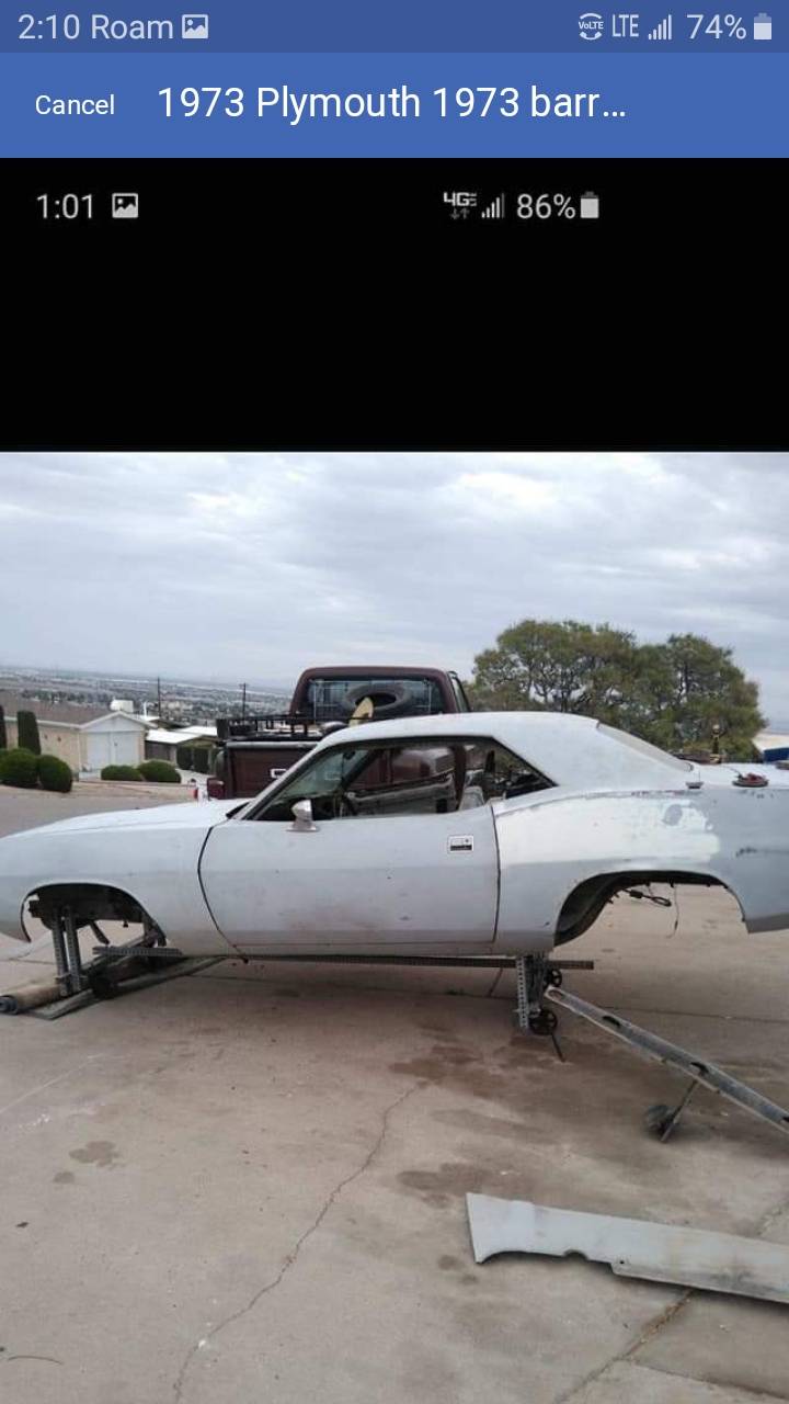

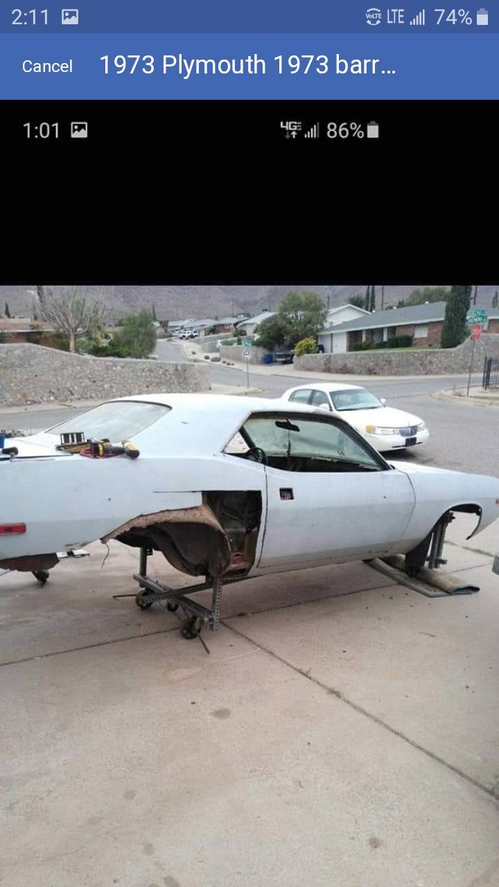

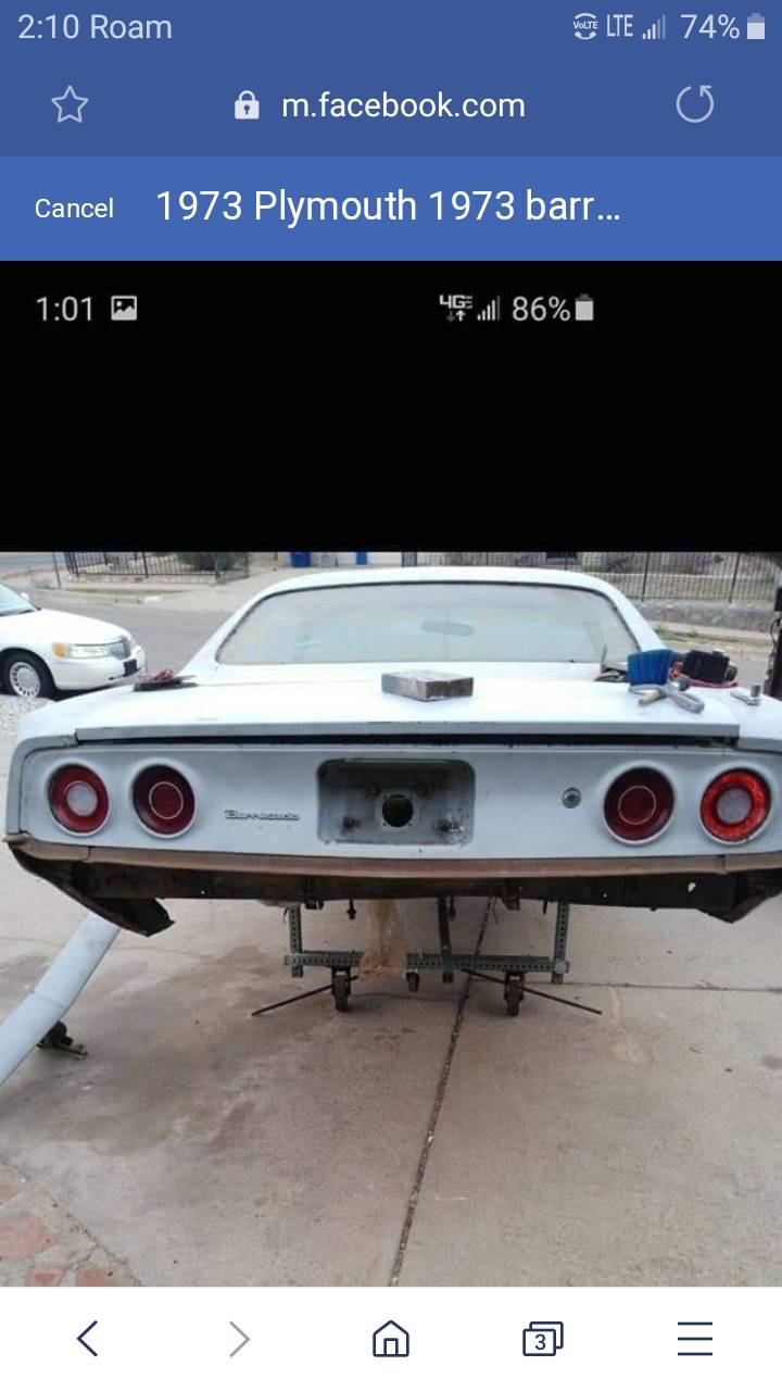

I found another in el paso which I could pick up on my home to az but 13.5k is a little much . Supposedly the car is " all there"
