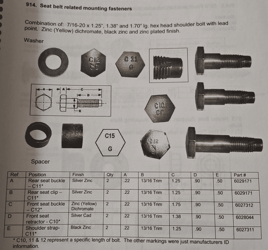

Tuesday at 7:19 PM #1 M money pit Well-Known Member Joined Nov 17, 2017 Messages 544 Reaction score 66 I tried to clean out the threads of the shoulder belt hole. I wasn't able to get the tap in correctly. Are the threads on the bolts tapered? I tried a 7/16-20 tap. My shoulder belts were missing so I was trying to install them. Thanks
