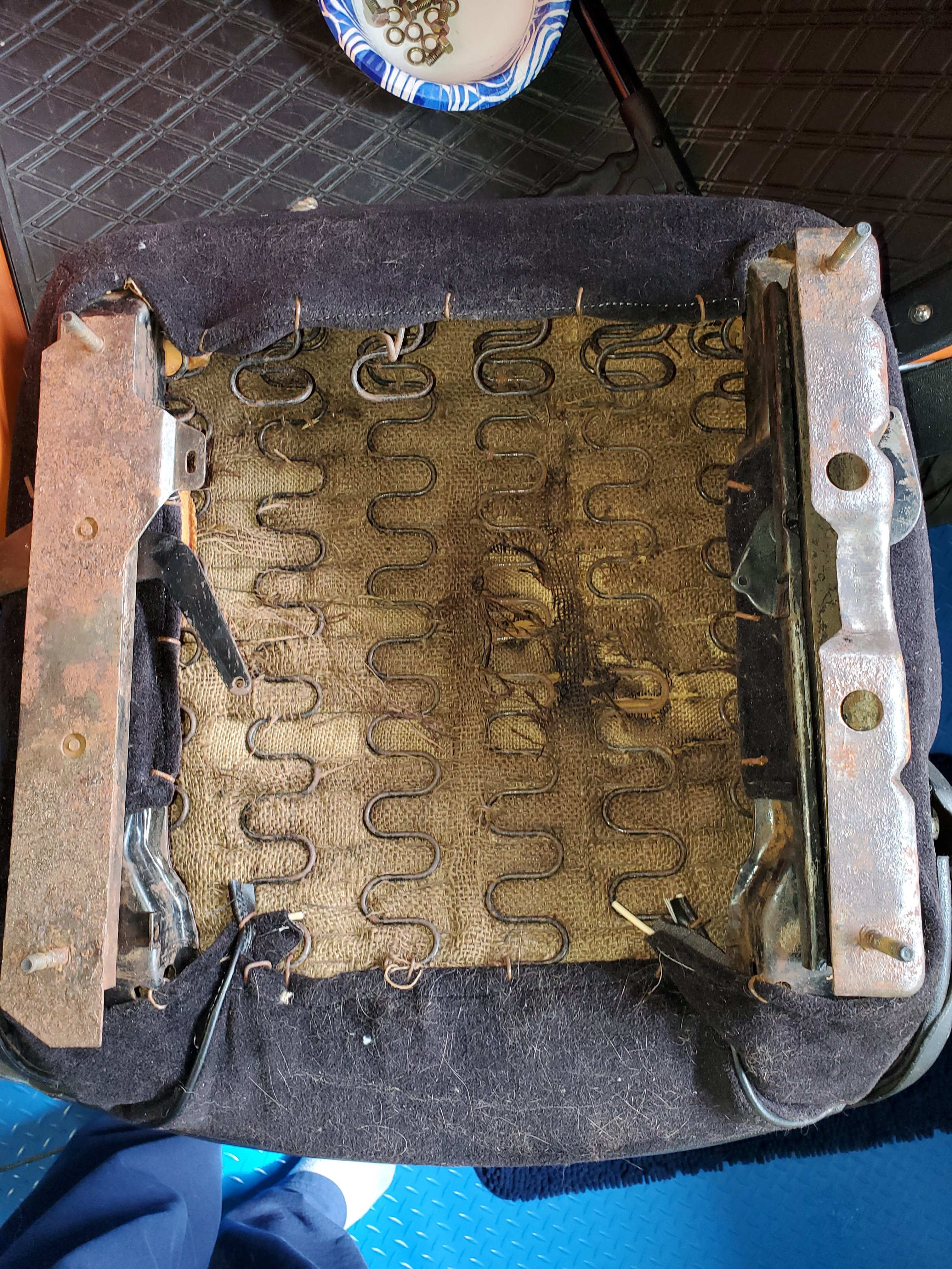

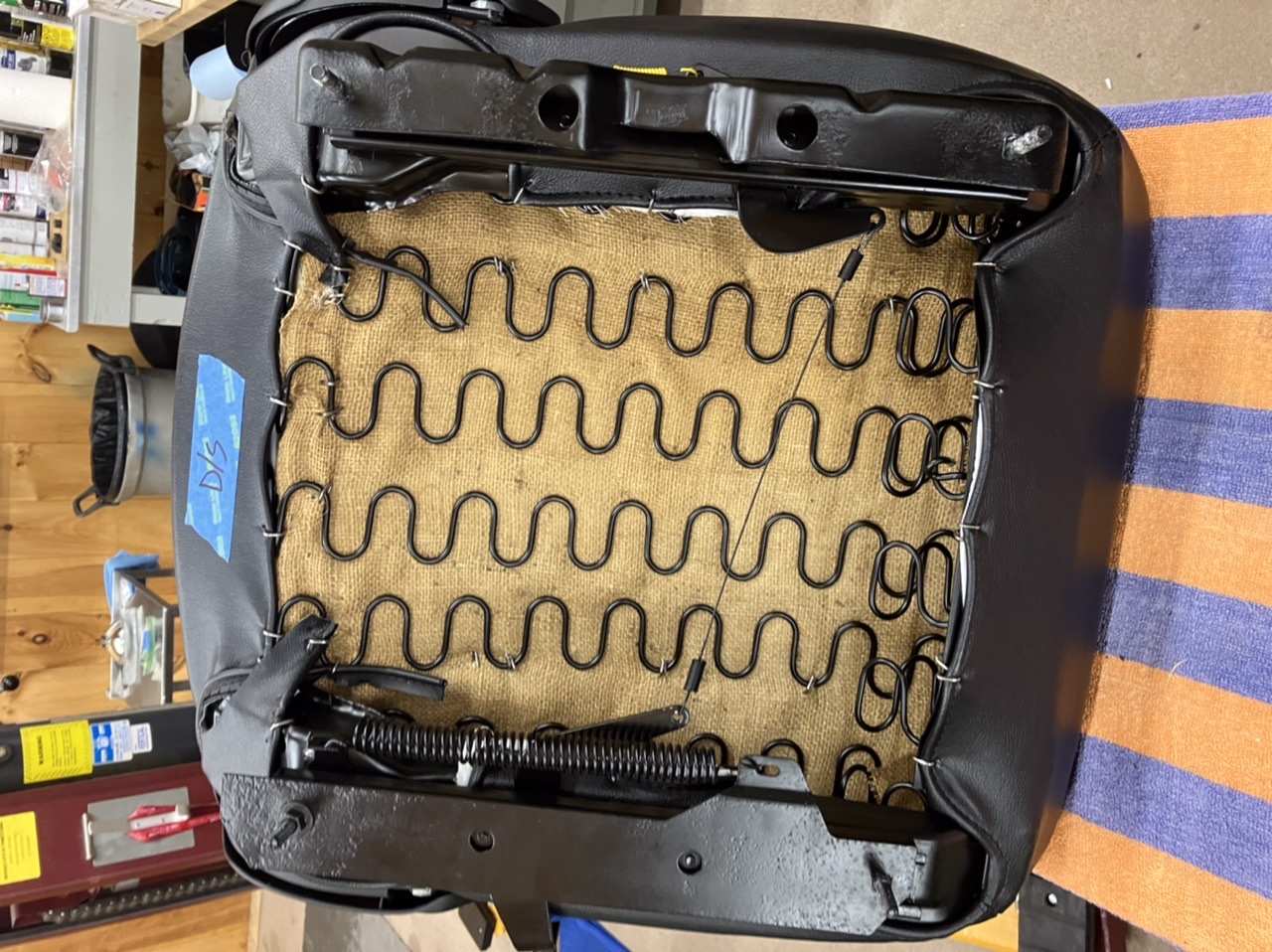

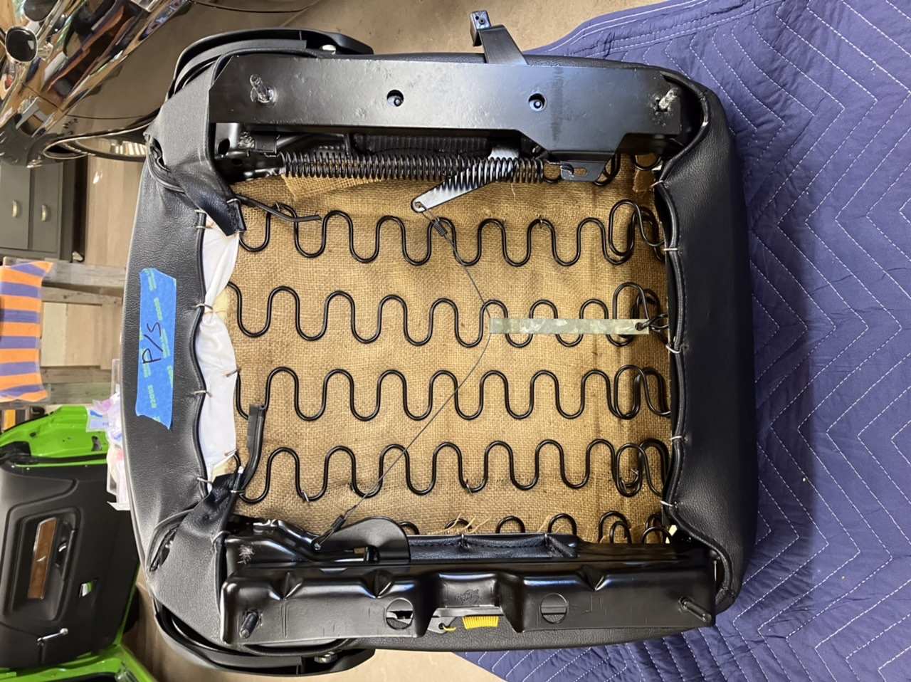

No wonder we couldn't move these , Do I just need the release cables for these and the latch springs are the same on both sides

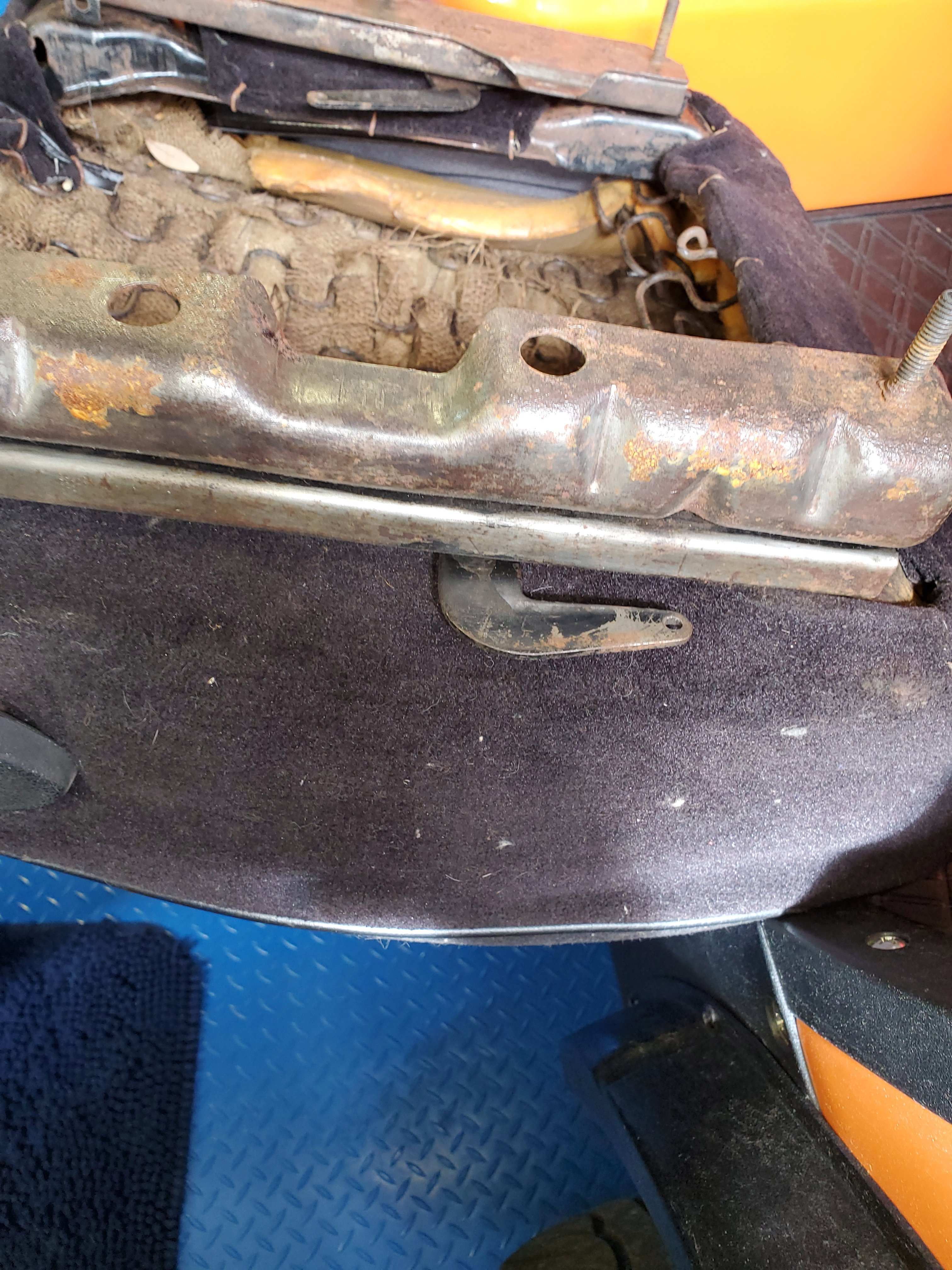

On my 73 Barracuda the return springs are the same. My seats don't have any cable that will release the inner seat track. The seat tracks for my 73 Barracuda are only controlled by the seat track lever on the outer edge of the seat.No wonder we couldn't move these , Do I just need the release cables for these and the latch springs are the same on both sides View attachment 137721View attachment 137722View attachment 137723
Thanks , never heard of MegaParts .

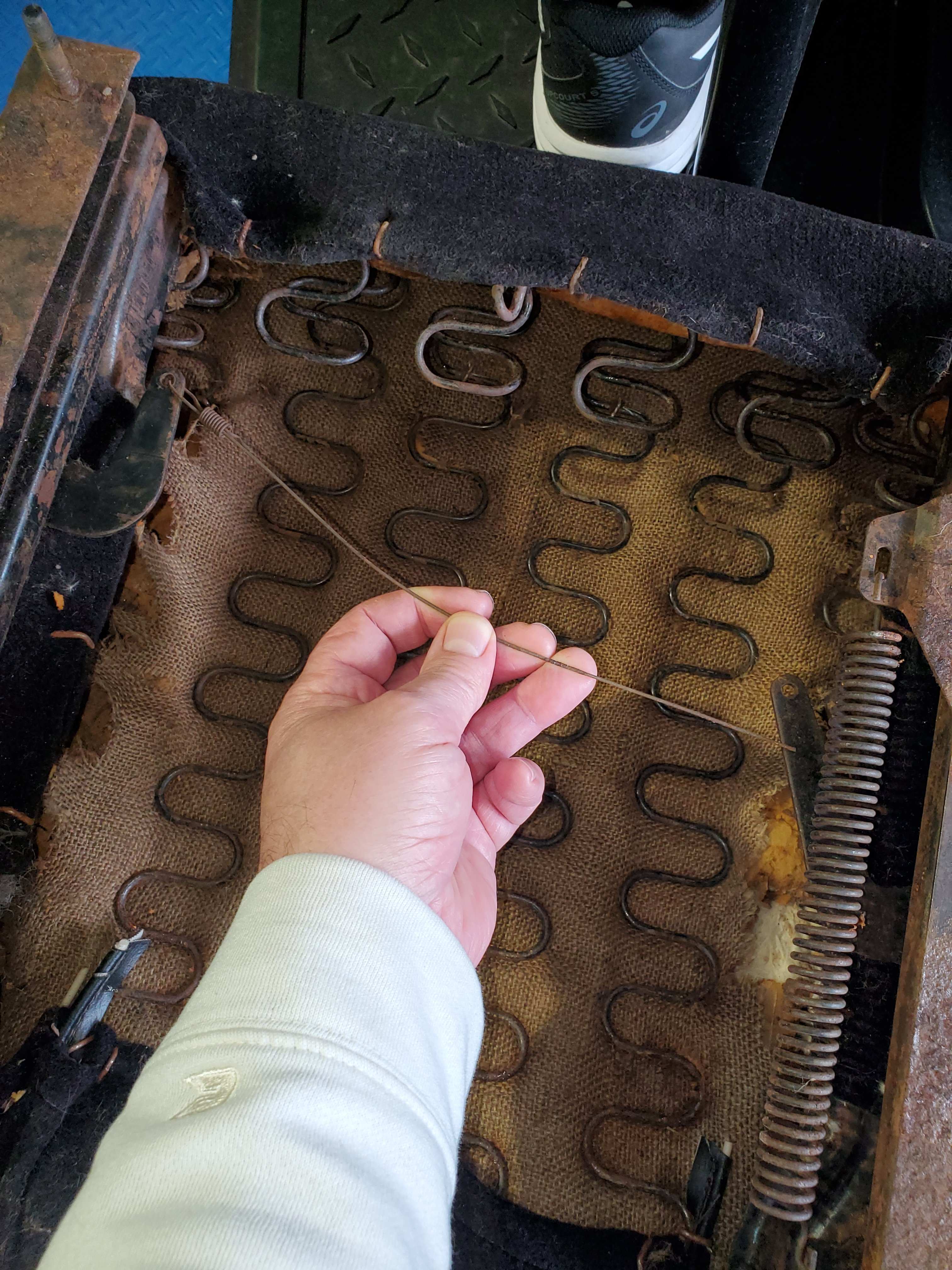

Just another part on wrong , this car has been so much trouble with mismatched parts or wrong bolts , thanks Floyd , also what part is this , did not see this . Is it on both or just one .This lever should be under the seat bottom, not on the outside.
Megaparts is a great source for parts.
Awesome thanks again .That is a small flat metal piece that adds tension to the release cable. It’s attached to an adjustable e-bolt anchored to the seat frame. Megaparts has those too.
I only needed one on the P/S bucket.
