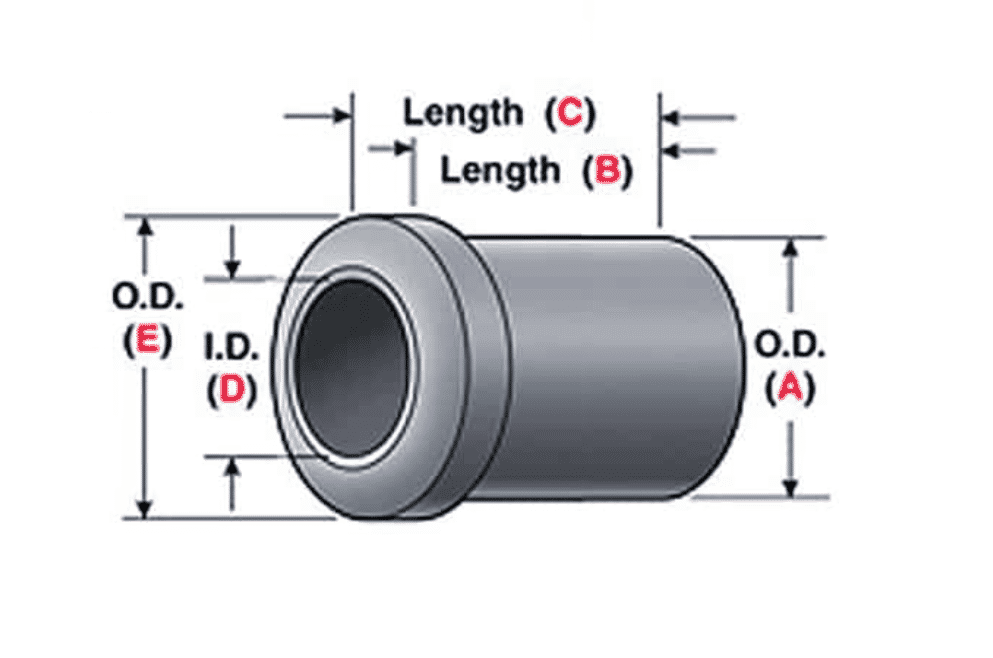

Moog K7309 bushings are for A-body springs and have an outer diameter of 7/8". P4452984 springs require the 1" outer diameter bushing that was broadly used in Chrysler vehicles including C, B, E, and F bodies, B-vans, and more, but not A-bodies, nor R-bodies. Chrysler numbers are 1400269, 2403154, 3643989. The Harris number is HB-889 (or HB889). Also available as Jeep (pre-Chrysler) number 5355841.

- HB889 Harris Bushing (2 Required Per Eye)
- HB-889 Rubber Harris Split Bushing 1 O.D. 9/16 I.D. 1.6875 O.L. 1.25 I.L.
