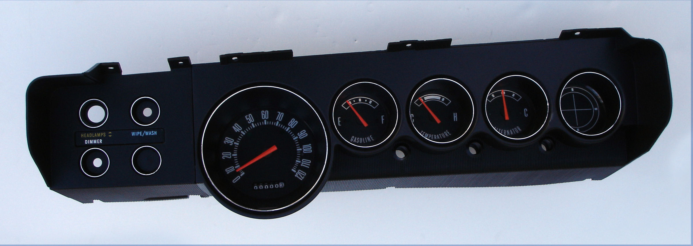

Hey guys,my 72 340 cuda has a 120mph speedo and I was wondering if that was something routine or should it have the 150mph from factory?I'm new to the fine details of the e bodies.I always thought the cudas had a 150mph but from year to year I'm lost.
