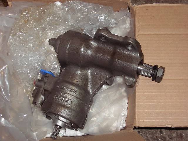

I just recieved a firm feel box , stage 3 as I had the same issue/concern.

I have the steerngear stage 3.. NIKKI's tight & precise! It took a little bit getting used to at idle/low r's (backing out the garage and such). But its really nice out on the road!

Replaced the steering box as it leaked everywhere with a NAPA reman, as well as the steering coupling, pump and hoses. Shimmed the pump valve to lower the psi....MAN what a difference, actually like driving the ol girl now....

Man Napa sells a reman? My Cuda I just bought is sloppy also. Checked it out today and the box is the culprit. You can even see the steering shaft move in and out as you wiggle through the slop.

Summit Racing carries them also, $109.00 if I remember correctly...
