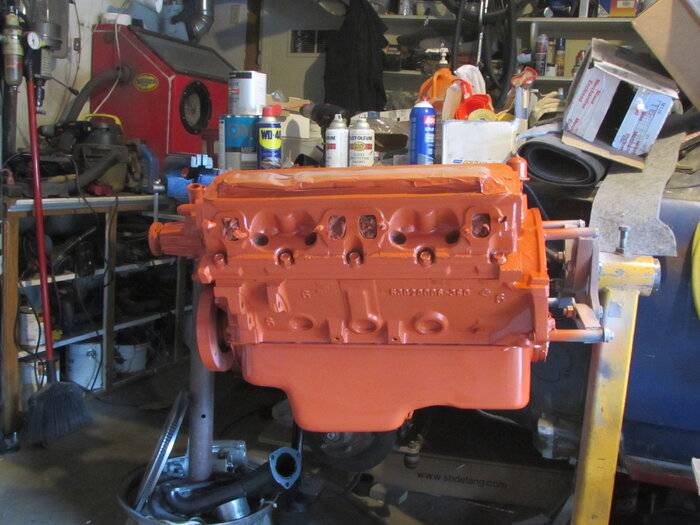

I got a motor out of a motor home, 360. Have it rebuild and went to drop it in the car today. Problem is the oil pan is way too big. I have been looking on line and not sure which style I will need, rear, middle or front sump. Can any one out there tell me which oil pan I need. Thanks for your help.

Looks like this...

The pan we used has 392 stamped on the bottom. You will need the correct pick up to go with it. Mopar Performance sells it.
