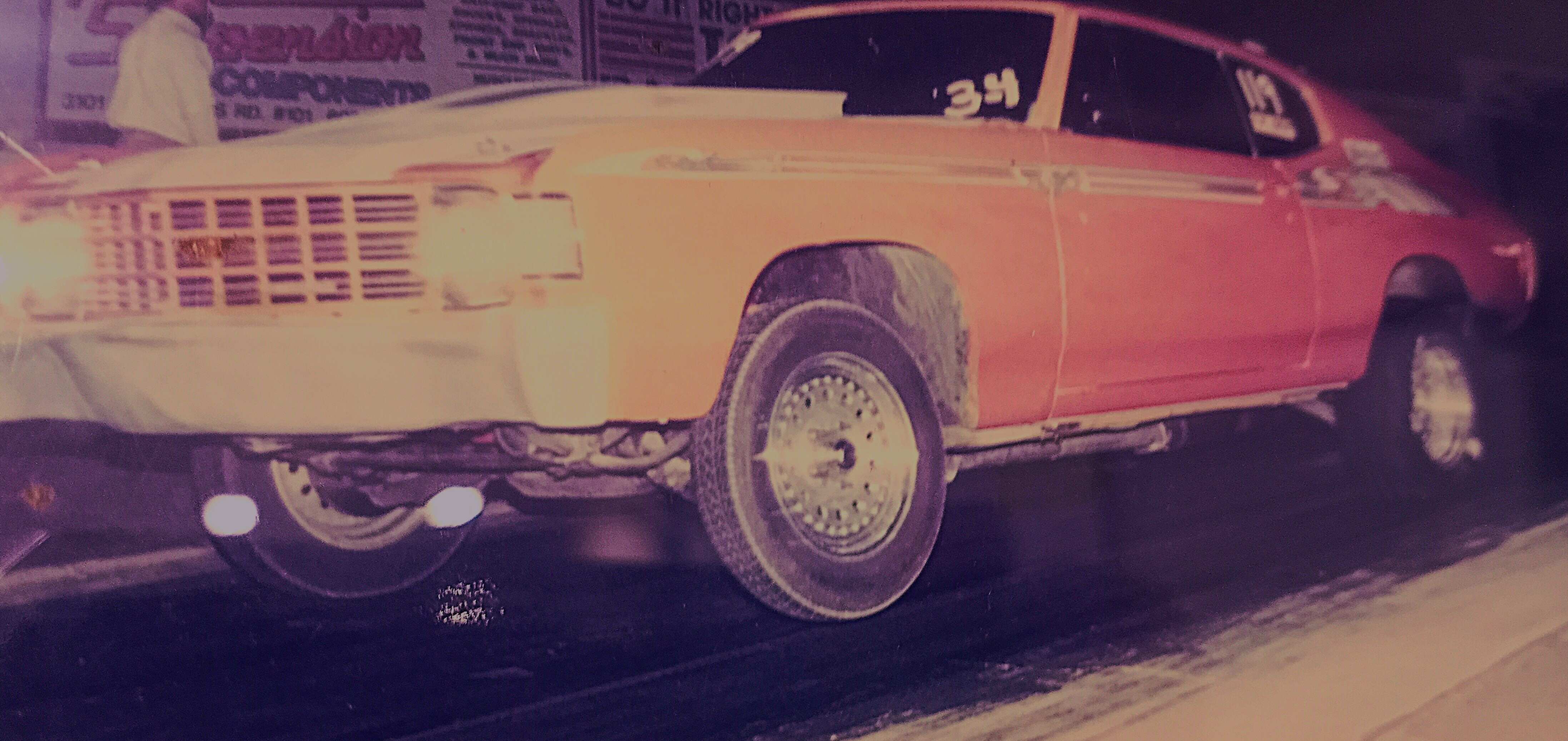

Well... My 1972 Chevelle ran 10.80 @124+ with P/S, P/B, A/C, 3.73 gears and an off the shelf Hughes 3000 stall convertor at 3660 lbs (w/d) thru the mufflers on Hoosier 295/50 street treaded tires with a stock stroke, iron OVAL (ported) port 454 at 10.9 compression, Comp Cams 262/.651 solid street roller cam. I built it in 1988 and It was my daily driver and only car for over 3 years. I ran it most Friday nite drags. With a plate system it regularly ran "greasy-all- over-the- lane" low 9.90s@ 134. In 1988!
I machined and built the motor and modified the rear suspension. It solid hooked on the motor, but I couldn't hit the plate till near the 60' lites. I don't remember the 60's, but they were dismal.
The iron oval port heads only flowed around 270 cfm and that's why the fastest carburetor (head flow limited) was an 800 dp on a Dart single plane intake. Horsepower calculated to lo/mid 500 range.
I have 9 sec hopes for the Challenger since it's lighter, has 4.10 gears, 4200 TCI, trans brake, 275/50 R code drag radials and my custom spec leaf springs with relocated front spring eye mounts, subframe connectors. Not to mention 512" w/TFS raised runner and ported heads, a bigger roller cam, HP 950 holley, and 7.1" rods as opposed to the 6.135" of the chebbie.
I expect around high 600+ HP numbers. I have learned a LOT since 1988. Since I still own my own HP machineshop I believe this is doable. I will not quit until I get a 9 sec. time slip thru the muffs. Then whatever it runs with the plate.Time will tell.
