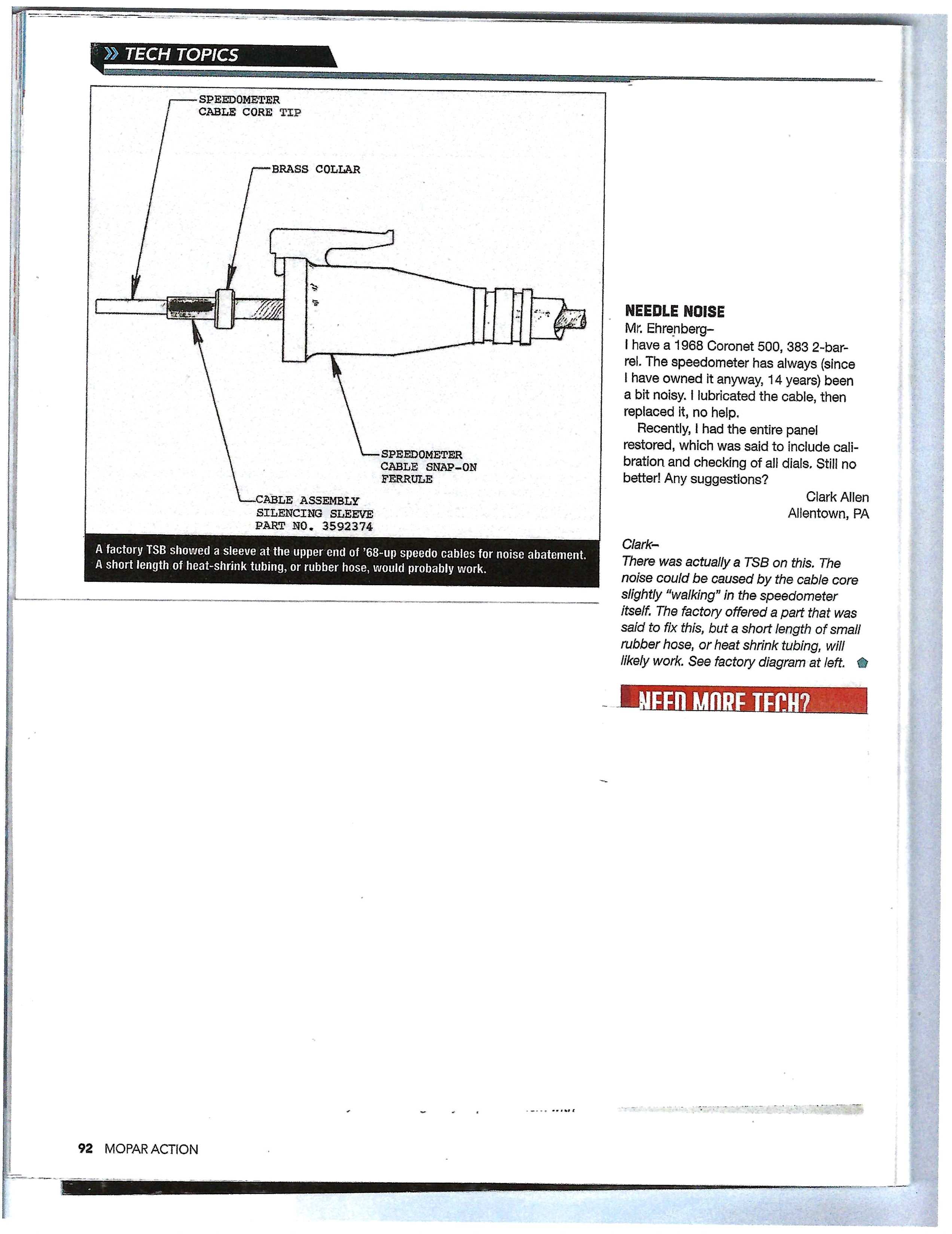

Ehrenberg has this tip in Mopar Action a while back. A factory service bulletin fix. Maybe it will help.

Silicone grease is quick, cheap and easy before replacement of the cable. The rubber heat shrink tubing will probably work, but you're well past the most difficult part of replacement at that point!
