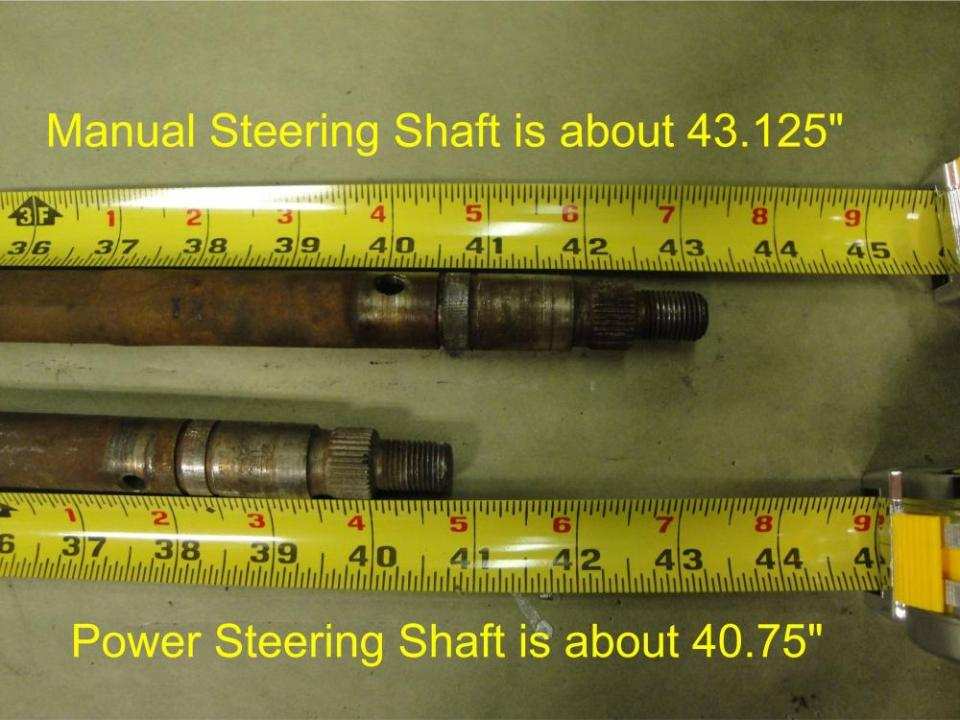

You can use the same column, a manual steering shaft will need to be collapsed a bit to the proper length, and you'll need a power steering coupler, but those are readily available. Otherwise the columns are the same, the only differences are between floor and column shift. If you haven't already, watch the other 3 parts to that video series as well.

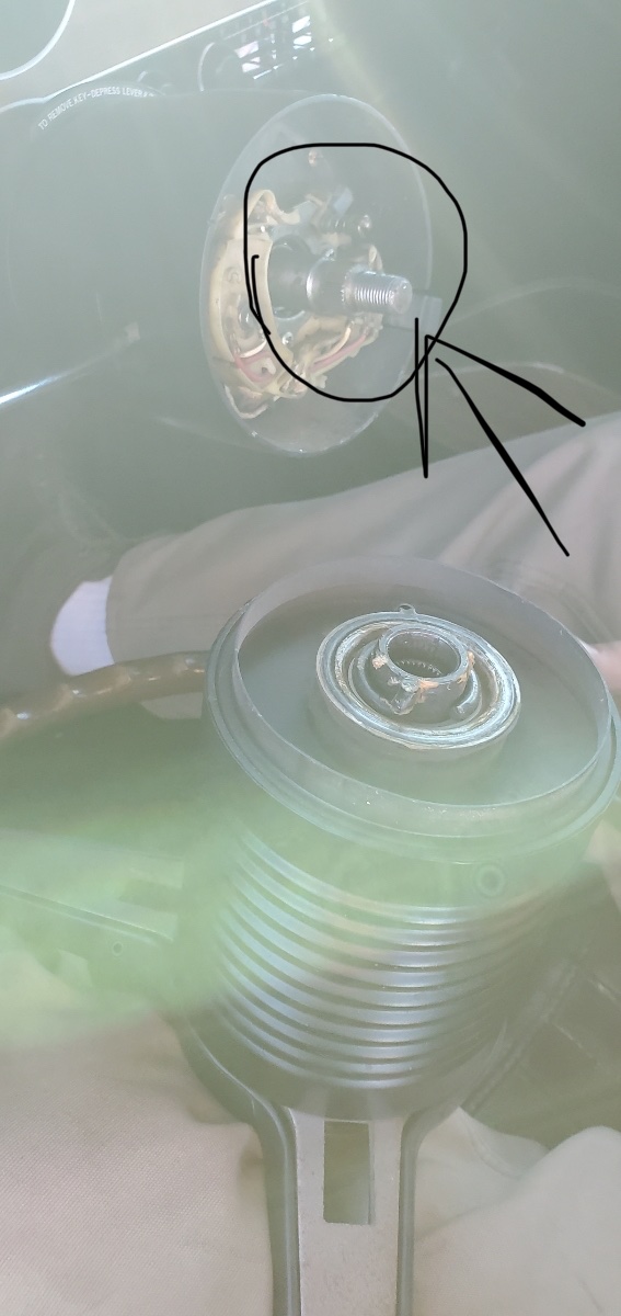

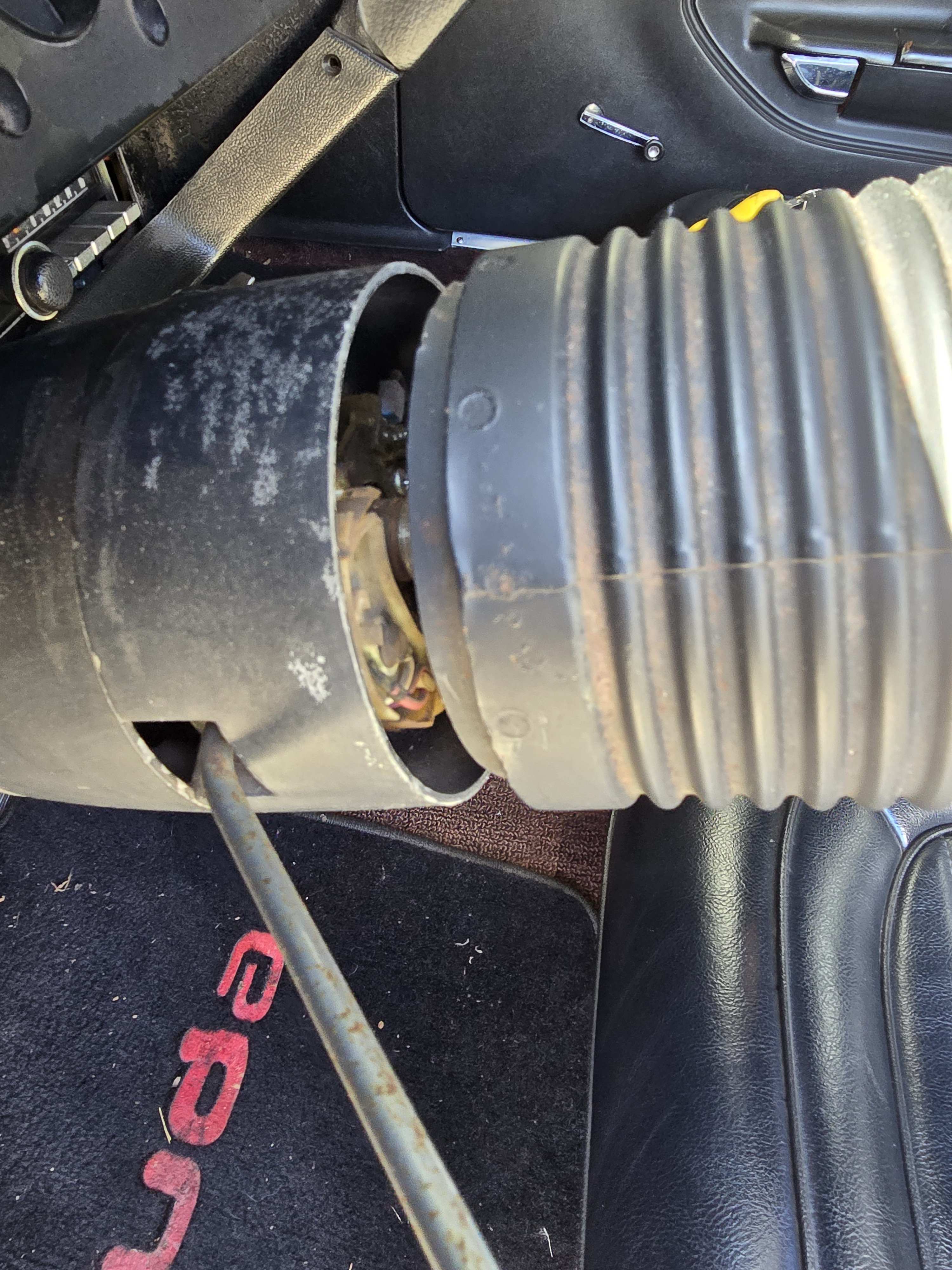

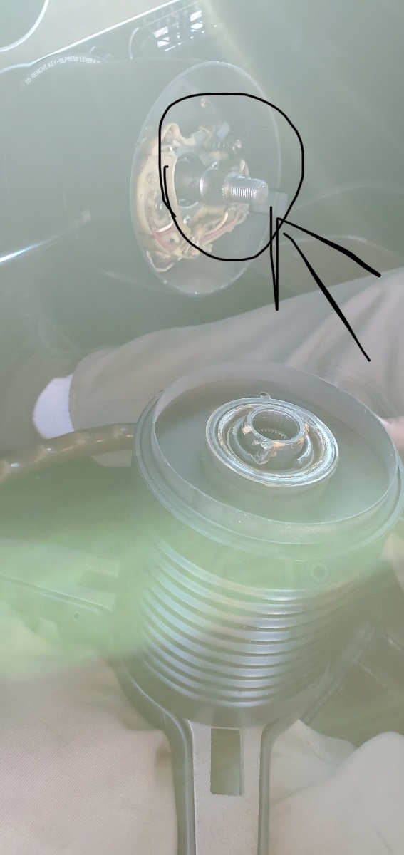

Take off the steering wheel and post a pic.
Should be obvious if the nut is seated or not.
The nut was seated, I lightly taped the steering shaft and it went down easily. The crush can and the column now fit properly. Thanks

You can collapse a longer manual shaft to make it the length of the power steering shaft, or vice versa. I think cutting the shaft comes into play if you use the coupler that comes with the Borgeson box, but from what I understand Bergman Auto Craft makes a coupler that fits the Borgeson box that doesn't require cutting.

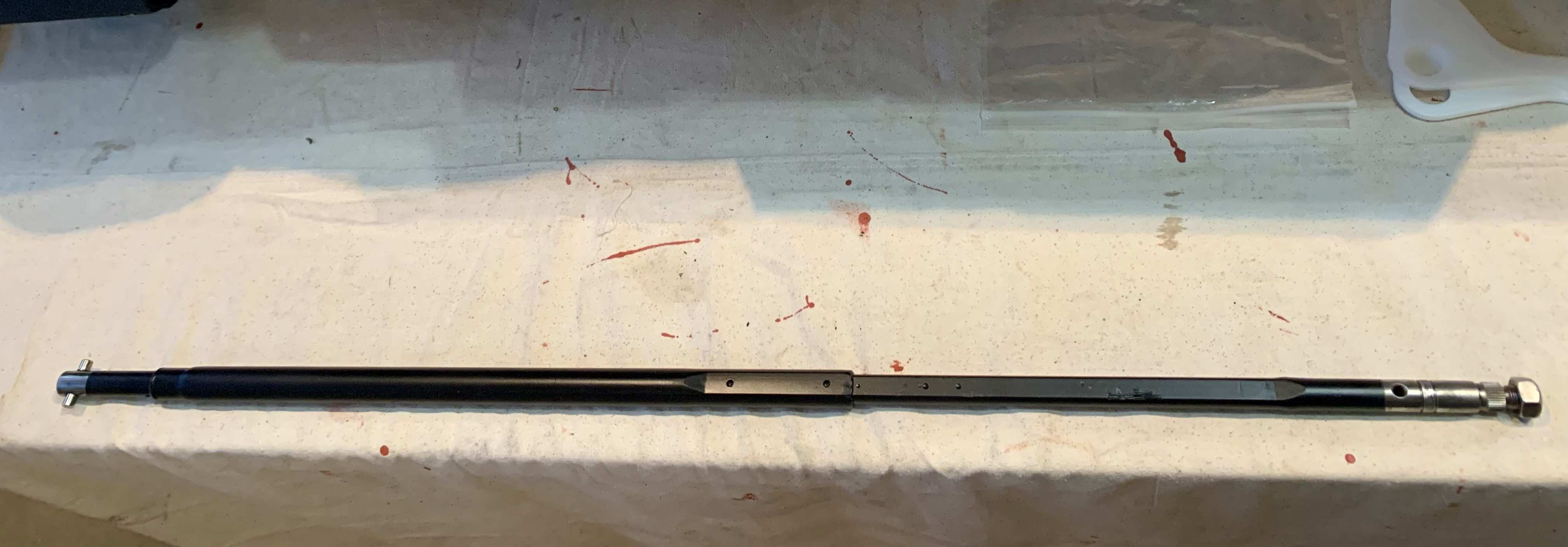

Right. So in this case with a manual column, the shaft, which is comprised of two pieces, should currently be somewhere around 43 1/8" as in the pic above. To make it the same as an original power steering shaft you'll only need to tap on one end to collapse it to 40 3/4" and you should be good to go to. If the two pieces are moving back and forth too freely then you'll want to use something to help prevent movement as in the links above.
