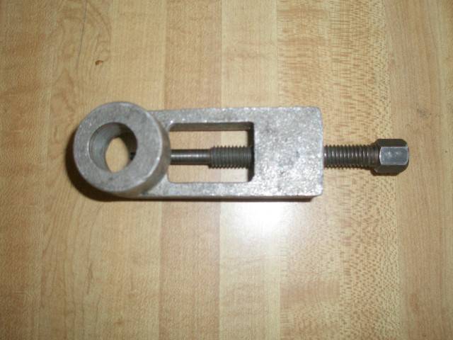

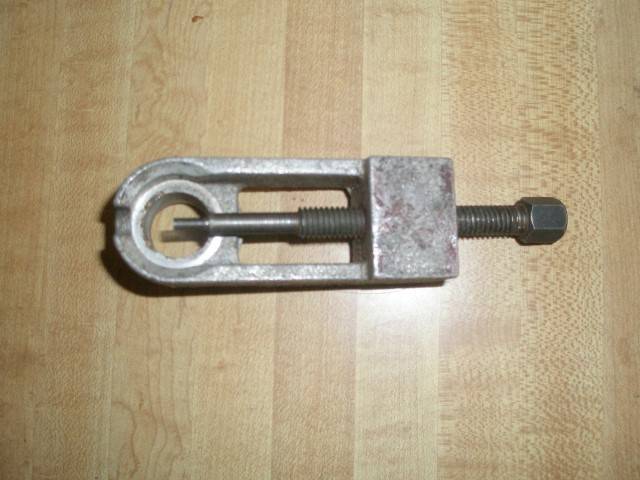

Has anyone used or know where to locate this tool.... C-4113U Steering Lock Plate Pin Removal Tool?????

Tool has been obsolete for decades.
Finding one is probably from old, retired, auto mechanics like myself, that have been around, repairing Mopars, since the 70's.
Keep looking Miller Special Tools on ebay.
You never know what shows up on that site.
(And no, my old tool isn't for sale)

Thanks for the info.....haven't found one yet, but was able to tap out the pin without damage to the steering column. Ill keep an eye out...maybe one of those tools will pop up someday.
