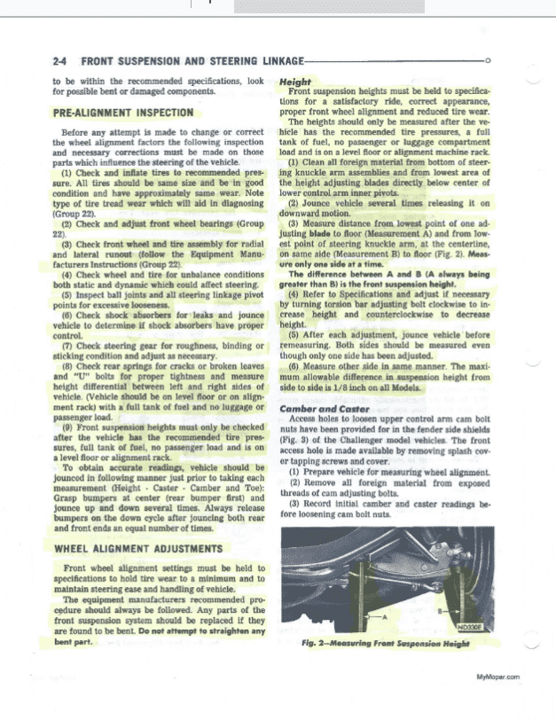

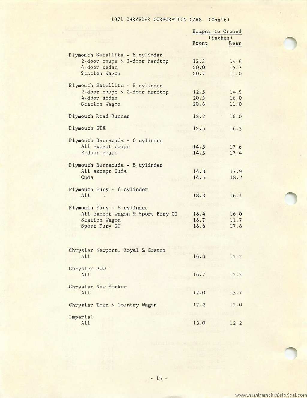

Hello,
Just wanted to see if someone could give me an idea of the stock body angle from front to rear. I've got nowhere near stock suspension anymore, but I want to have my car at an angle as close to stock as possible when testing ATF levels and what not.
Thanks in advance
