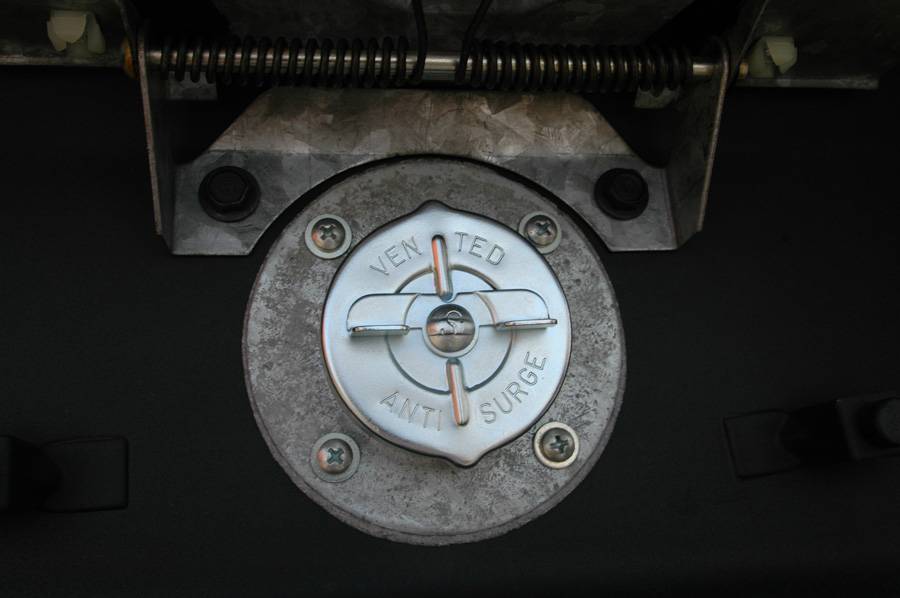

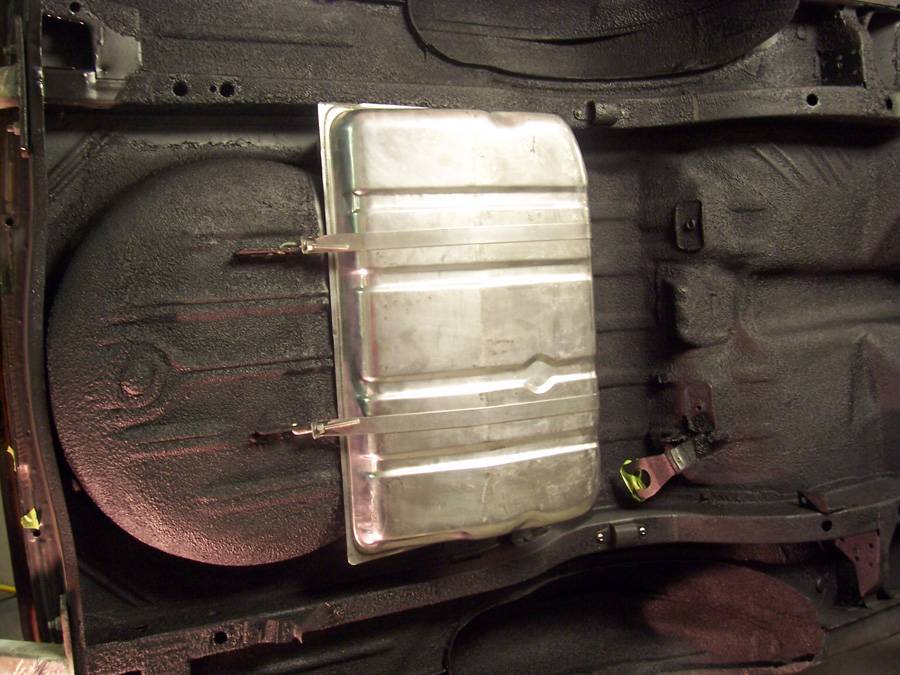

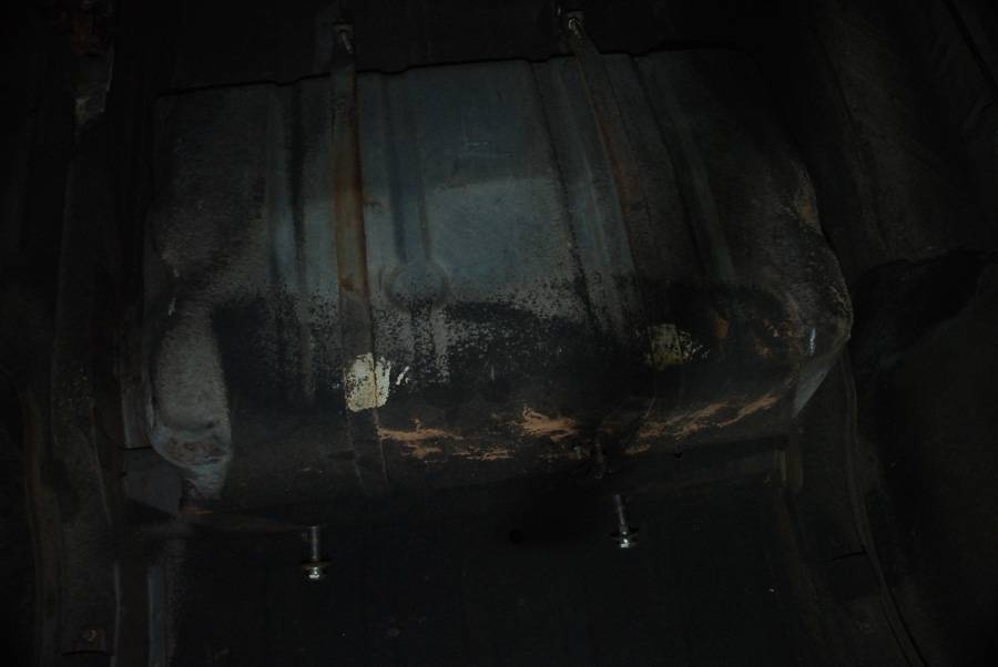

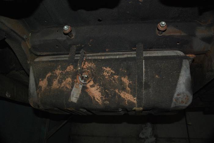

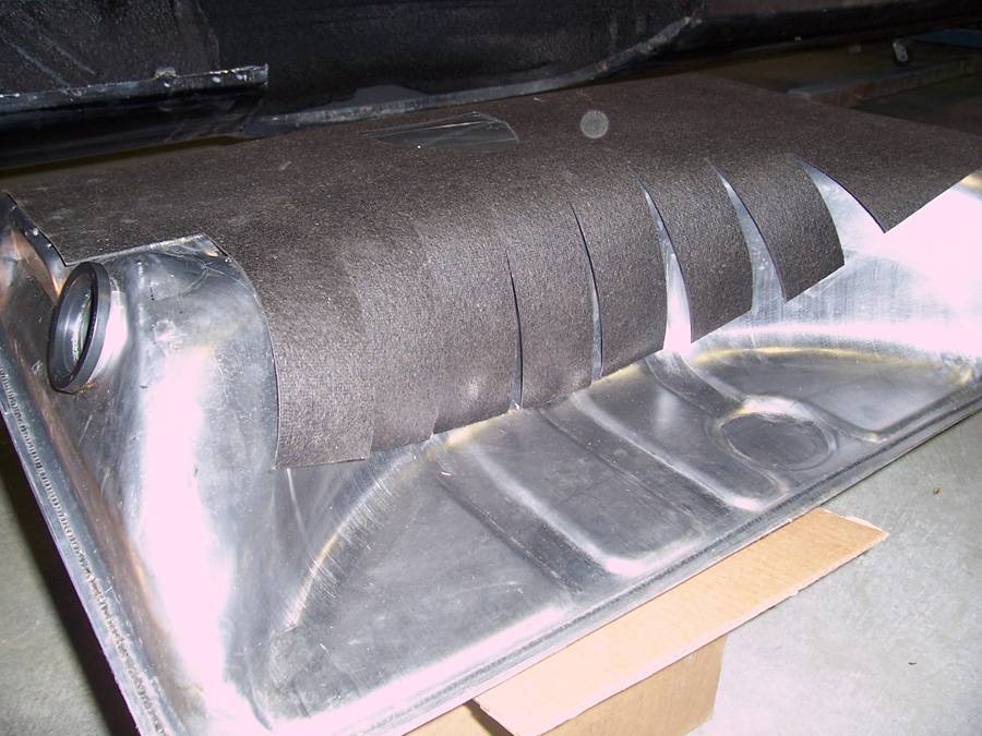

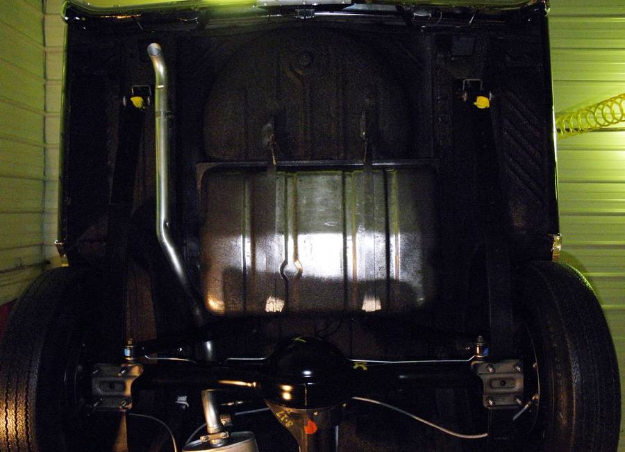

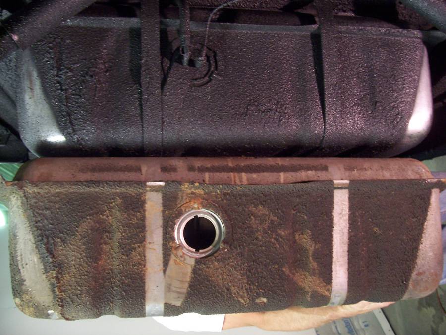

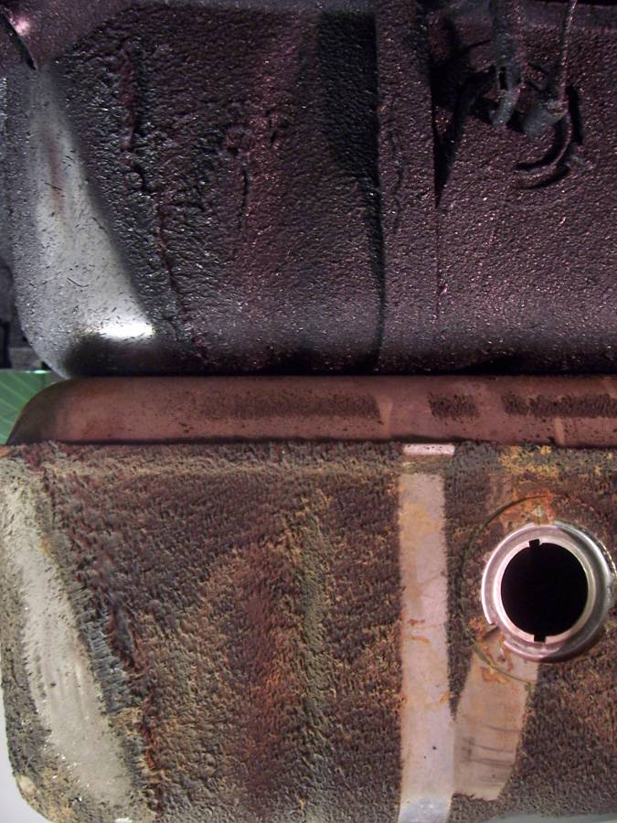

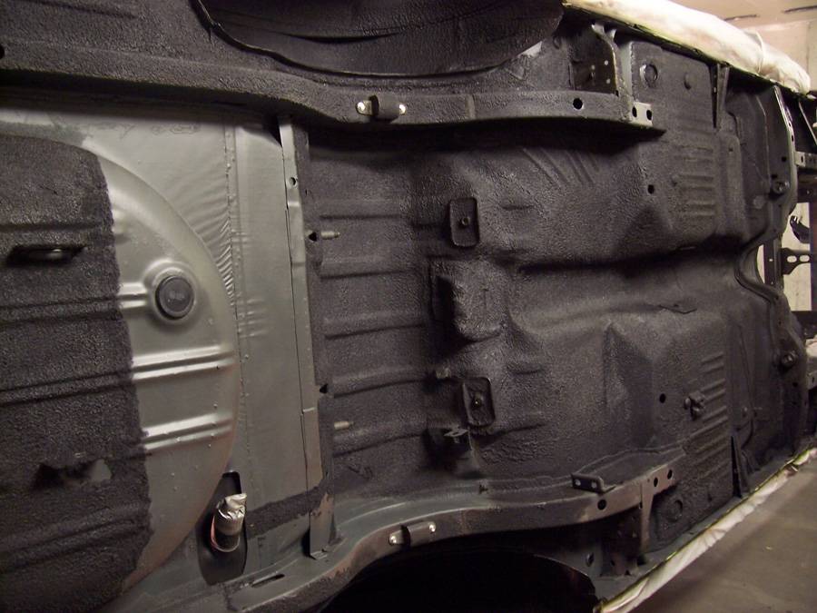

Here are as series of photos that illustrate the measures we had to take in order to match the Factory Undercoat patterns. I replaced the original Gas Tank with an NOS unit and had the challenge of matching its old undercoat patterns. Just for this one particular area, three methods were used to obtain the desired results. The undercoat mixture had to be applied at varying viscosity depending on the method we were using. Again, the trick to ANY procedure is to make it appear as if it was done by the Factory. Too many OE vehicles exhibit manipulated patterns that contradict the natural physics of an Assembly Line appearance. You have to keep close tabs on where you are at in the process or the appearances of sprayed materials will look phoney!
Original Gas Tank and Undercoat Pattern
NOS Gas Tank
Underside W/O Gas tank installed
NOS Tank in place, ready for Undercoat coverage
Before & After Comparison
Before & After Comparison - Notice "wave" in Undercoat pattern due to pressurized spray
Gas Tank & Undercoat completed
resq302
Aug 20, 2013
111
11
Dave,
Was the old tank badly rusted? Why did you chose to replace it with an NOS vs. restoring the old tank?
ECS
May 4, 2012
354
54
Dave,
There was some surface rust in a few spots on the galvanizing and it ate into the metal surface. There was no way to make it look new again so when I found that NOS tank, I jumped at the chance to buy it. The condition of the NOS tank was pristine and provided a new look for that particular part of the restoration.

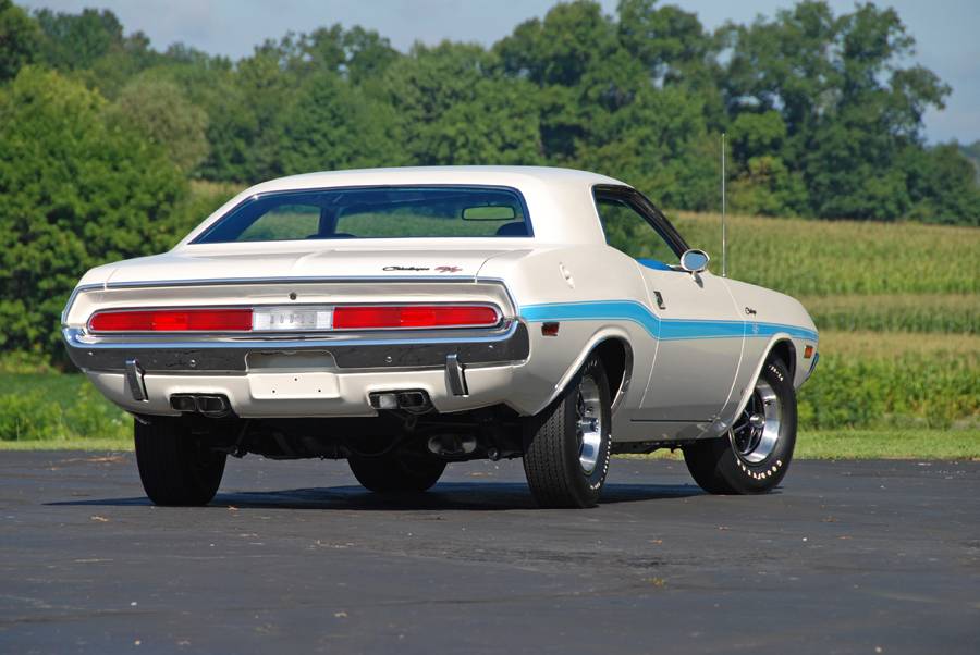

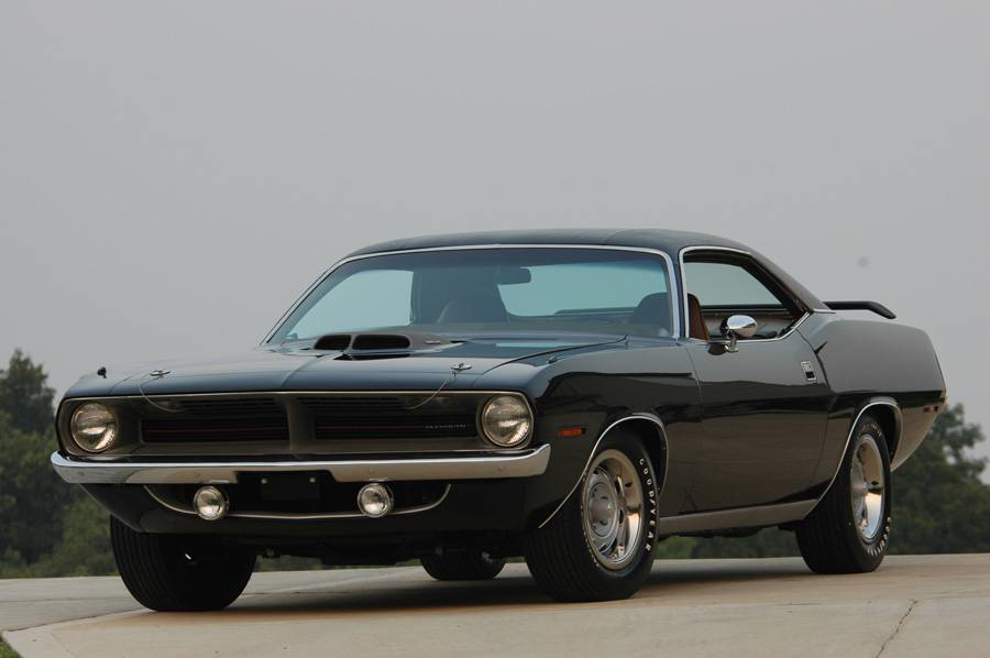

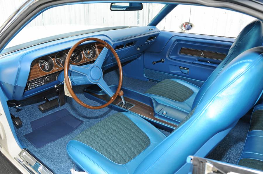

Here are a few photos of the "GROUND UP" 1970 Challenger Restoration. There we many challenges in making this vehicle look Assembly Line New again but it did not have the same level difficulty as restoring the 1970 Valiant Survivor. The final results of the two cars were the same but the processes to get them there were quite a bit different.

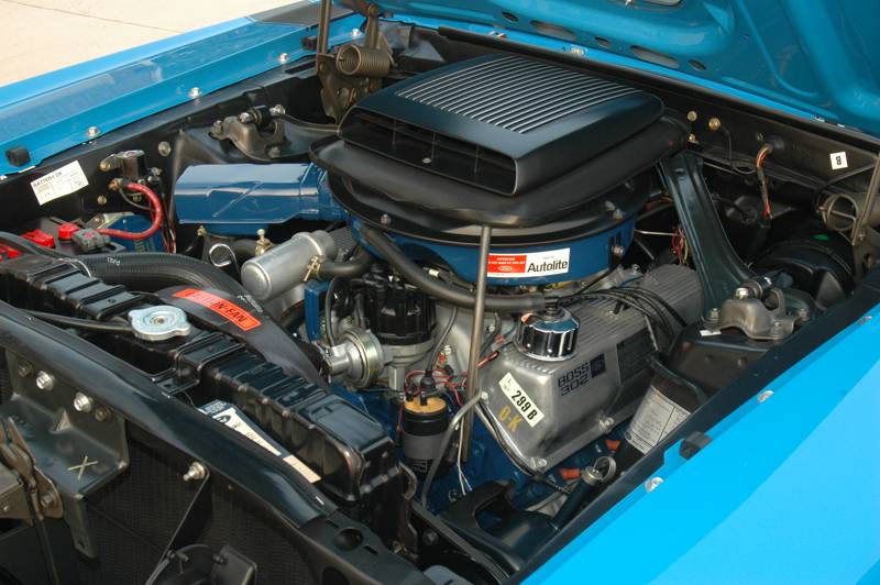

Thank you for your comment! I have a few vehicles that we have restored to this level. The great part was being involved with everyone of them and assisting with the work. Steve Been and I restored the Cuda in 2004 and Dave Stuart & Tom Barcroft got involved (late) with the Challenger Restoration in 2007. Also included in the group of photos below is my 1970 Mustang. I did that vehicle by myself in 1999 prior to meeting and working with the other Guys.

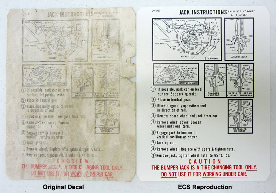

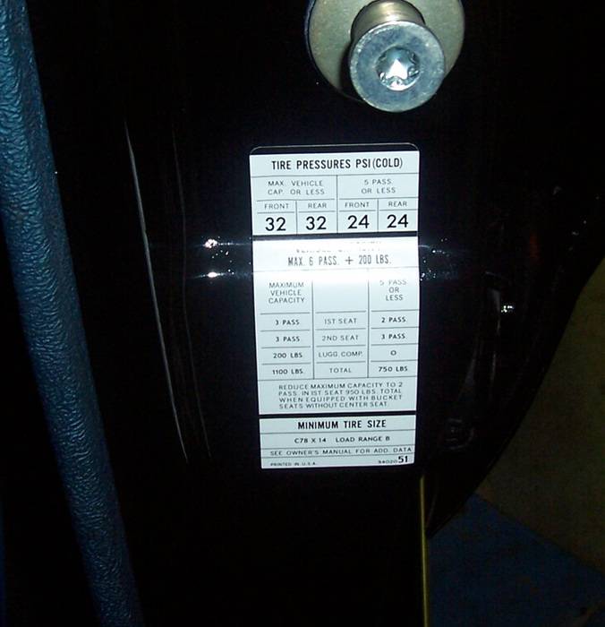

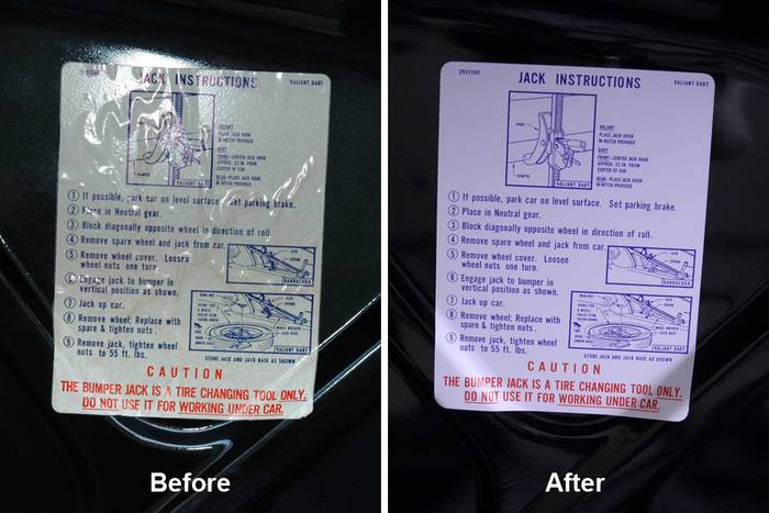

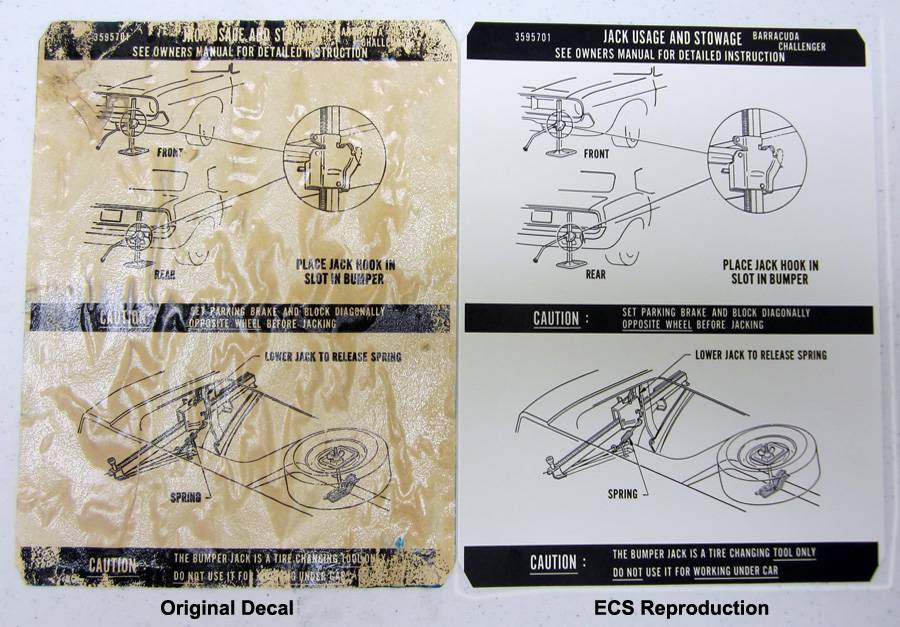

Here are a few comparisons of the various Decals that we manufacture to match the Factory originals for these Chrysler cars.
Before
After
ECS Reproduction VIN Decals
ECS Reproduction - New Vehicle Decal Assortment

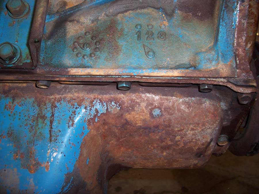

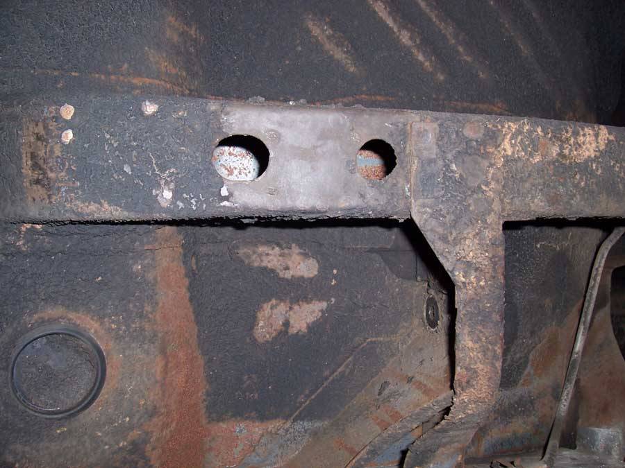

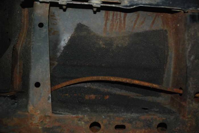

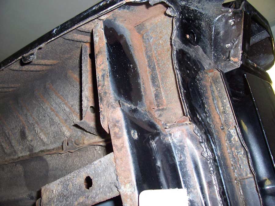

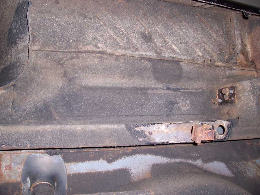

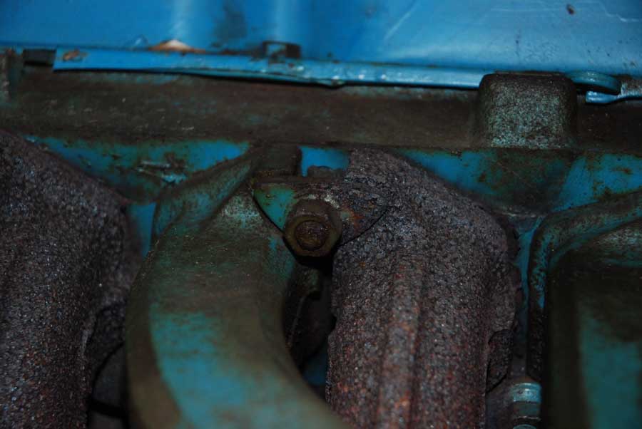

Here are a few additional pictures showing the condition of the 10,600 mile Valiant prior its the Restoration. Keep in mind that no sandblasting was done anywhere on the car to remove the rust! All oxidation was (patiently) removed with chemicals and tons of elbow grease.

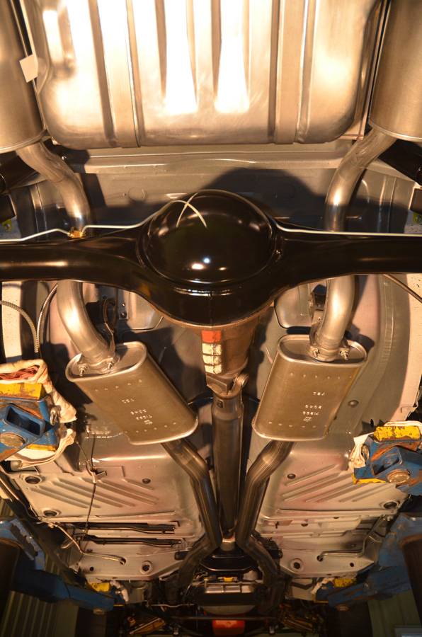

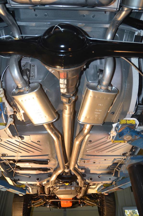

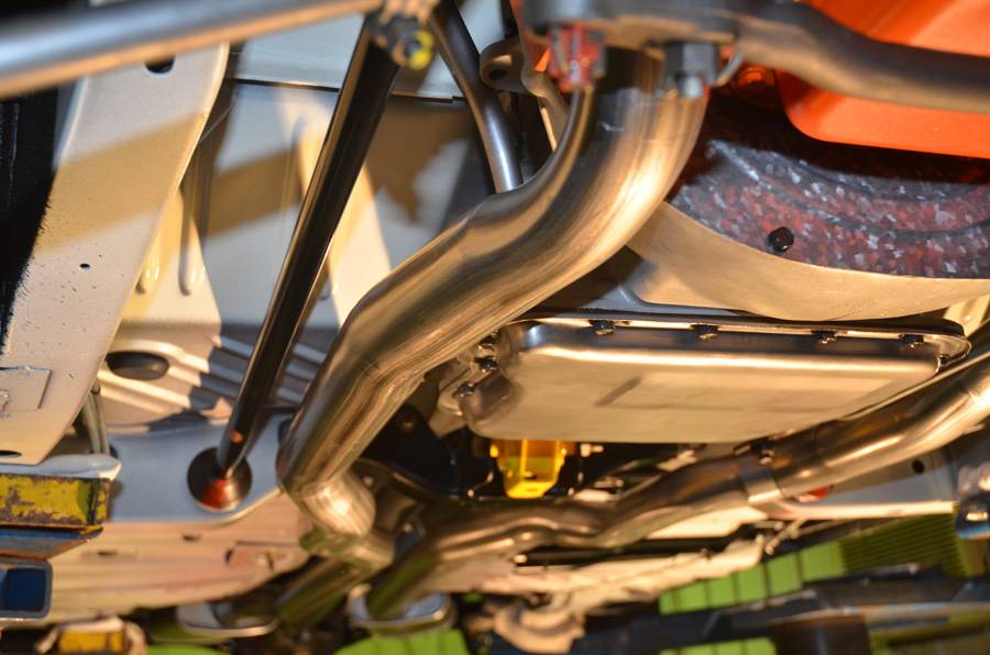

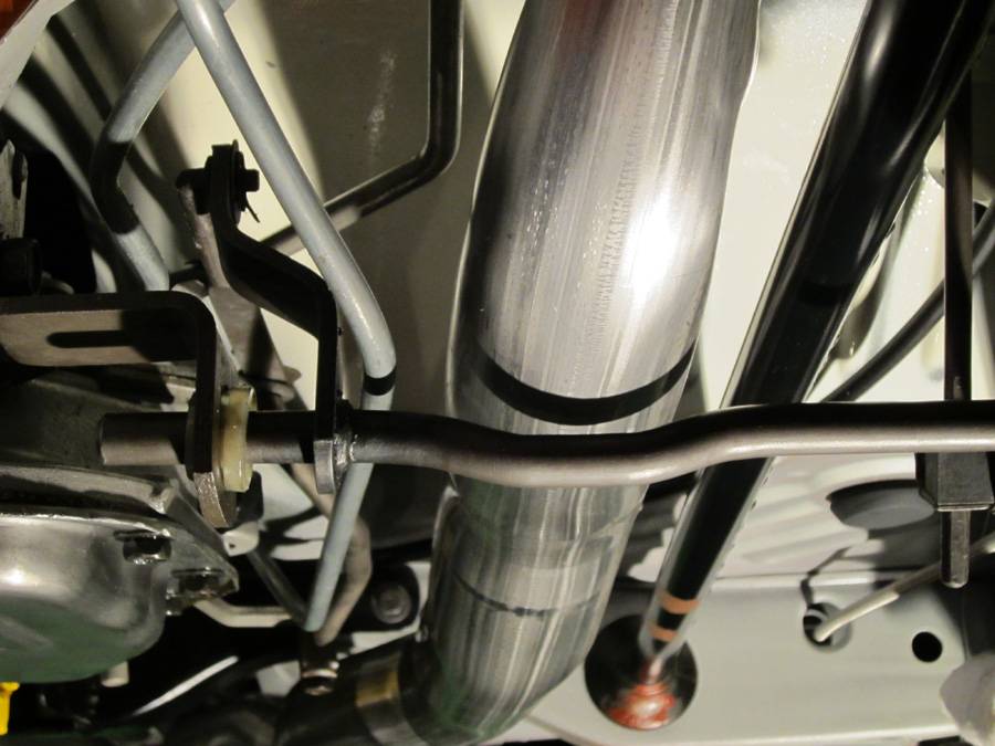

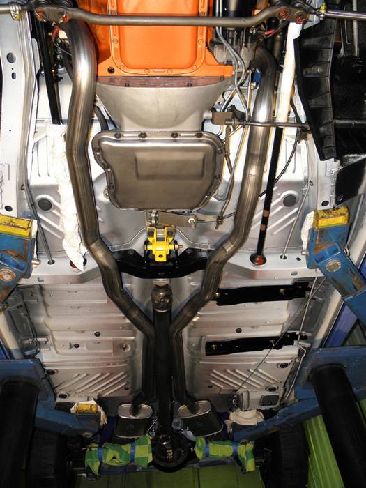

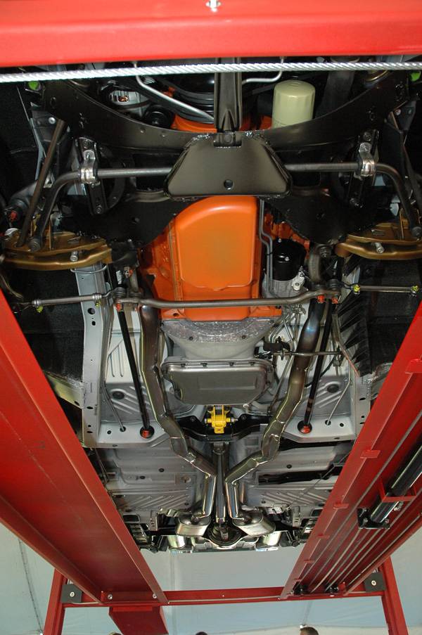

Here are a few photos of the "NEW" ECS Factory Exact Exhaust System that we just replaced on the Challenger project.
