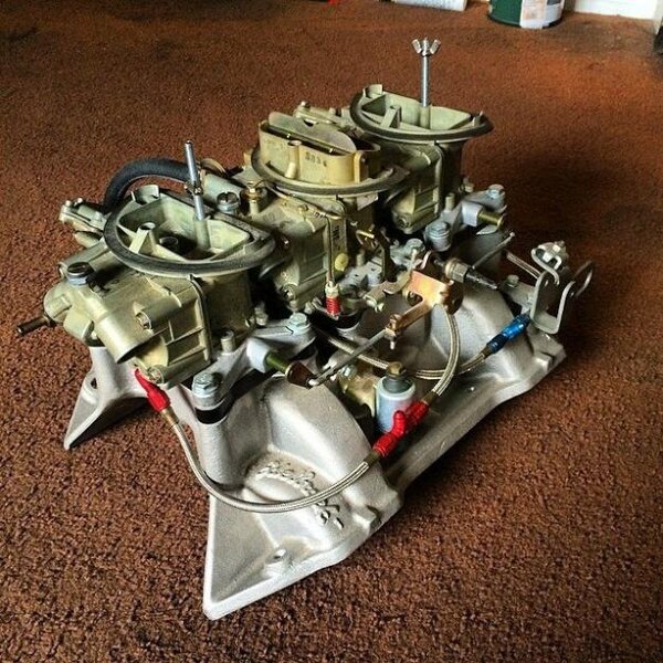

Six pack carbs edelbrock manifold.

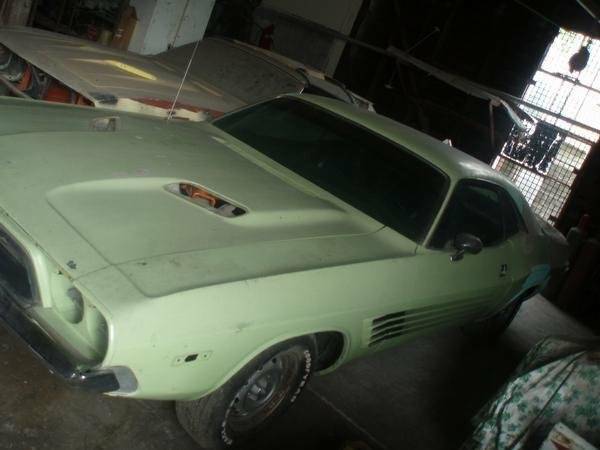

Welcome to the site from the Motor City! What's it going in? Got any pics?

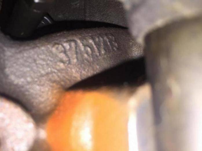

if you wright down the casting #s from the heads the tec people should be able to tell what you have for original c c combustion chambers, and ya what are you putting this in.
