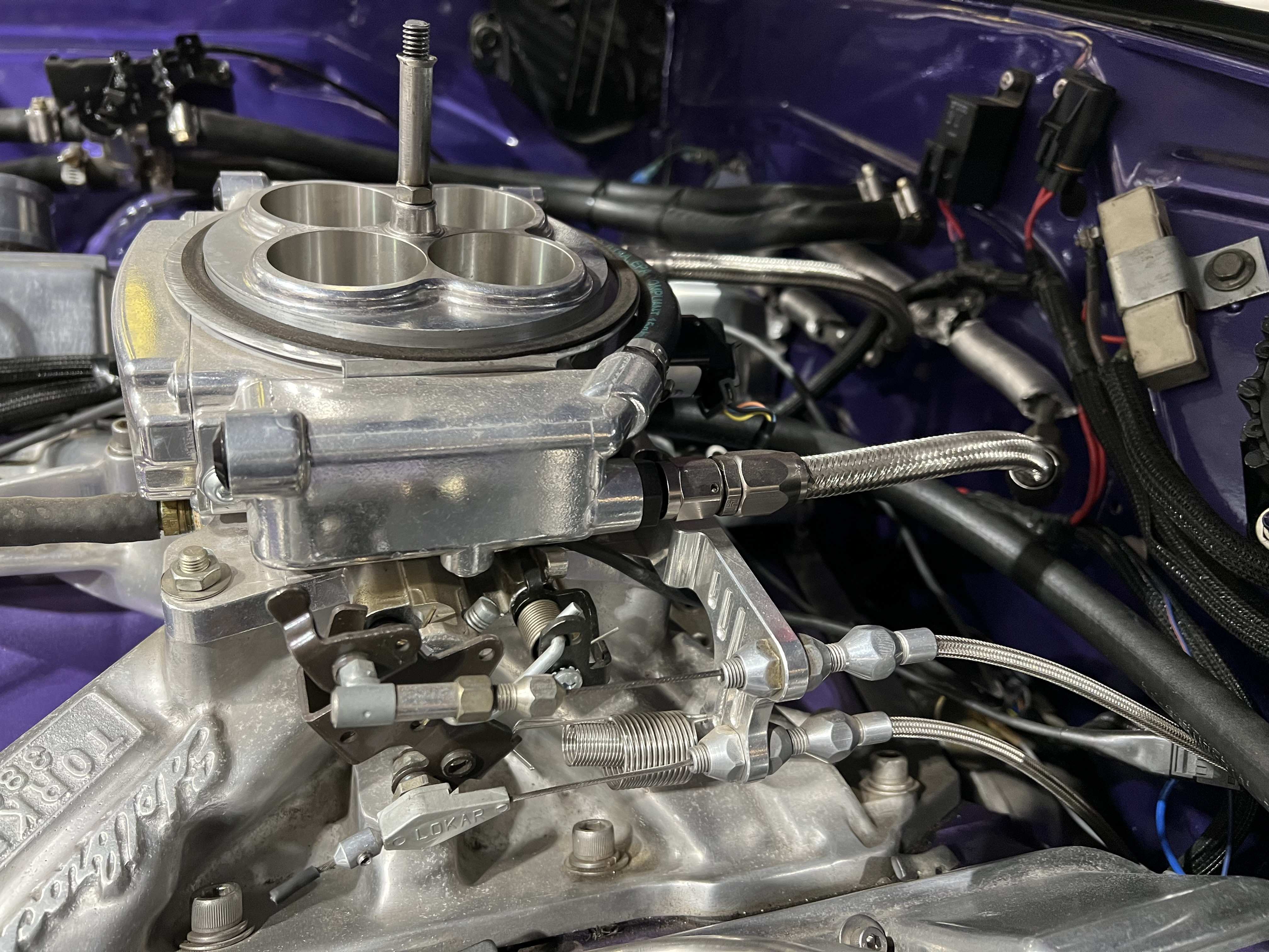

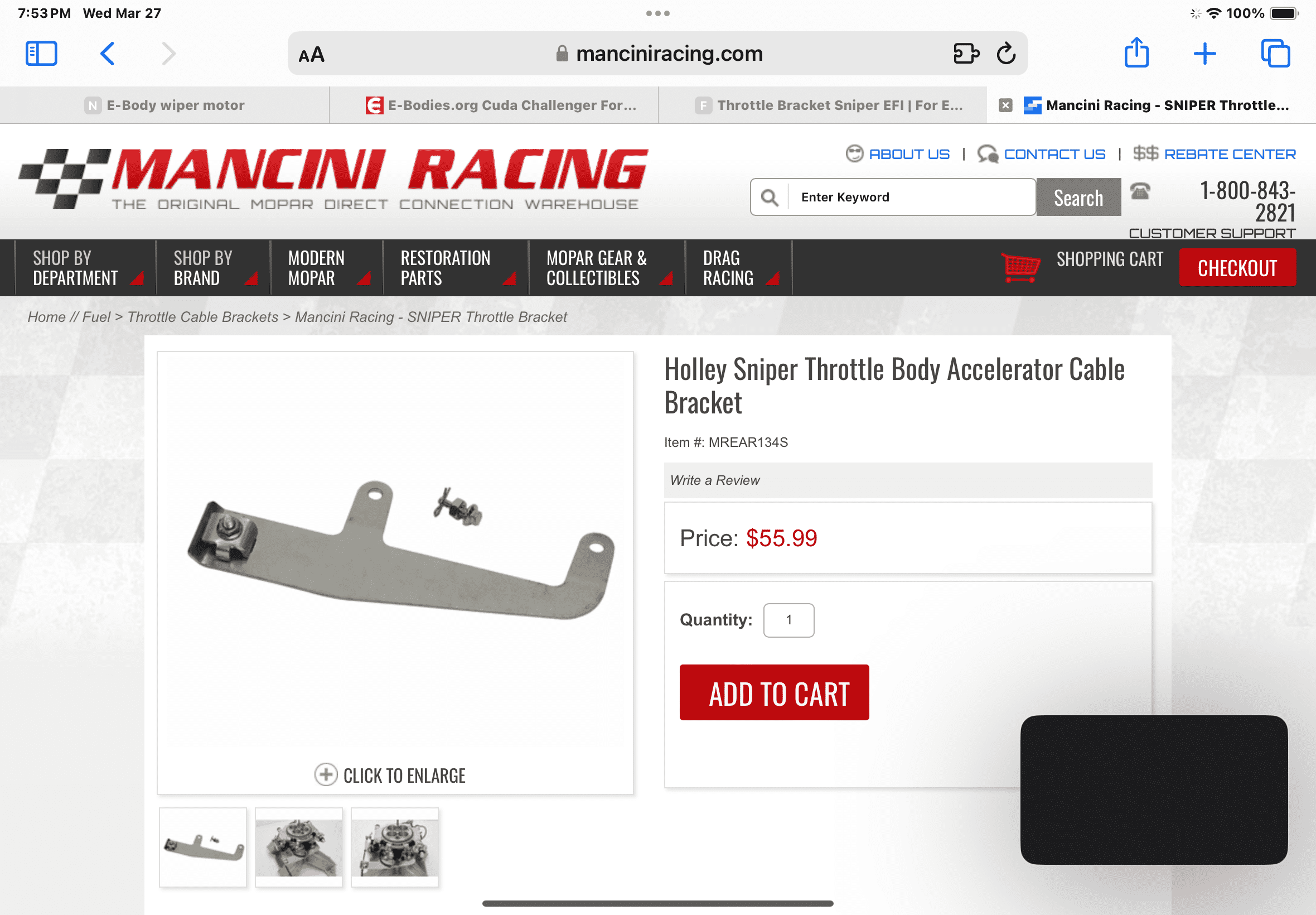

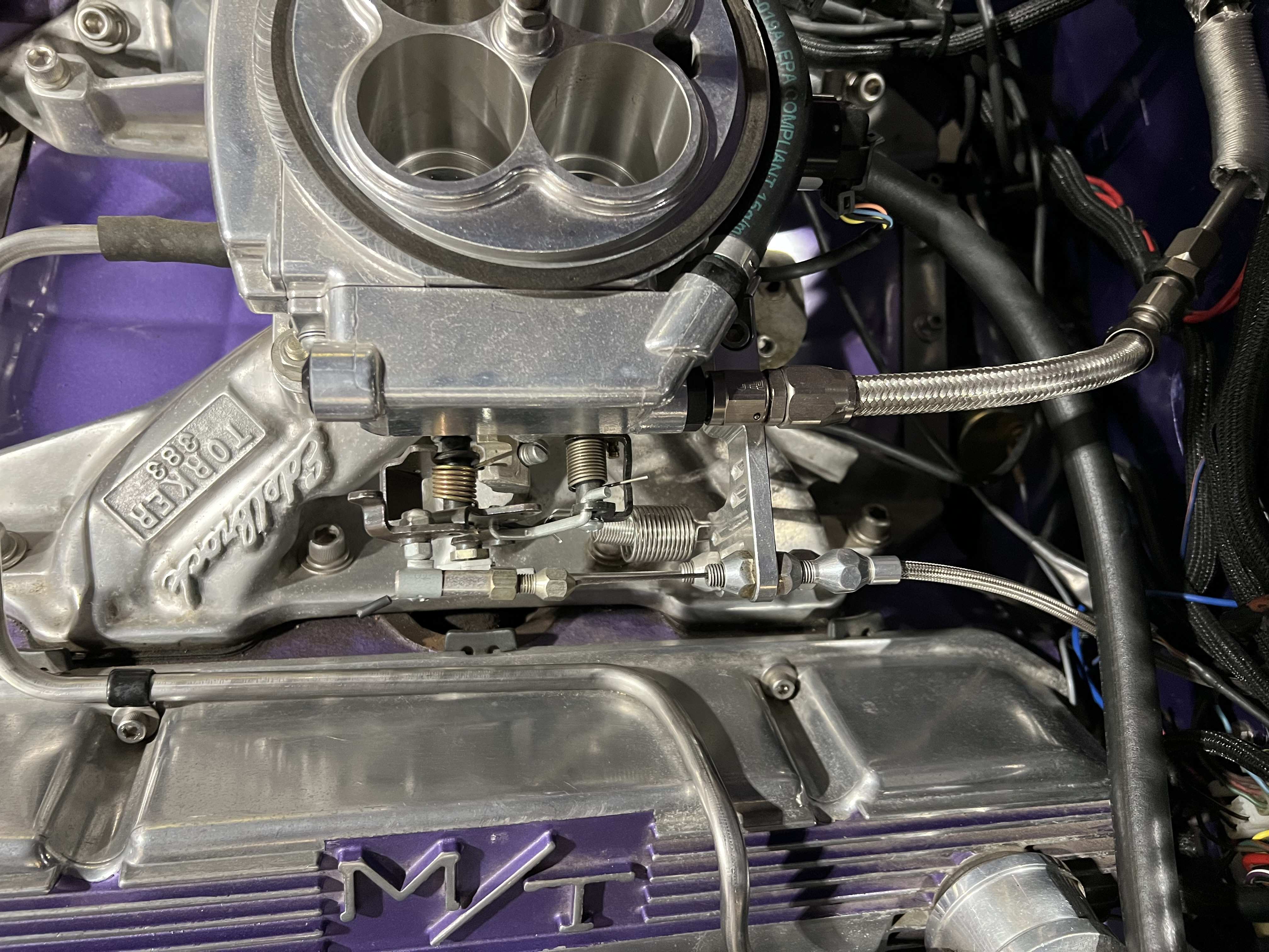

This is what I used. It’s for a sniper 1 that has the wires coming out of the front so I needed to make a small notch in bracket to fit on sniper 2
