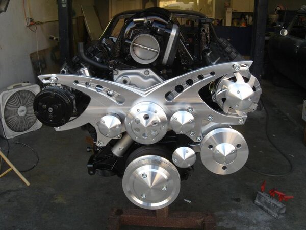

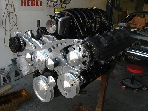

I agree with Leo. You should build something that people are interested in to be selected. I would go with a 6.1 hemi with the March pulley set up. I just built one for a customer. Use the fuel injection and all the parts that go with it. It is a lot of changes and they are not beyond most people. For a transmission go with the Tremec 5 speed or a Viper 6 speed. Go with 4 wheel disc brakes and aftermarket a/c. I like Vintage Air the best. Use a body stiffening kit and any good aftermarket suspension. There are a few out there now. I know you like the older engines. It is not what people are asking for anymore. The 6.1 roughly feels like a stock 440 with the fuel economy of a 340. I have liked the new hemi with everything I have done to it. Also big disc brakes won't fit in 16 inch wheels. 16's are the new 14's. They are plain passenger car wheels. You can get 17 and 18 inch tires that don't give you the rubber band look on the rim. I hear people say "This is a muscle car. I don't care about mileage". Trust me, people will when it costs $40 to go to a car show and back with the big block or large cube small block. Gas will continue to rise in prices. Build a car that you can use for years. DSC02969.jpg6.1 1.JPG
