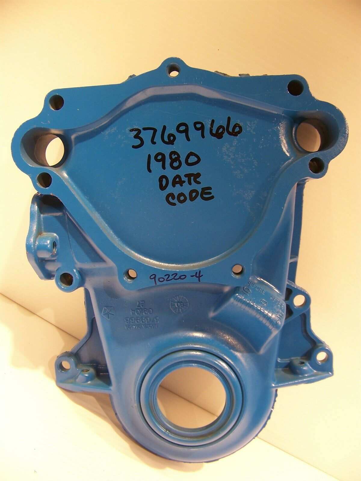

I found the two part numbers of the timing covers online and posted below. Looks like the timing mark is the same and once installed, no one will likely know the difference.
