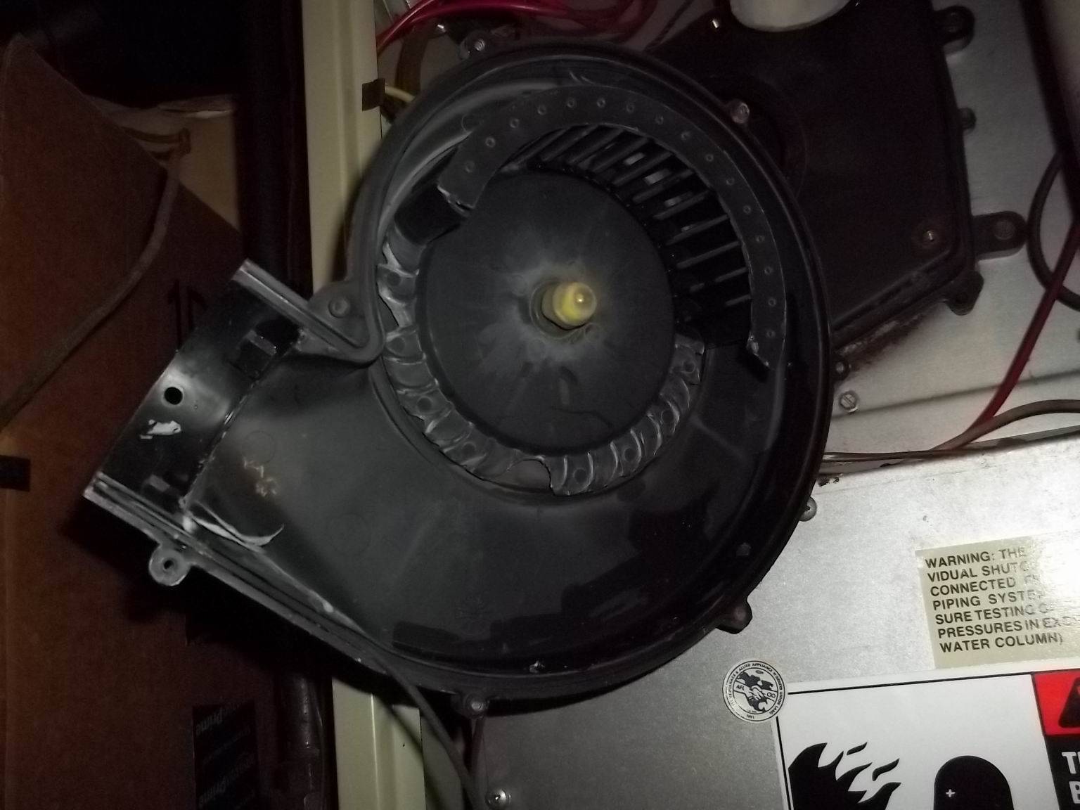

I was getting ready to go out and replace the cad-cell relay in my defunct garage furnace so I could get back to working on my Challenger when a horrible sound started emanating from my basement. I thought I recognized it immediately, but I was a bit off the mark. I went down to investigate and it was, indeed, the house furnace making the racket. I thought it was the blower, but it turns out it's the inducer for the power vent. The motor was hot, but it didn't sound like a bearing. I shut it down and called a friend who happens to be a long-time HVAC guy, and he suspects the impeller lost a blade and went out of balance rather than a bearing failure. Either way, I'm without heat for the moment since running it eventually will kill the motor.
I say "Timing is everything" because it's a positively-balmy 26°F outside right now, with plenty of sunshine and highs in the mid-upper 30s and even the low 40s forecast for the next few days. Had this happened a week ago, when the high was 2° and overnight lows were near -30, things would've been a bit more dire. I decided years ago to live simply, which is another bonus--it doesn't take much to heat a 650-square-foot house.

I am going to pull the old inducer and inspect the damage. If it's indeed a missing fin and the hub's not shot, I may take a shot at removing an opposite fin in the hopes of a redneck re-balance. It's only got to last a couple of days. 😁
Removing the opposite fin is a brilliant idea!
I have come across a missing fin problem a few times in the shop, but balancing it by removing the opposite fin never occurred to me.🤔

Thanks! Lke I said, it's not a permanent solution but it might get me by for a couple of days. The house is back up to 69° already, so if it doesn't work it's no emergency.

So much for the "redneck re-balance" idea, at least in this case. 😑
