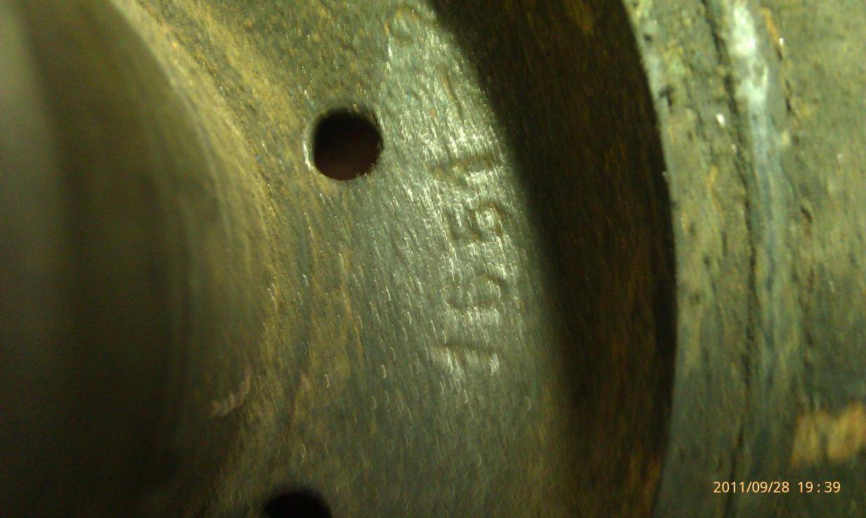

if the crank has thin parting lines & squared counter weights it will be cast but should have an offset damper on the front .
if it has wide parting lines & rounded counter weights it is a steel crank , post a pic when you get time .

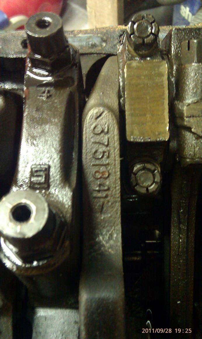

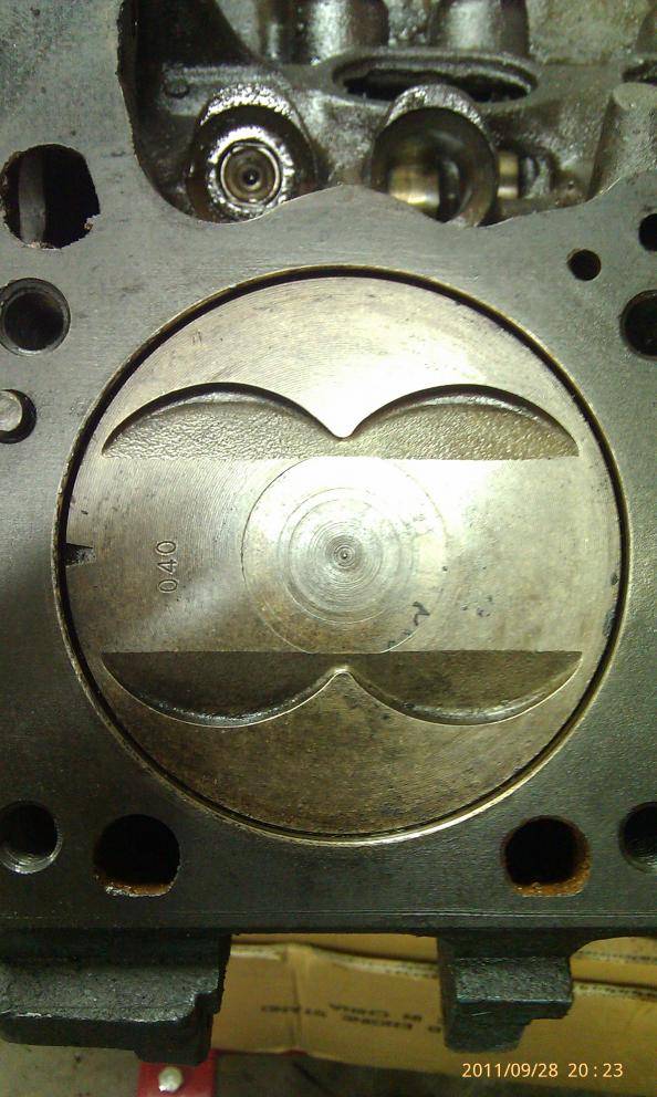

Here's a few pics. Looks like a cast crank but forged dampener. Bores look fair. They have a little rust here and there that cleans easily. A quick hone may fix that. Thinking about bearings, rings, and a hone. Then build the top with new can package and have the heads done with new valves.

the forged cranks do not have a # on them unless it is stamped into it , just part of the process to create the crank , the fact that is has a number Cast into it makes it a cast crank
