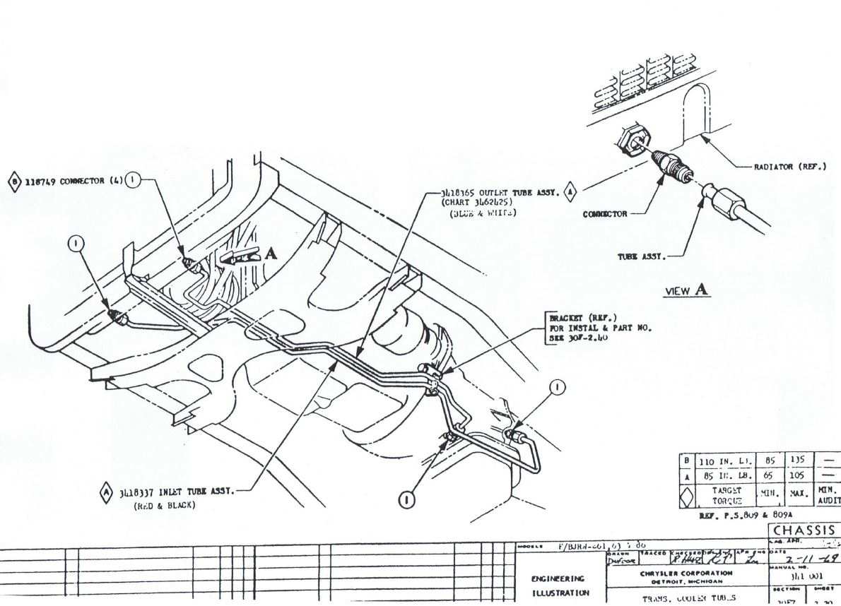

The fitting closest to the front of the transmission is the fluid out to the radiator and the one towards the tail housing is the fluid in from the radiator. On the radiator the driver's side is usually the "in" from the transmission and the passenger's side is the "out" to the transmission. I tried to find a good picture but only found this.

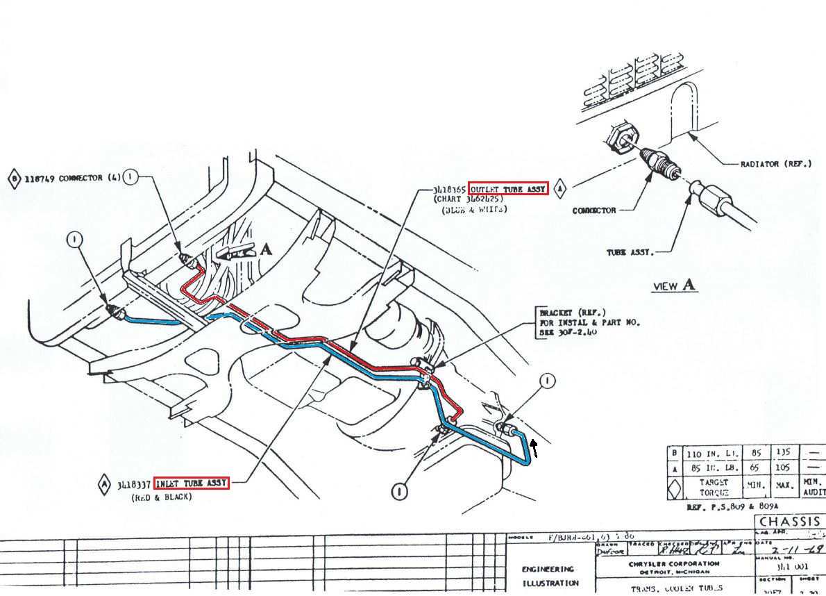

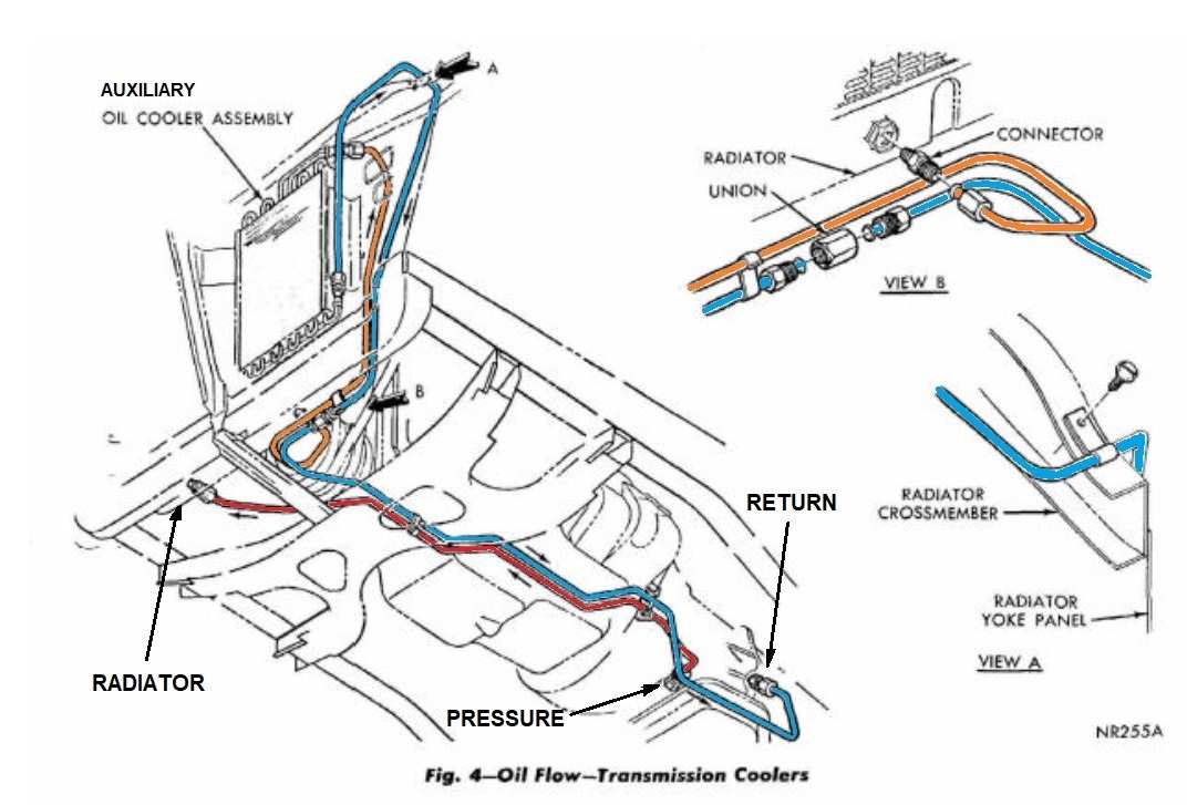

I figured it would help if I added color to the cooler lines for the drawings in my files. Transmission Pressure OUTLET in RED and Return INLET in LIGHT BLUE. The Auxiliary Transmission Cooler diagram is the factory routing with ORANGE as the cooler line from the Radiator to the Auxiliary Cooler's INLET.
FYI - "The factory always routed the tranny fluid first through the radiator's oil-to-water cooler, then through the auxiliary oil-to-air unit. You should, too." - Richard Ehrenberg, MOPAR ACTION MAGAZINE
