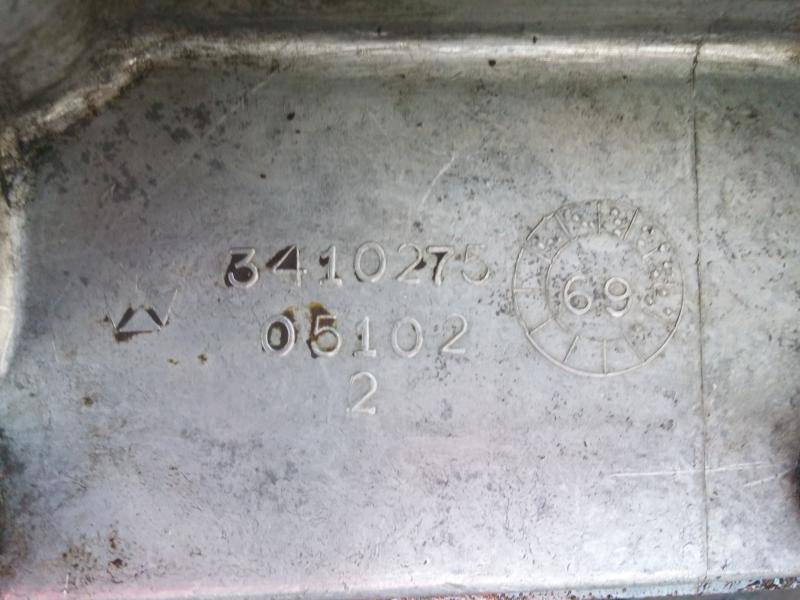

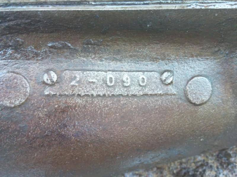

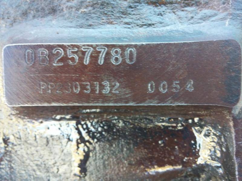

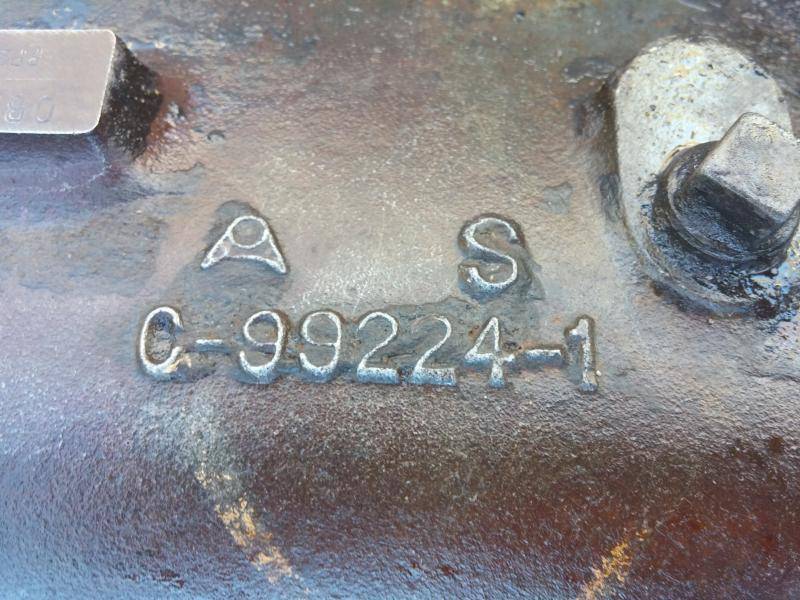

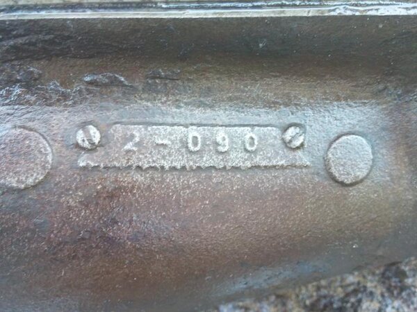

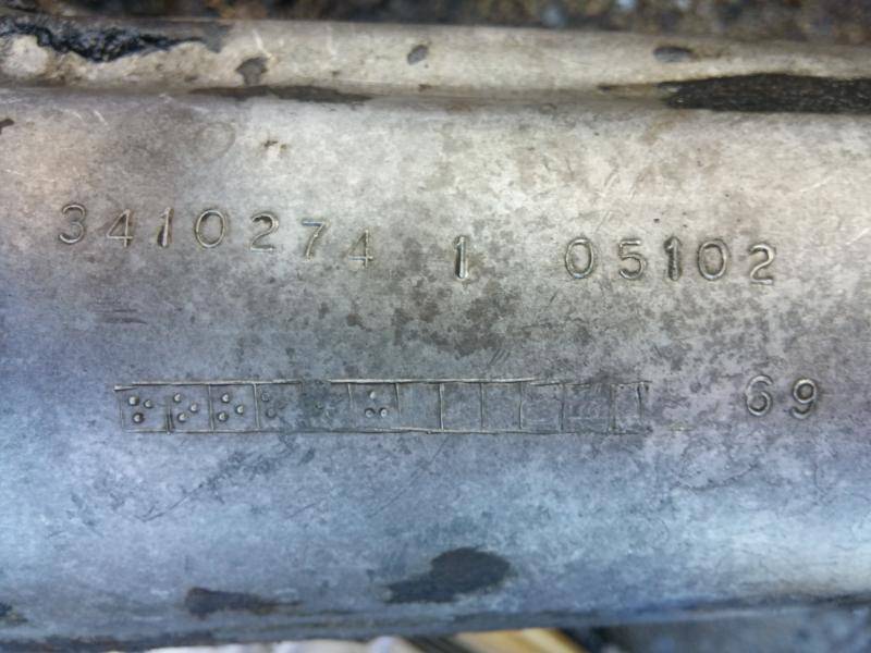

Im getting confused on where or what rebuild kit i need for my Trans. I have a 1970 barracuda with a three speed on the floor. 318 car. I have the casting numbers if that helps.

Well as i call numerous suppliers the kit is proving to be quite rare. Its almost like the a-230 is a dying breed. people list it but its out of stock everywhere
