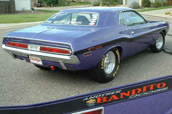

My '70 Challenger (all steel street legal with the glass hood only - and its heavy when compared to most glass hoods). Same as car mentioned and tips the scales at 3125 w/o driver. This car is a 346 (bored .030), 13.2-1 comp., ported/polished W2 heads on R3 block w/904 and 4.88s - runs mid 11s @5,800' in Denver and low 11's in Salt Lake City. The car has full interior (roll bar, trunk/compartment pan and carpet the same weight as rear seat that was removed). Manual crank window assemblies were traded for elect units that weighted 7 oz. less per window and so on. If your wanting to go fast with a small block everything removed or added needs to be checked, your weight is one of your biggest battles in E-Bodies. And that's just the beginning of spending spending and more spending to go fast, it's a sickness that I haven't shaken in over 50 years of "petal to the metal" on the strip.

My '70 Challenger has been a race car much of its life, when purchased it weighted in at 3422 lbs. race ready with back seat legal G/SA that ran in the 11.70s in Brainerd MN. When first tested off the trailer, same weight just 1000' higher in Denver CO it was a second slower running 12.70s. The factors for height and class told me this wasn't going to work.
Have a friend that builds Mopars race cars and collectors, had him start going through the car. Finally decided to take it down media blast and bring up to today standards as a Pro ET car or Super Stock car, after mini tubbing it was illegal for Stock. Anyway completely bare no under coating, insulation or sound reducing materials left the car was primed then POR-15 on the under carriage, rebuilt the front end with poly bushings, Wildwood discs, bearing replaced, the heavy Super Stock springs with Cal Trac system and so on. It's as light as NHRA/IHRA will allow for Super Stock E-Bodies, they questioned the grill change to a '71 (they're 9 lbs, lighter), the replacement dash was questioned but approved. Built the car to run in either class mentioned with motor changes (Pro ET is by far less expensive than a good Super Stock motor). I sold the original interior, seats, carpet, visors and dash and replaced them with lighter seats and carpet with no felt backing. I don't want to drag this out to long but we are as light as we can get to be legal for the SS class at 3125 lbs.

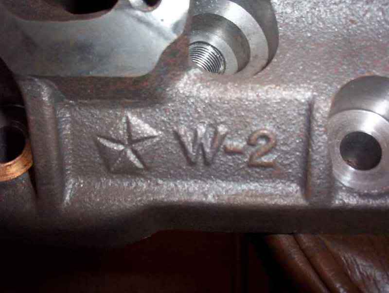

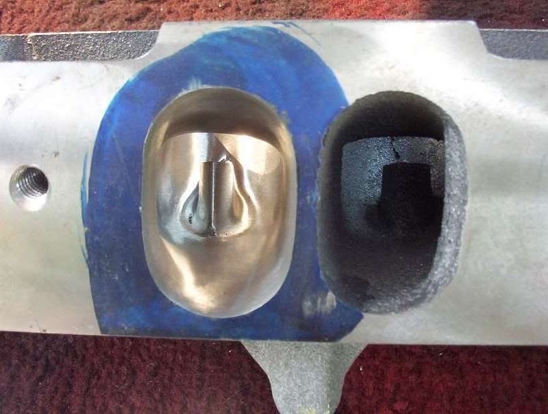

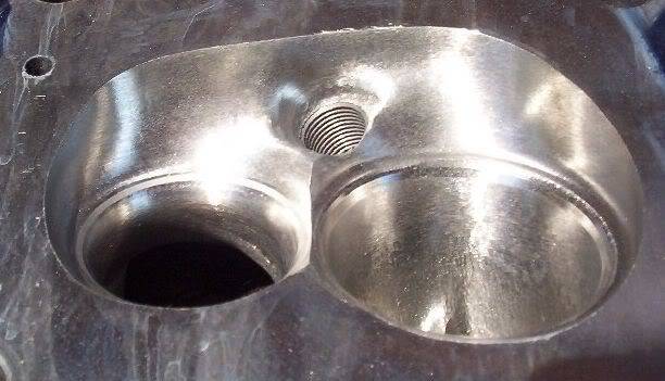

Who's going to open up those little ports, they need some work by a professional. If you don't know what your doing in this area its worth finding a shop with a CNC machine that does this type of work. Shadey Dell in PA or Indy Cyl do excellent work at fair prices.
This set was done by Mad Cap in Denver, these Mopar W-2 heads flow the same as the CNC Indy heads just heavier.

I had my heads are ported professionally i took that pic when i first pulled them out of the box and the air gap intake is being port matched to the heads now but i don't know if the will flow as good as your w2 heads tho. I want to have my car weighted at a different scale 3065 seems a bit light I would agree and it’s very possible that the scale could have been off. I am just trying to pool more money to finish my project right now I have got $6000 in it right now but its all good I love the car to much to let it go. And i love the 70 Challenger projectmopar glad to see some guys run their mopars !
