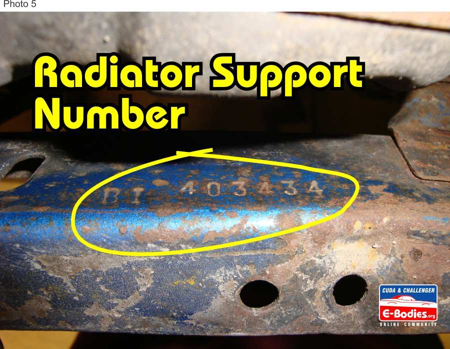

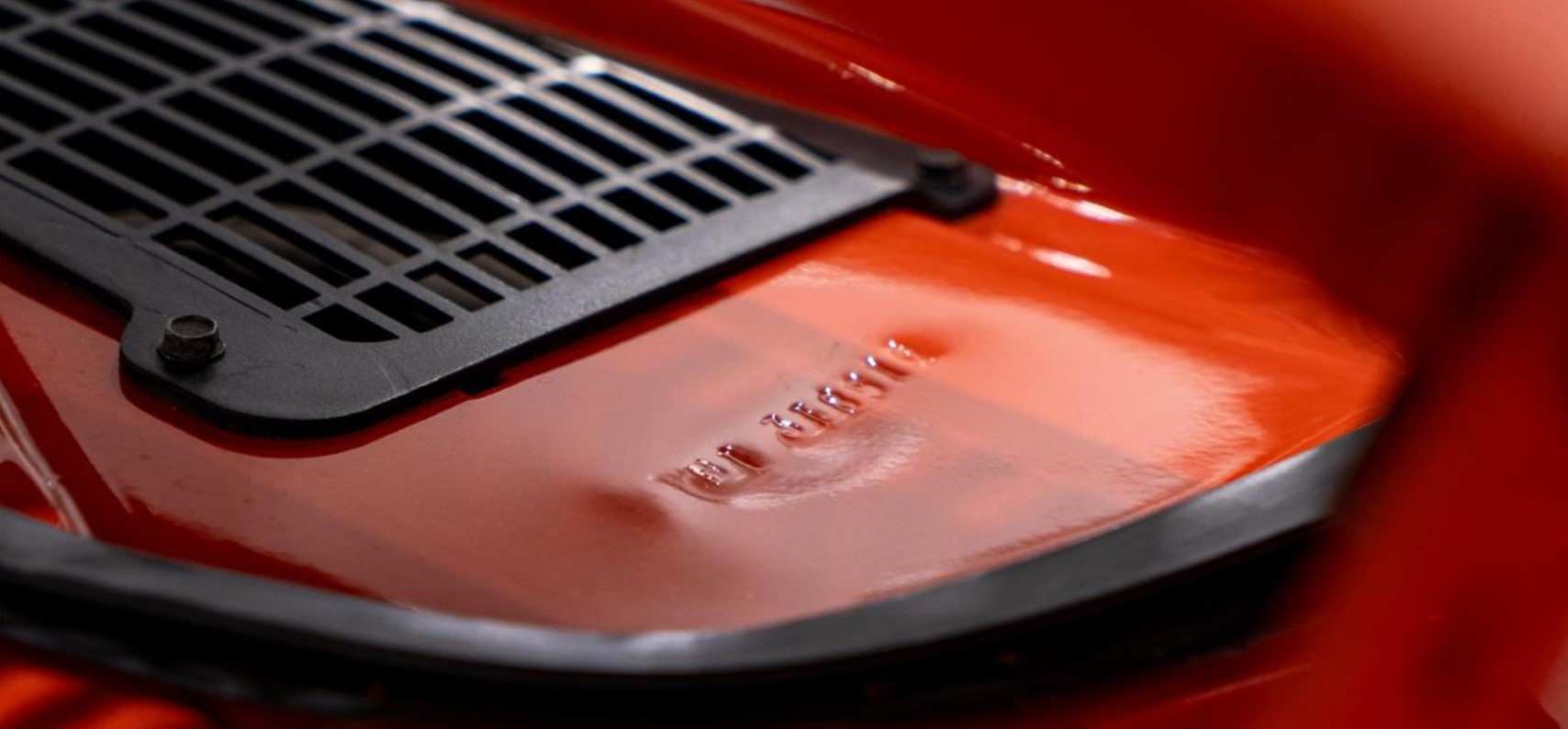

Other VIN locations. INFO HERE.
  1. Title
  2. Dash VIN
  3. Cowl VIN Serial Number
  4. Radiator VIN Serial Number
  5. Engine VIN Serial Number
  6. Transmission VIN Serial Number
  7. Fender Tag VIN
  8. Broadcast Sheet VIN
  9. Door Mylar Data VIN Decal
  10. Window Sticker VIN
