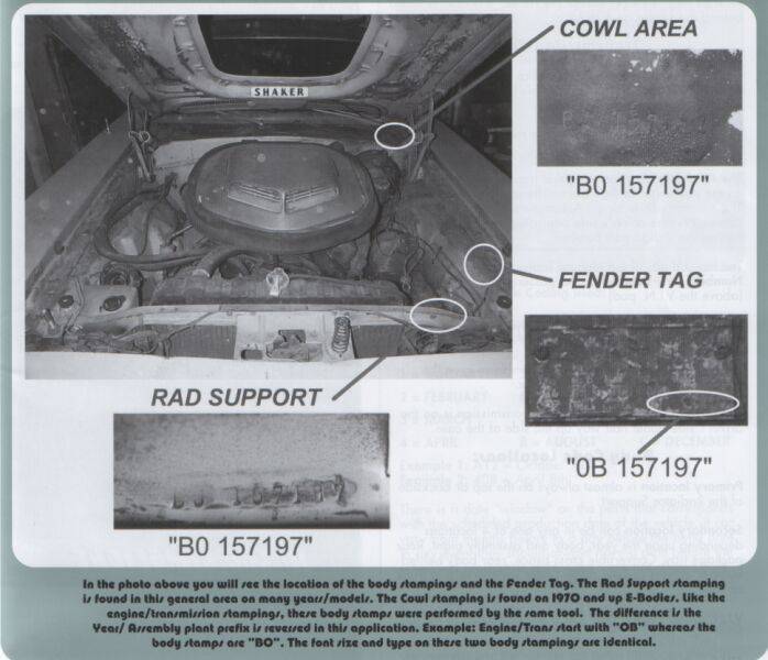

I recently purchased a 73 challenger and I wonder where all V.I.N. #s are. I know about the normal places the Dash , Radiator support and Cowl but it seems to me that there must be others as these parts are changed as rust repair happens. so where should I look to verify that my car is what it is suppose to be. Can any one direct me in the right places to look ?
The only other places are the engine and trans, the fender tag, door vin decal and you should see if the build sheet is still with the car.
Here is a pic to help anyone who can't find the numbers. Number location.jpg
