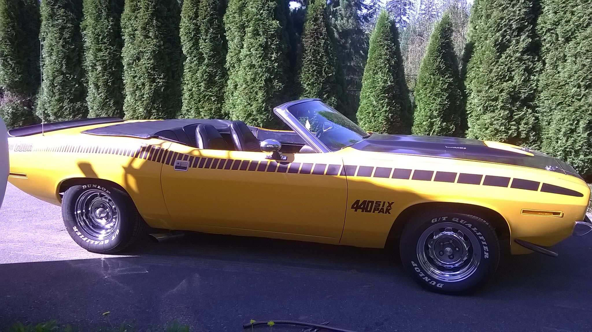

A little more details. Year door sticker motor and trans #.
car has gone threw alot of changes, nothing is original was 318 904 7 1/4 now 440-6 727 8 3/4

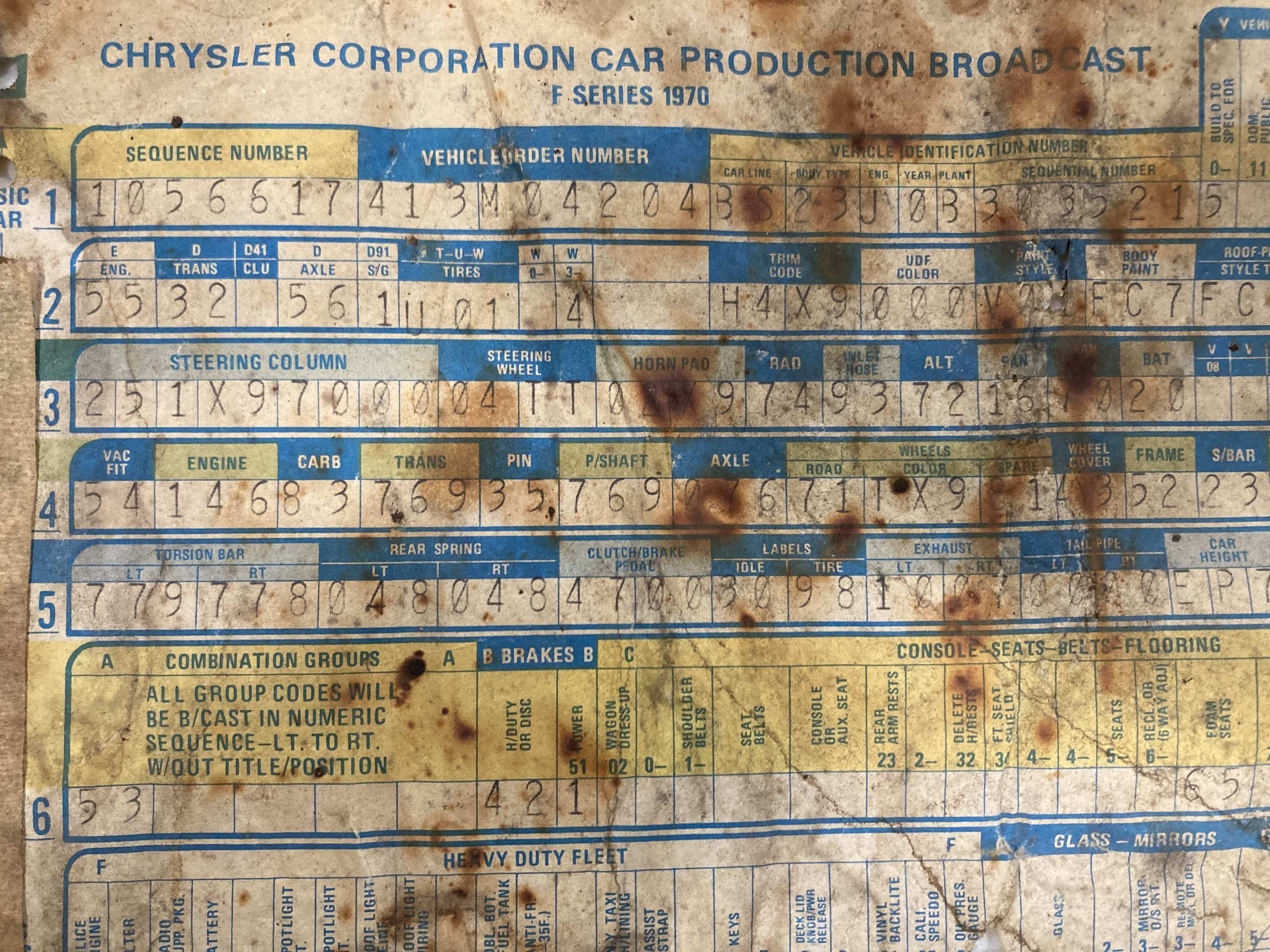

Without other information of the motor,transmission, door sticker and others to compere. The numbers on the other locations might show which is correct and what is more than likely a mistake or something was replaced. Just a fluke it's a hundred off. The broadcast sheet and window sticker I'm sure are also long gone.
I have seen on the broadcast sheet. The Vin and SO # a close match and maybe it was miss read when making vin stamping. Example SO# 1234560 extra place in SO#, vin# 123556. Example below of SO and VIN numbers not matching or off by one. Yours might have been off by one.
Bottom line there is a title for it and your not playing it off as something else being original.
