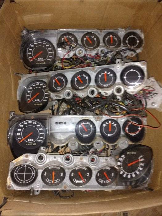

These are the 4 I have left complete with harnesses. The one at the bottom is correct for ‘70 Challenger but should still work for you.

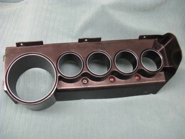

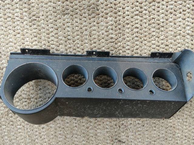

@DetMatt1 My computer went down and I can't post pics to show the 70 Challenger difference. In 70 two cast cluster housings were used for non rallye gauges; one for the Cuda and Challenger with woodgrain or black. This is the squared off bezel. The pods at the bottom of the housing that hold the warning lights stick out to cause a tunnel where they meet the bezel. The 70 Challenger ribbed non rallye cluster uses a cast housing where the warning light pods are almost even with the base of the housing. This is because of the shape of the ribbed bezel. The squared off bezel will fit the ribbed cast frame, but it will not seal the lights from bleeding out into the cluster when they are on.

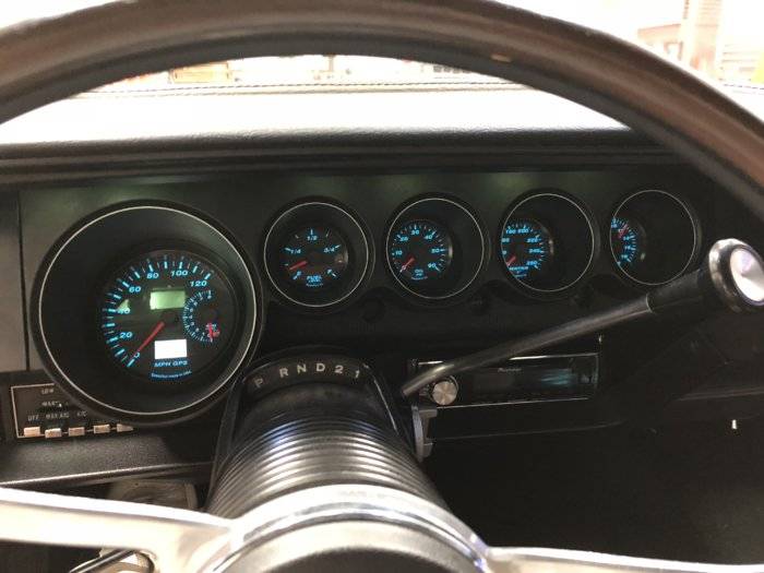

Or you could use this opportunity to install new custom gauges. I did these for about 750 using my standard gauge cluster and lens. Also uses GPS speedometer so no need to worry about gear and tire combos. Just a suggestion.
Jimmyspeed59
Jun 2, 2017
67
29
That was on my 70 challenger but you can do the same thing on your Cuda.
Jimmyspeed59
Jun 2, 2017
67
29

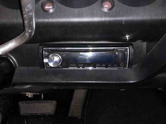

The radio is a pioneer DEH-X6810BT very inexpensive and easy to install without hacking any of the dash or trim parts. I only had to cut the trim piece that came with the radio because it interfered with the stock trim. The gauges I got from SPEEDHUT. They custom make the gauges with any color you want. Check out their website the possibilities are endless. I posted a video on you tube on how I used a stock standard cluster to do this. Hope this helps.
