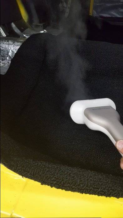

Got out the steamer to start installing the new carpet (which is quickly becoming a PITA) and am beginning the process of installing all new glass (another PITA.) Still smiling though!!

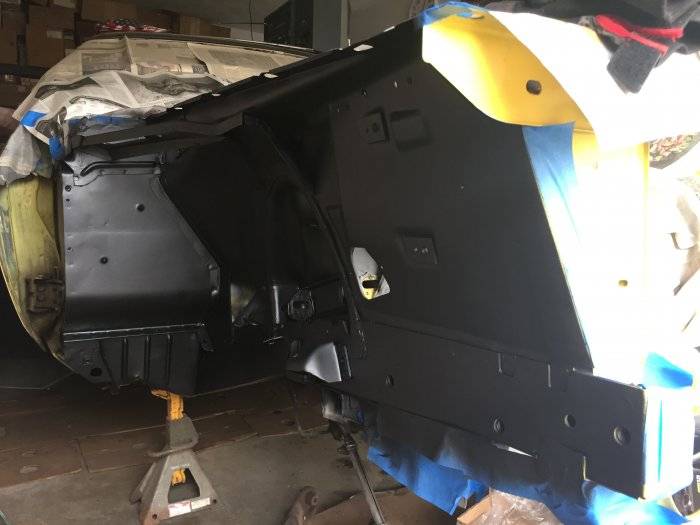

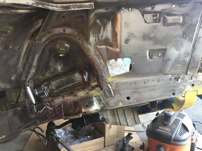

Continuing to work on cleaning up the wheel wells and inner fenders in preparing for paint.
Stripped to metal, rustproofed, epoxy primed, and ready for painting.
Eastwood products do a good job!

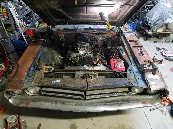

Finishing the engine swap I started last weekend... The slant, God bless it, is going to get me killed on the high speed 2 lane desert roads I commute on. I grabbed a 5.9 out fo a Durango, Eddie RPM airgap Magnum intake, used Eddie 1405 carb, used trans from a friend...
It's in, bolted up, and getting close. I just need to adapt the throttle linkage bracket to the magnum bolt pattern and wait for my coil pigtail to show up and I should be good to go by the end of this coming weekend.

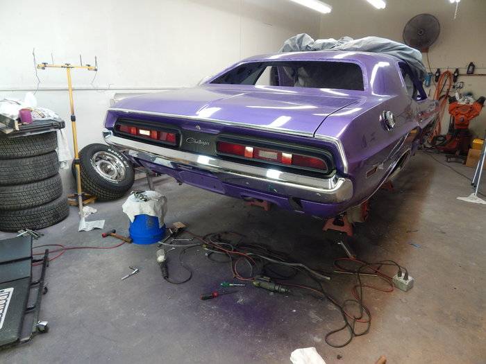

Put in the new gas tank and sending unit and new fuel line. Put on new AMD rear bumper, refurbished the tail lights and housing, and installed new AMD rear vallance. Brake lines and brakes this weekend
